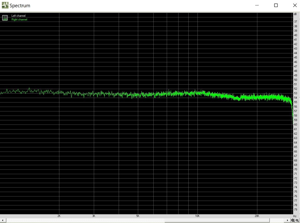

It is around 1mA split between each NPN in the LM394. There is no noise that isn't overwhelmed by vinyl artifacts. A bigger issue is that applying MM signals across the bases without feedback can generate unacceptable non-linearities. Yet because harmonics are generated in a pre-RIAA network they become attenuated in a downward slope when RIAA correction is applied, the higher harmonics being down substantially. In contrast IM products can be amplified by RIAA correction. As an example if acoustic notes are played close together at a higher frequency the difference frequency generated by the existence of a non-linearity becomes amplified by RIAA, being at a higher gain at lower frequencies.If the input impedance is that low, the tail current must be far above the noise optimum.
It seems that in order to reduce IM distortion artifacts, or DC shifting as a result of amplitude modulation of single frequencies, pre-RIAA networks should have good symmetry to limit the square law non-linearities. Hence the differential amplifier.
Yes. You can add emitter degeneration resistors to increase the input impedance.
There can be some benefit to that, although the network is a battery powered device. Emitter degeneration would reduce gain, hence signal amplitude to the subsequent would be lowered, as potentially to diminish the signal to noise ratio of the following network.

There is nothing wrong with what you did, but you should carefully tune the input impedance to ca 47KIt is around 1mA split between each NPN in the LM394. There is no noise that isn't overwhelmed by vinyl artifacts. A bigger issue is that applying MM signals across the bases without feedback can generate unacceptable non-linearities. Yet because harmonics are generated in a pre-RIAA network they become attenuated in a downward slope when RIAA correction is applied, the higher harmonics being down substantially. In contrast IM products can be amplified by RIAA correction. As an example if acoustic notes are played close together at a higher frequency the difference frequency generated by the existence of a non-linearity becomes amplified by RIAA, being at a higher gain at lower frequencies.
This can easily be done with a 100K pot in series with a LF generator connected to your amps input.
Start with R zero ohm. and gradually increase its value. At the point where the amps output is halved, the pot has the same value as your input impedance.
This way you can tune the 47K resistor to a value where the combined input impedance is 47K.

Sounds good Hans. I was previously testing a faulty device. In rechecking another LM394 in the manner you suggest it turned out a 70K resistance was required in series with the input to halve the output (this value was more in line with what Marcel indicated). This means an input resistor to ground of about 143K is required in parallel to create 47K. It turns out that the input was currently at about 28K or close to 1/2 the value it ought to have been. Do you think this lower value is significant Hans?There is nothing wrong with what you did, but you should carefully tune the input impedance to ca 47K

This suggests lowering the tail current, something that was and still is being considered, though gain is lowered. I like the higher output signal levels from the device I am calling the GyroHead. It is a battery powered device located beside the turntable with Interconnects to a current input mode RIAA amplifier. Using higher levels the intent is to minimize pickup effects and increase the signal/noise ratio (although lowering tail currents can dramatically increases battery life).Assuming RIAA and A-weighting and a 500 mH cartridge, the noise optimum is a tail current of about 140 uA, but it is a very broad optimum.

Looks like you have already answered my question Hans. I will lower the current and adjust for 47K total.Suppose 1mA, then the differential input impedance could easily be ca 50K, making the total load some 24k.
