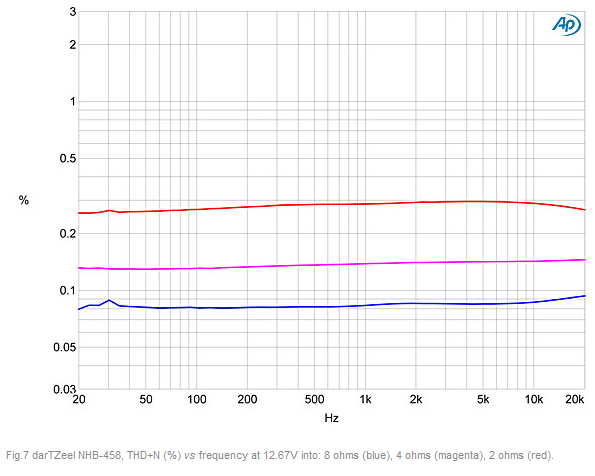

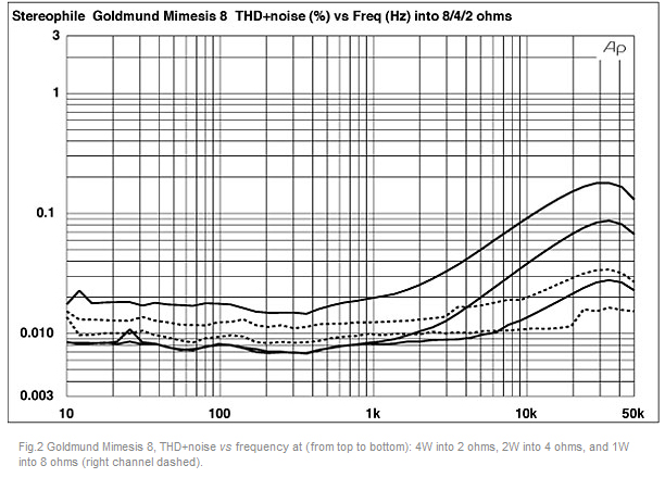

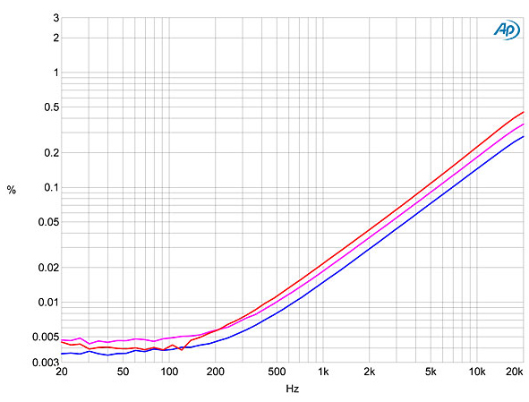

Some graphs from popular amplifiers for reference- Stereophile measurements. All amps are classAB :
BTW I guess most of members who are interested in amplifier design know some details of construction of amps mentioned...
So, any conclusions? 🙂
Its interesting - the order you placed the graphs: based on ONLY that one test data, I would prefer them in the same order, left to right.
THx-RNMarsh

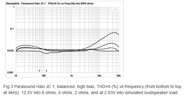

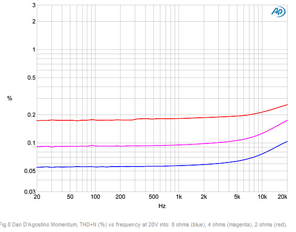

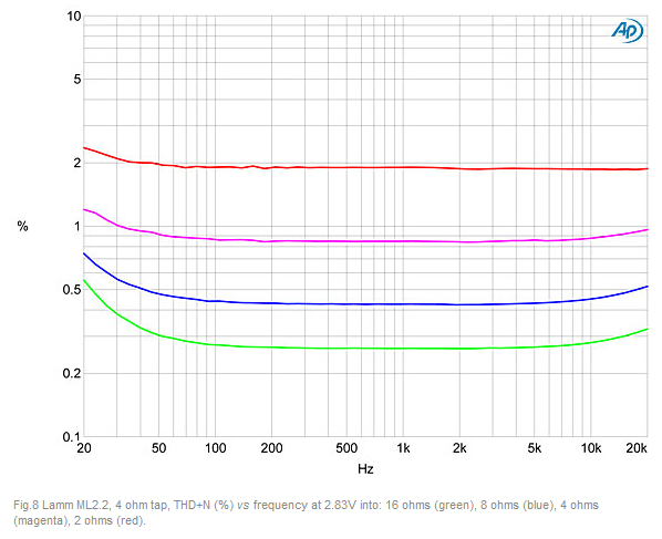

Now thd vs f graph for the same amplifiers from Stereophile. Look what a great job D`Agostino and Dartzeel did with low feedback designs 😉 :
A wouldn`t like a graph from amp No.2 is from my amplifier...

That's what I said. if you increase the lf distortion on purpose or by incompetent design, the curve will become flat, but it's a bad amp!
Flat THD vs F is only good if it is very low at all F's !
Jan
Jan, I don`t think the LF distortion is raised on purpose, or Vladimir is incompetent designer, and you know that. It`s a tube amp and 0,5% for a NGFB tube amp at 8 Ohms is not bad result at all.
Do you really think that it`s all about low distortion?? That would be to easy and everybody would make best amplifiers....but I think you know that also...
