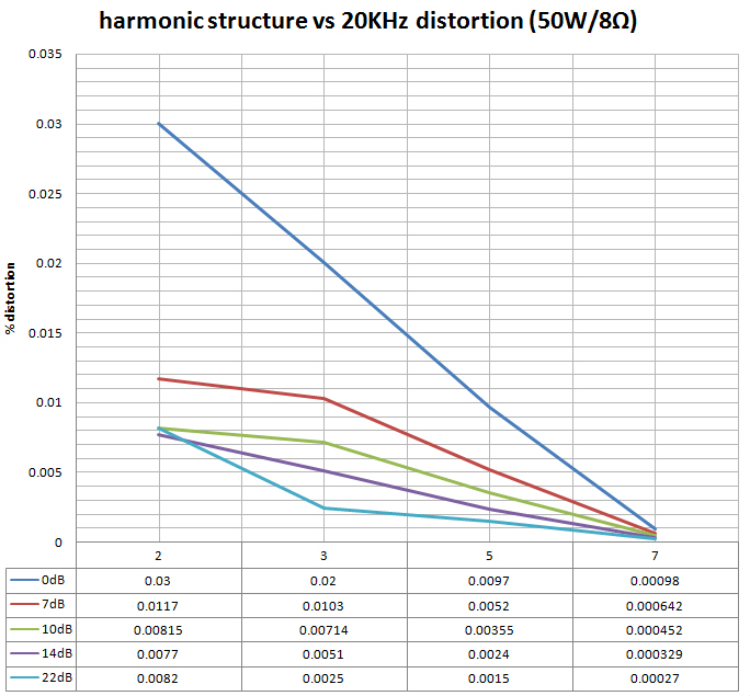

I have made the amplifier with separate voltage amp stage and power buffer. I don`t have measurement tools so I simulated distortion vs global NFB.
Input voltage amplifier has local 6dB feedback loop and it is constant. Only global feedback loop around buffer is changed for different data:
On the graph X axis is 2nd, 3rd, 5th and 7th harmonic. Fundamental is 20KHz.
On the graph Y axis is distortion %.
Separate colors are for 0dB, 7dB, 12dB, 14dB and 22dB of GNFB.
Attachment is block schematic and chart data, it might be interesting to someone :)
Input stage is complementary jfet/bjt and the power buffer is a all bjt triple EF.
P.S. Interesting thing is there is no 5th and 7th harmonic rise with raising feedback factor as some are advocating...
If your amp is reasonably linear to begin with, you won't see any re-entrant distortion (or very little of it).
The original article that showed it was on a single FET stage, which is nonlinear as hell.
Jan

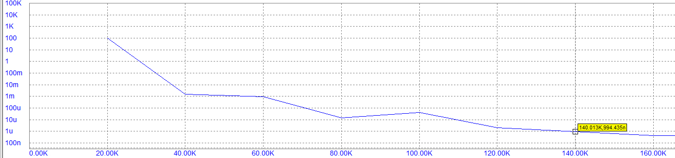

I know the article I just wanted to check it...
It is linear to my best efforts.
This is the harmonic distribution at 1W/8 Ohms with 20KHz fundamental :D

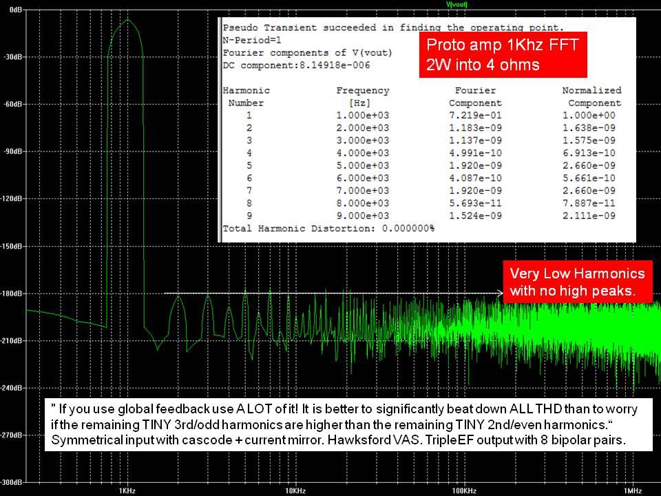

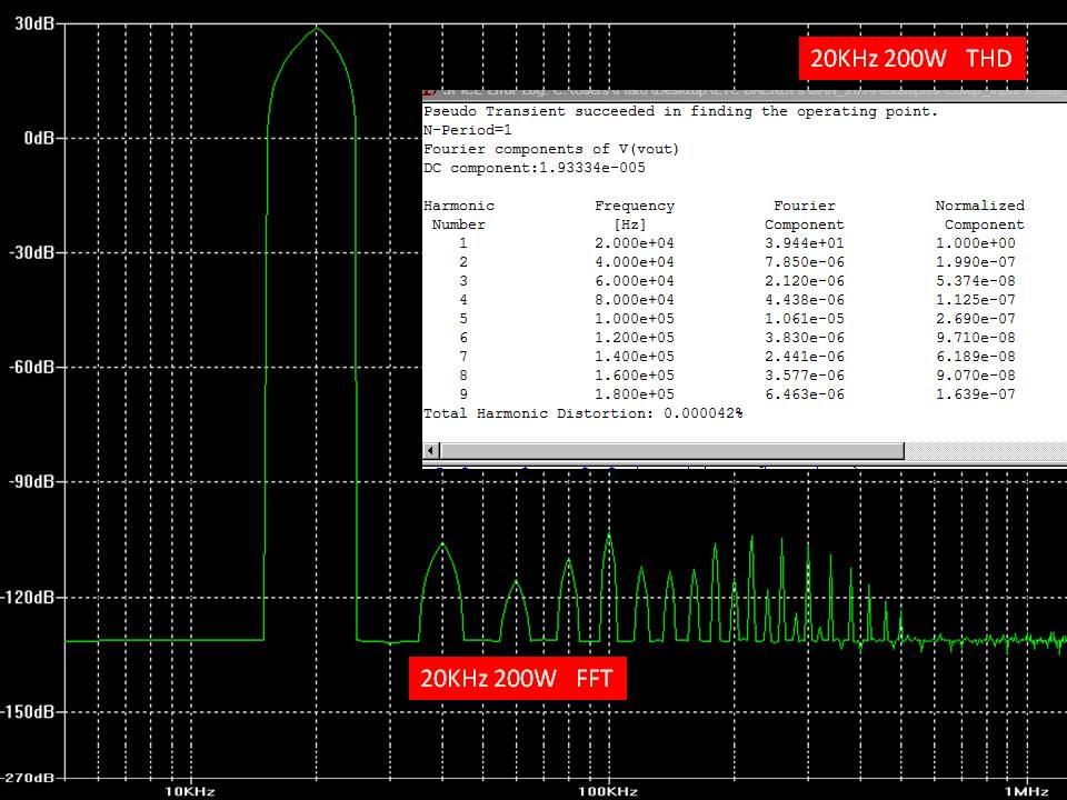

---ONE SCHOOL OF AMPLIFIER DESIGN---
"If you use global feedback use A LOT of it!
It is better to significantly beat down ALL THD than to worry if the remaining TINY 3rd/odd harmonics are higher than the remaining TINY 2nd/even harmonics.“
Some early Japanese power amps followed this philosophy and had poor subjective reviews. Perhaps the shape of the clipping waveform and clipping recovery artifacts are also important to study. Perhaps the distortion profile when the speaker load dramatically changes: like resistance drop; like inductance increase; like LRC resonances in the crossover; like dampening factor; etc... are also important to study.
As confirmed in simulation, with higher feedback, 2nd and 3rd harmonics are getting close to a 5th and 7th level, even lower then 5th and 7th and I think that don`t sounds right, even if they are very low (at least to my ears).
From my listening experience the Hiraga`s harmonic pattern theory is right on the spot.
Also a very important thing is flat frequency vs distortion characteristics of the amp, at least to 20KHz. (most amps have rise in distortion from about 1KHz to higher frequencies).
So my conclusion is a modest feedback and Hiraga`s harmonic pattern with progressively decreasing harmonic amplitudes.
THD vs F graph is next...

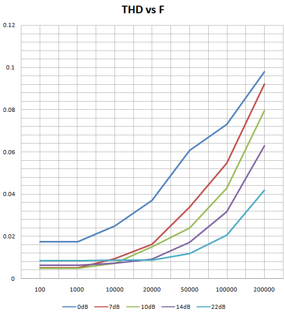

THD vs F graph (100Hz - 200KHz) and corrected vrsion of the first graph :
As you can see open loop amp (0dB feedback line) on the right graph is a ideal case of Hiraga`s philosophy but on the left graph highest (in fact modest) feedback line for 22dB feedback is the most ideal - a straight line from 100Hz to 20KHz. What is right? :)

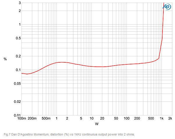

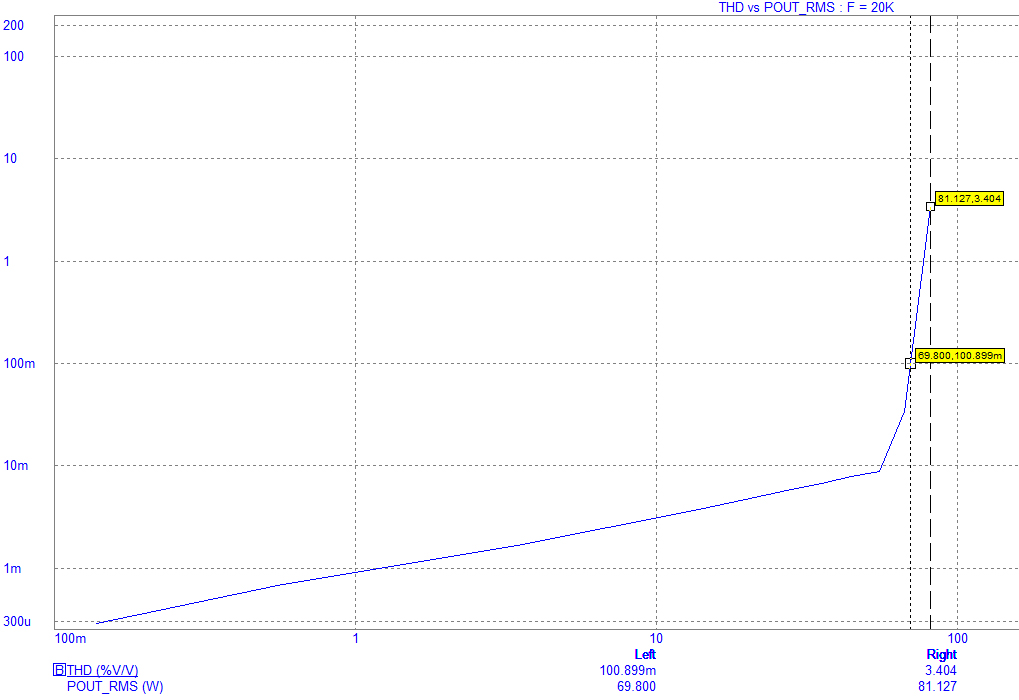

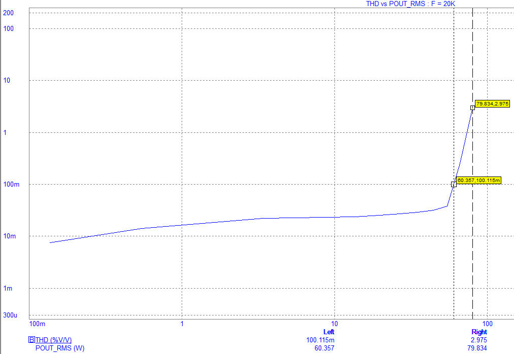

And something you can rarely see in class AB amps (in the Stereophile measurements):
THD vs P graphs for 0dB GNFB (open loop) and for 22dB GNFB are no roller coaster type, THD is linearly rising...

I thought it is easier to understand like this, the 2nd on the 1W/8 Ohms graph is about 0.0015%.
Well I'd settle also for a % scale; both dB and % are used in audio. The graph I mentioned had V and mV, which is unusual, takes an effort to convert to either dB or % and invites errors. I mean, whoever puts up the graph WANTS us to get it right, right?
BTW There's a reason why generally Y-scales are either in dB or in % but then log. It's because the way we experience it is also roughly logarithmic scaled so a dB or log % scale corresponds better to our perception.
The thing is, that the harmonic structure changes with feedback depend a lot on the linearity of the amp before you apply feedback.
I agree that a nice decreasing spectrum probably is best, but with some amps that results from moderate feedback, while others need much more.
So there is no direct link between how much feedback is used and the thd spectrum decay.
Jan

I did the graph in Excel, quickly just to show the point...
Jan what do you think of other two things I mentioned:
1. THD vs F - a flat line at least to 20KHz.
2. THD vs Power linear increase of thd with power increasing.
Anyone else did such simulation/listening experiments??
Flat THD vs F would be nice, but some people get that by increasing the THD at low frequency - that's not good of course.
I believe if you have two amps with same THD at say 10kHz, but one has lower at 1kHz, that one is better even when the THD vs F is not flat.
For the THD vs P it should stay flat until it runs out of steam, then do a soft clip.
Jan

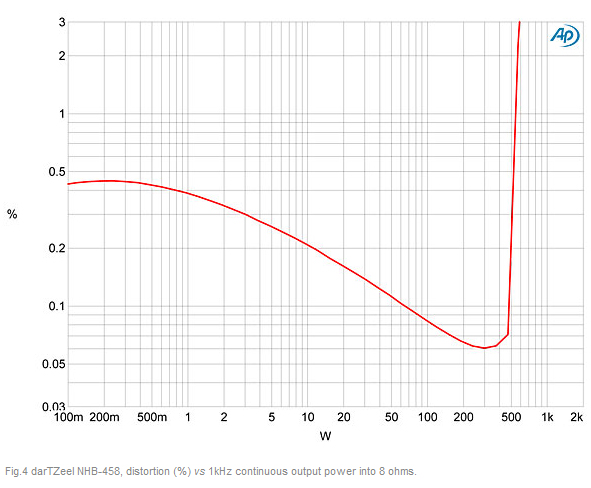

Some graphs from popular amplifiers for reference- Stereophile measurements. All amps are classAB :
BTW I guess most of members who are interested in amplifier design know some details of construction of amps mentioned...
So, any conclusions? :)
