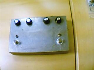

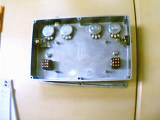

DPDT footswitch is installed and wired per previous diagram with in/out 1/4'' jacks. 9VDC adaptor power jack mounted and wired, not using battery connector on this build. FYI on most commercial 2.1 mm jacks for powering pedals, the polarity is negative on pin and positive on barrel. Some advice: use the insulated type jack that won't short to the case, as the case is referenced to negative. Double check to make sure your adaptor is polarized correctly before power up.
hi shanx, newb here just blowing thru some threads to get a feel for the forum and this was the first i landed on...lucky you! 😉
if you're gonna run this with other pedals in the future, particularly on stage, you may run into some problems with your mains wiring...get a lot of noise and garbage...particularly as dirt pedals are usually high gain and first in line.
my humble suggestion would be to add a simple network to your power supply...you can wire it right to the 2.1mm power jack if need be...
use an 1n400X diode, with the band pointing to B+ in parallel with a 100-470u cap wired the same way...you can have the band on the cap denoting the negative side go directly to the negative terminal, and the positive to the positive terminal of the jack if need be. this will help filter mains noise and hum out...if need be, a small resistor in series (100-330r) with the b+ can also help if needed.
i find without the extra stage of filtering on power supplies in guitar pedals, particularly dirt pedals, that the pedal can be subject to a lot of unwanted and unnecessary noise. this can help.
that said, looks like a cool design, well done mate!

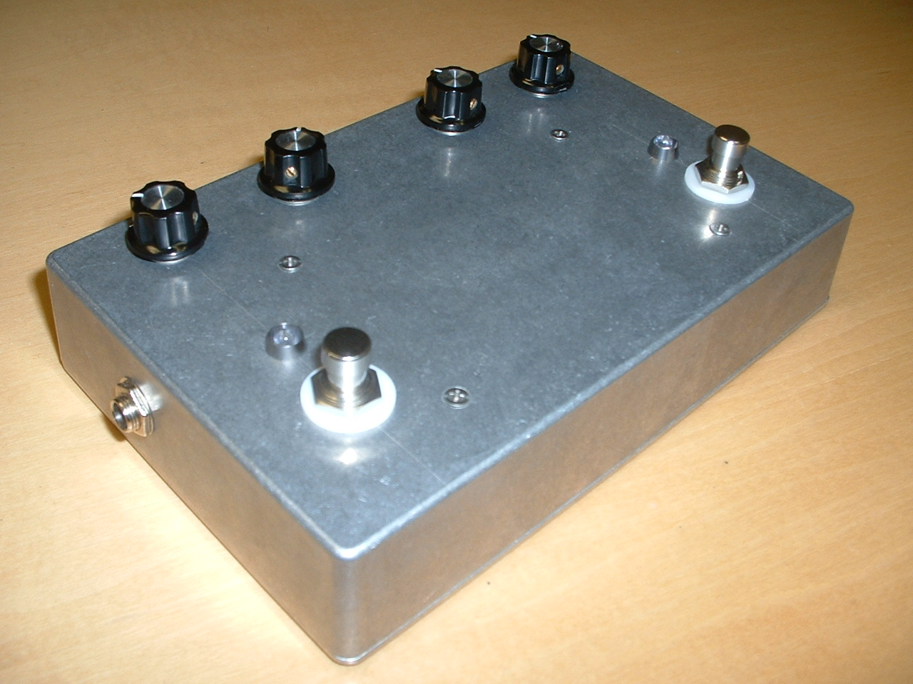

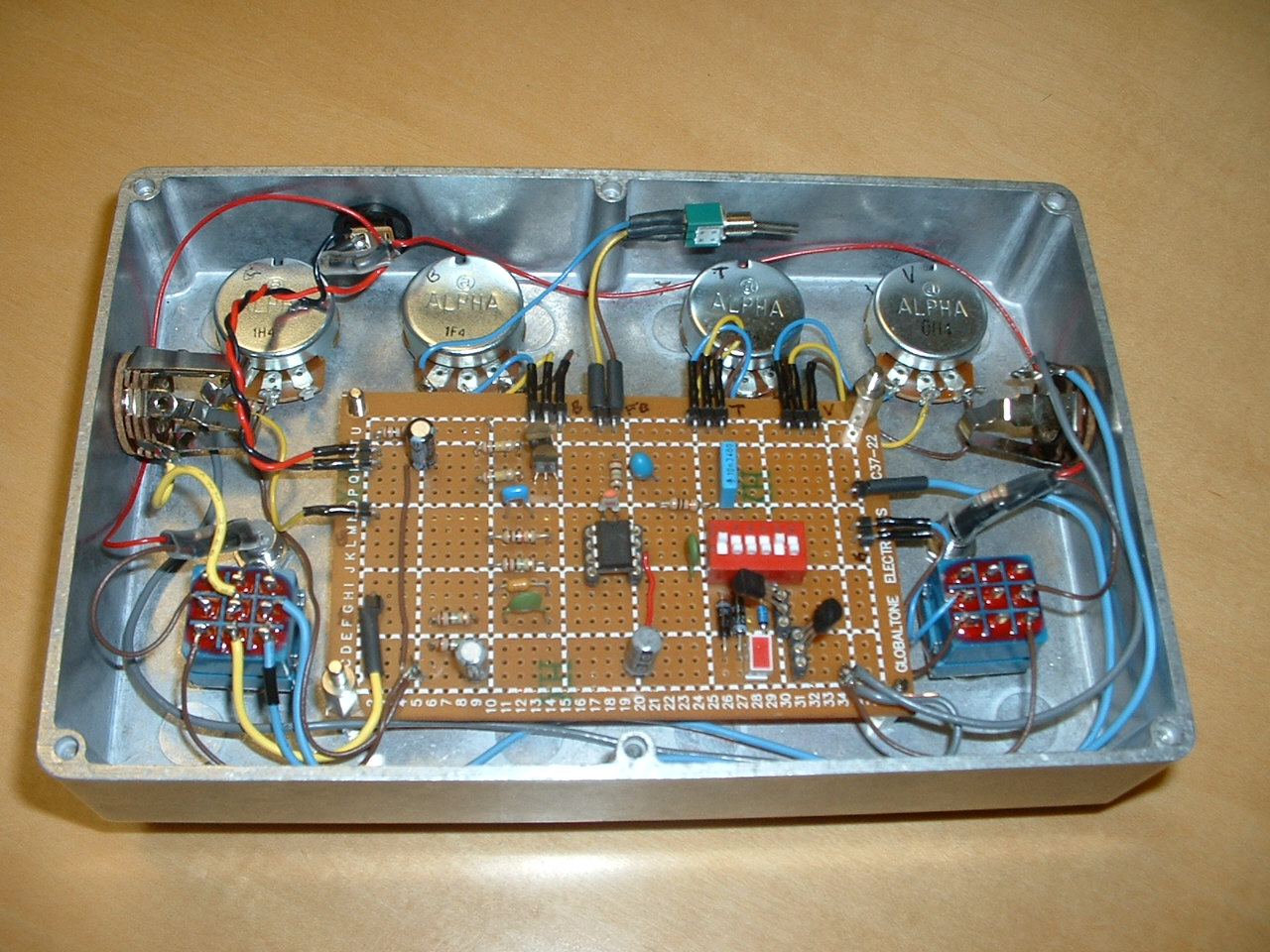

2nd build pics
Here are some better pics of the 2nd build. I tried to keep the wiring as neat as I could on this one. Going to prime the case and my friend will apply the paint and clear coats.
All the point to point wiring was a lot of work. If I get asked to do more I will have to get some circuit boards done. This one still has some room left if he wants me to add anything else.
Hi Shanx,
Looking good. Nice proportions for stompability.
If you're going to paint it, maybe just deepen the countersinks a little bit. I have no magic solution to getting that one right first time, just give it my full attention and work with one of the screws I'll be using in my left hand, trying the head for fit upside down, so as not to have to poke the threaded portion through. If I don't make it easy to try it often.....
Looks very reconfigurable too, I like the secret toggle switch. Those little DIP switches are a type of slider switch, so a bit prone to oxidation in the long term. One alternative is to use computer style jumpers, three pins per jumper, so unused ones are still securely on two pins.
The metal LED bezels look up to the job too, think I'll look out for some of those, have had plastic collar mounted ones pushed in slightly in use.
Very tidy. I hope your friend appreciates your hard work.

Looking very good, have you got a schematic? and is that a switch i see floating round niside the chasis?
Hi SimonB and Razorrick
I appreciate the feedback alot. I did deepen the countersinks a bit before shooting the box with 2 coats etching primer. My friend builds guitars and he will probably fill in the screw supports before he sprays final coats of paint. He is setup to spray nitro lacquer finishes (he does beautiful work!) I did some retro graphics and they will get applied before clear coat. He is putting on chrome telecaster knobs on the controls.
He is appreciative and he has done a lot of great service work for me on my guitars.
You guys on DIY have done some really great work..so I was inspired to neaten up my wiring for this second build. My first build on this thread basically a working proto to play with.
The basic schematic for this is at the beginning of the thread. For the postclip part, I just installed different diode combinations and socket for mosfets wired as diodes (G-S tied together. The DIP switch replaced the test diode switch. Simon, the jumper idea is cool..maybe on next one..because I need to get this one delivered.
Alas, the stealth switch is now placed up top..I kinda like it buried in the box too!
That switch is to add a boost and is just playing with the NFB resistance.
I will post some sound clips shortly
