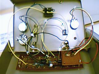

Here is a pic of the softclip board installed in the chassis, just need to finish wiring into the switch and NFB. Have in mind to mate it to the IC socket (main board) on the right, so I can remove the softclip board easily and add or change components in future. Tie wrapped some of the wires to clean it up a bit. That's it for this week..
The softclip board is wired in to the switch and NFB circuit. Double checked the switching function to make sure it's in there correctly..starting to deal with a few wires now (and still looking at putting in the tone control). Looks like it is good to go..will fire it up tonight with fingers crossed and see how it sounds.
Tested out the softclip circuit last night, and it sounds good. It covers a more subtle range of distortion than the post op-amp clip circuits. With the bias in mid position it is a minimal distortion and going to either full CCW or CW brings it up to a more ''edgy'' distortion, almost to the post op-amp clip level with LED..the tone being pretty similar. Makes sense that the bias wiper position going to full CCW or CW would give a more asymmetric sound like the LED setting. And I like the fact that you can adjust anywhere in between, which was not exactly the case with the way the post op-amp LED clip works, although you get a similar result playing with the gain.
With the bias pot either going from Mid position to CCW or from mid position to CW, the ranges of distortion level /tone are pretty much the same. Because of that, I am going to try a cap across the bias wiper to one side of the bias pot. May give some tonal emphasis to the soft clip circuit depending on wiper position , but I am not certain of that yet.

Tone circuit installed
Finished wiring in the preliminary Tone control. Got a 100K at the surplus store. Looked OK (was a $1.50) but we'll see, as the wiper action feels a bit rough..alright for the test.0.01uF mylar for Cx- Firing it up again tonight, and get back with results.

Final test of the Tone circuit
I played through the pedal last night. The tone circuit is working correctly, and I am glad I added one. Because this pedal has a lot of options for gain and clipping type, it really helps to be able to ''tune-in'' and get a good workable range of sounds. The boost / rolloff frequency is about where I expected, and I may increase the value to get a bit lower corner frequency. IMO tone is a matter of subjective taste, so I am sure that many filter network arrangements could work, but for this pedal I figured the simpler the better.
Initial build 99% complete
The distortion pedal as pretty much built up to the modded schematic that I posted. I still have to solder in the 10 pF in the NFB loop, just to minimize any potential ringing at high gain setting. As this is a working prototype now, I want to finish off a few details so that is user-friendly at jams and gigs.
The softclip circuit really suits my taste and style of playing...and a guitarist friend of mine is already asking me to build up one for him.
I will post some decent photos of the finished pedal, once I get the last few details completed.
Overall I am glad I finally got this build to where it is, with all the mods in place, it was worth the time.🙂
