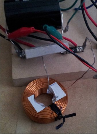

I removed the 1.8mH coil from the board to isolate from everything else. Clipped it between the amp and woofers w/ alligator clips. No distortion.
So then I soldered the cap to the coil, and clipped both into the woofer circuit. Still no distortion.
Soldered them both back to the board, but not tied down, connected the woofers via the terminals on the board and tested again. Still no distortion.

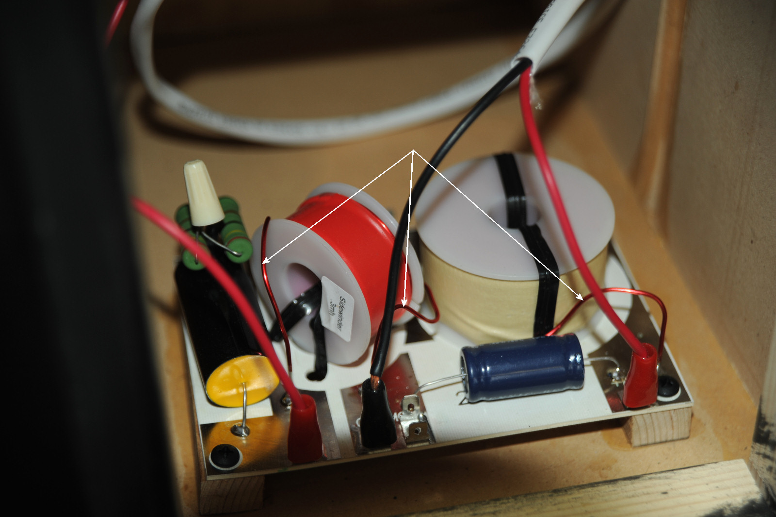

Then I tied the coil down with the wire twist ties I'd been using (see photo comment #23). Distortion is back!
Removed the twist ties, distortion is gone again. Removed the twist ties from the coils on the right speaker xover, tested it. No more distortion there, either.
LESSON: Don't secure coils to a PCB board with wire twist ties!
I assume the coil induces a field in the wire tie, which is then induced to the board trace where the tie passes through.
Anyway, THD is now about -47 db, or < 0.5%. And they sound great; very smooth. Plot below has no smoothing:

Well there you go!! Get some nylon cable ties 🙂 I guess that the twist ties have a ferric wire in them and that is interacting with the coil. Glad you tracked it down!

Then I tied the coil down with the wire twist ties I'd been using (see photo comment #23). Distortion is back! Removed the twist ties, distortion is gone again.
Aah! I see the twist ties in your photo now...funny how our minds see what they want to...a black nylon ziptie.
BTW, congrats on the methodical testing and finding the source. :up:

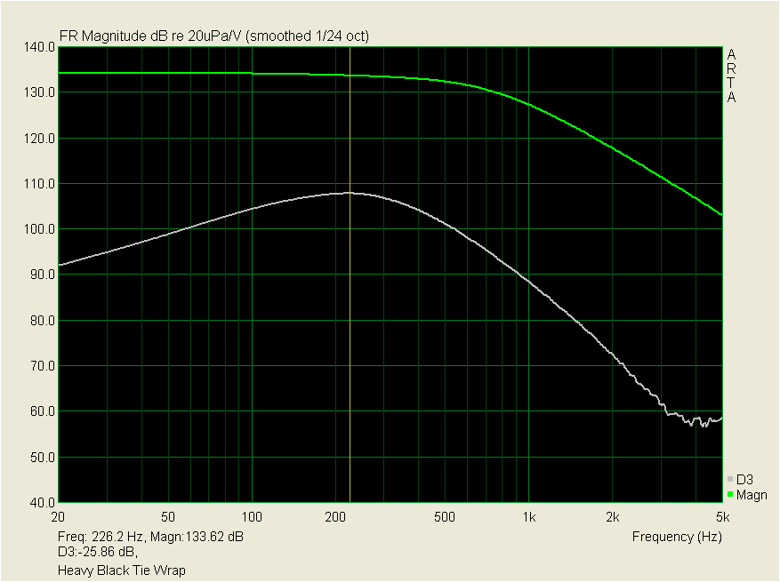

I have encountered similar distortion with poor core material, although not to this degree.

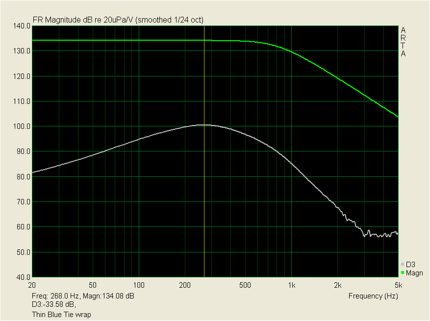

I figured a quick test was in ordered: Grabbed a 1mH air core from the parts box along with a 47uF cap and 4 ohm load resistor.
The test measured frequency response and 3rd harmonic across the 4 ohm load resistor.
Attachment 1: test setup
Attachment 2: reference with no tie wrap around the inductor
Attachment 3: thin blue tie wrap around the inductor (~2% distortion)
Attachment 4: heavy black tie wrap around the inductor (~5% distortion)
It seems that tie wraps either make for pretty poor core material or they are just saturating due to the very small "core" area.
Note also that the tie wrap is increasing the inductance a small amount and adding some damping due to core loss effects.

I figured a quick test was in ordered: Grabbed a 1mH air core from the parts box along with a 47uF cap and 4 ohm load resistor. . . . .
Yup --- that confirms it. My distortion was 9%, but I used 2 ties on the coil.

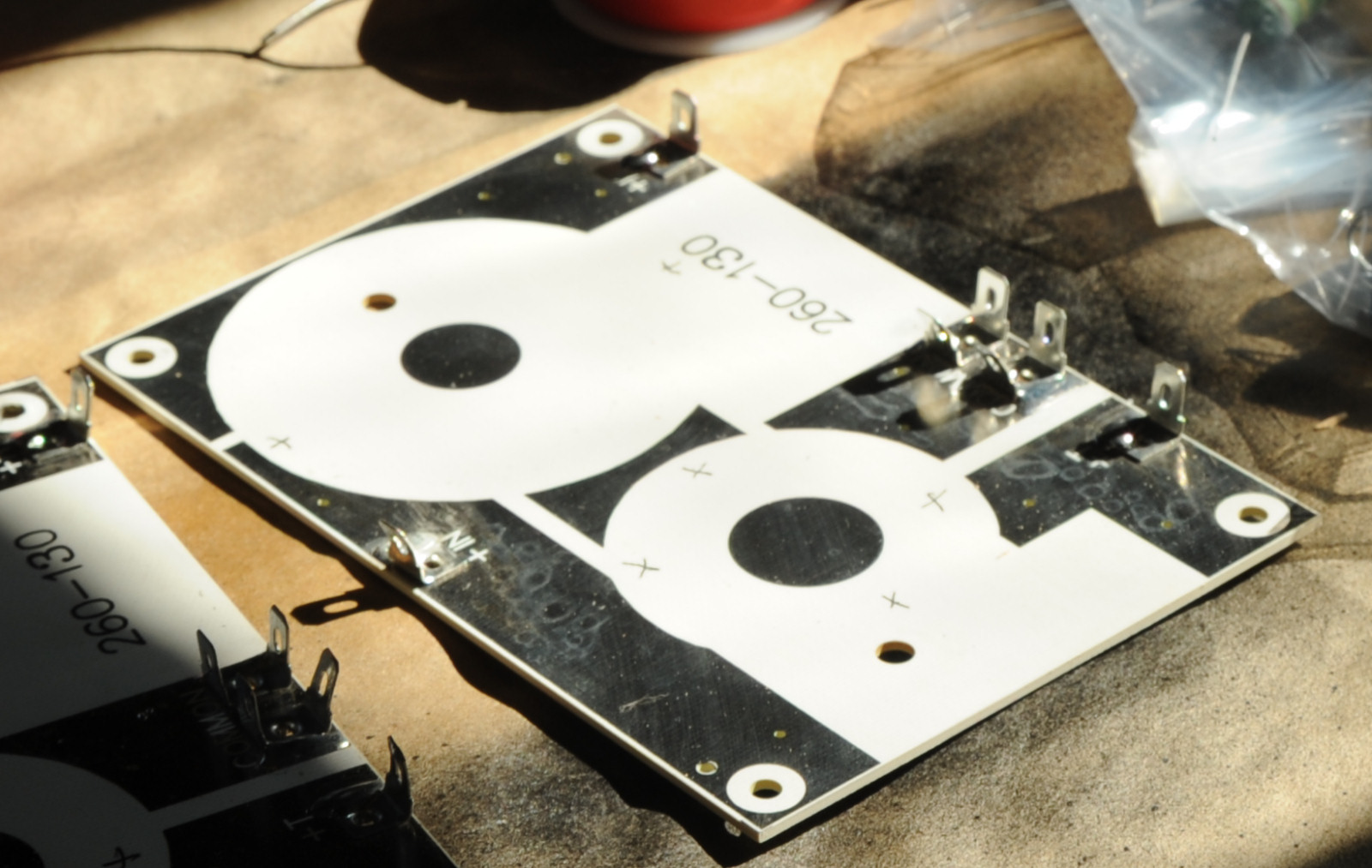

I'm also wondering about all the metal on that PCB board. Wondering if a bare plywood board with discrete wire connections might be safer.
Before I found the problem I ordered some lower DCR coils and poly caps to replace the electros. Though really don't need them now, might as well use them. Think I'll mount everything on a new homemade board.
