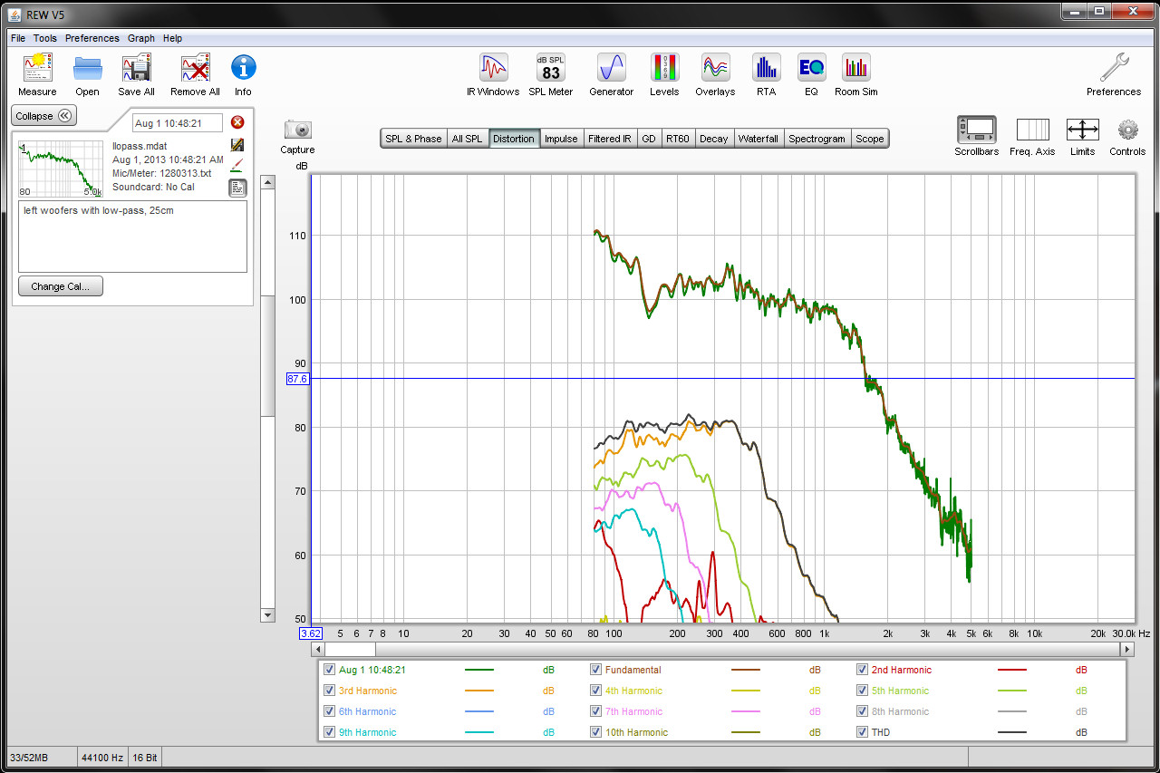

One more --- the woofers alone (no tweeter) via the low-pass crossover circuit.
Looks like the filter is doing its job (crossover at 1450Hz), but introducing a lot of distortion in the process.

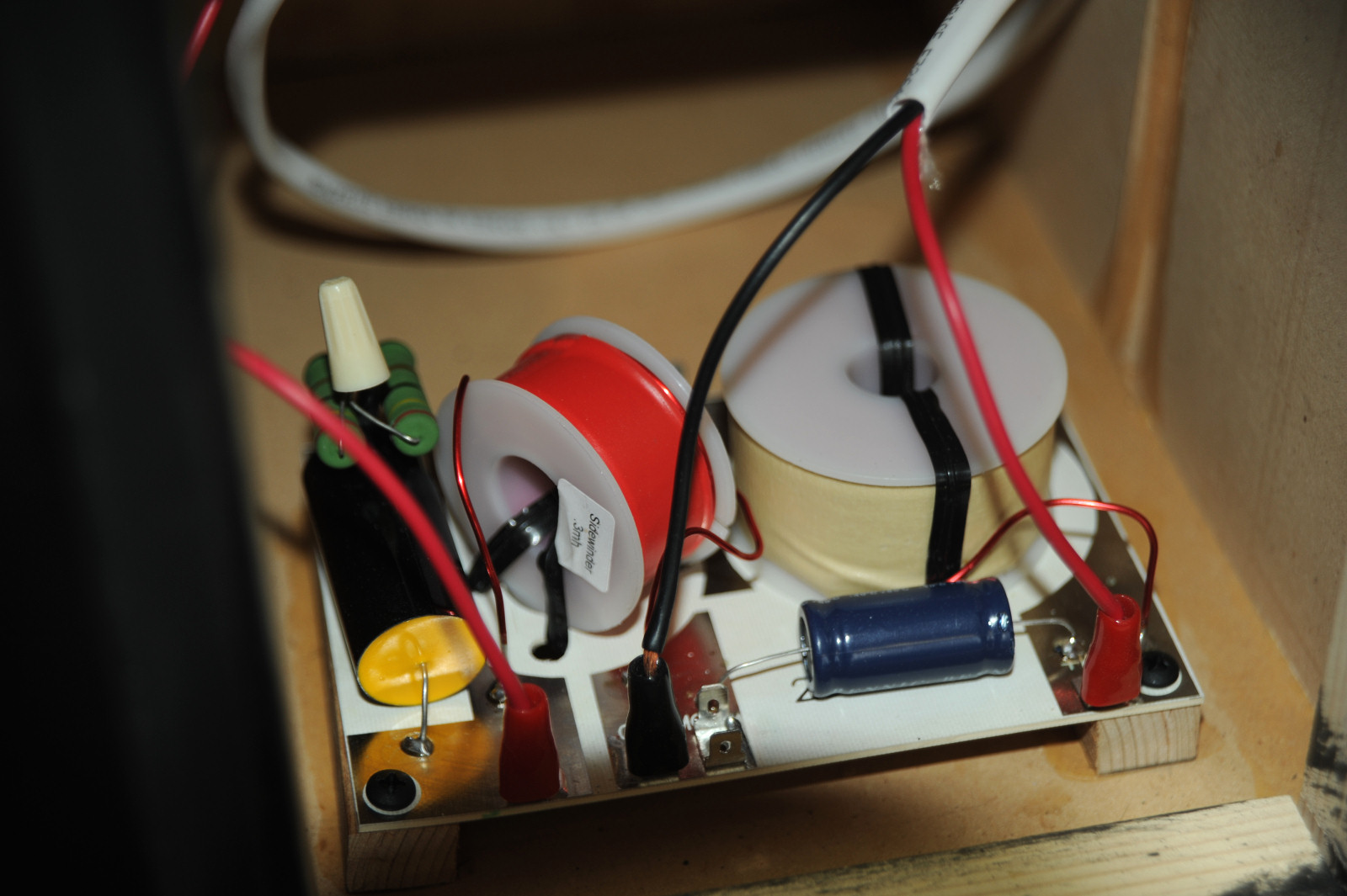

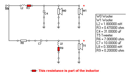

Was the tweeter crossover still wired up for this measurement? (ie did you just disconnect the tweeter)
If so, you might try measuring again with R6 or C7 removed to rule out problems due to inductive coupling feeding HF content from L8 into L2.
If this is the cause of the distortion, you should orient the inductors to minimize coupling as shown in Fig. 7 here:

They're already oriented optimally (I think). See photo above of board.
replace c4
Plots above are only for left speaker, but the right is nearly identical. Seems unlikely both C4 caps could be bad.

There will be a fair amount of coupling with coils oriented as shown in the photo.
Closely spaced air-cores need to be oriented nearly exactly at 90 degrees to avoid coupling.
OK. I'll move them around and see what happens. Small one will be easy to rotate. Could put everything on a longer board to increase distance too.
Rotated L8 so it's 90 degrees vertical and horizontal relative to L2. That also moved it about 3 cm further away.
No change in plot. Still < -20 db THD.
Definitely change the orientation of the vertical coil so that it is at 90 deg to the other one! See troels tests on coils --> Placement of coils in crossover networks.
For the electros, I would consider replacing them with polyprop film caps (what did zaph originally use?) If zaph used electros you may also need to add some series resistance. perhaps .1/2 ohm to 1 ohm. 30uF axon's are $6.95 from parts express https://www.partsconnexion.com/capacitor_film_axon.html 🙂 that's probably close enough, or you could add a 1uF in parallel..

Note that the resonant frequency of the cap and the coil is 673Hz. Try putting a 1 or two ohm resistor in series with the electro and see what the effect is.

"For the electros, I would consider replacing them with polyprop film caps (what did zaph originally use?)"
John spec'd the same caps and coils I'm using. I ordered the parts from his list.
Zaph|Audio - Bargain Aluminum MTM
"If zaph used electros you may also need to add some series resistance. perhaps .1/2 ohm to 1 ohm."
I don't understand, theoretically, how either a cap or coil could introduce THD into an AC signal. How would increasing resistance reduce it?
"30uF axon's are $6.95 from parts express . . ."
Are electros more prone to distortion than polys? Why?
"edit: just noticed the comment that the change in coil location made no difference 🙁"
Nope. Not even 1 db.
"Note that the resonant frequency of the cap and the coil is 673Hz."
How did you determine that? What should it be?
"Try putting a 1 or two ohm resistor in series with the electro and see what the effect is."
I can try that.

I just noticed that all the prominent distortion components are odd (ie 3rd, 5th, 7th, 9th).
Perhaps this indicates a current limiter/protection of some type in the amplifier being activated, flat-topping the signal. Is there a lower volume setting at which the distortion suddenly jumps to a lower level?
Yes. I remarked on that in the original post.
No (unless that threshhold level is very low). I tested at several different levels and mic gain settings. THD pattern is the same.
Also just tested using a different amp. Pattern is identical.
Hi Garry, The comment about film caps and electrolytic's is basically based on electro's being more prone to causing distortion, admittedly though the levels you are seeing, would indicate faulty caps (if indeed it is that caps that are causing it) rather than something inherent to electrolytics in general.
The main advantage of using film caps is that they tend not to degrade over time (which electrolytics do).
Electrolytic capacitors have a much higher ESR (effective series resistance) than film caps do. a 33uF electrolytic may have an ESR of around 1 ohm. A 33uF film cap may have an ESR of 0.01 ohms.
When you put a coil in series with a cap they can resonate (not desirable in a crossover as it can cause response peaking). Some resistance in series with the cap can damp this resonance (desirable). Electrolytics naturally have this resistance built in, but film caps do not (and therefore may need it added in the form of a series resistor).
It's probably unlikely it is a resonance issue as it seems to be pretty constant across the board below that freq rather than centered around it, but I thought I'd make the suggestion just in case.
