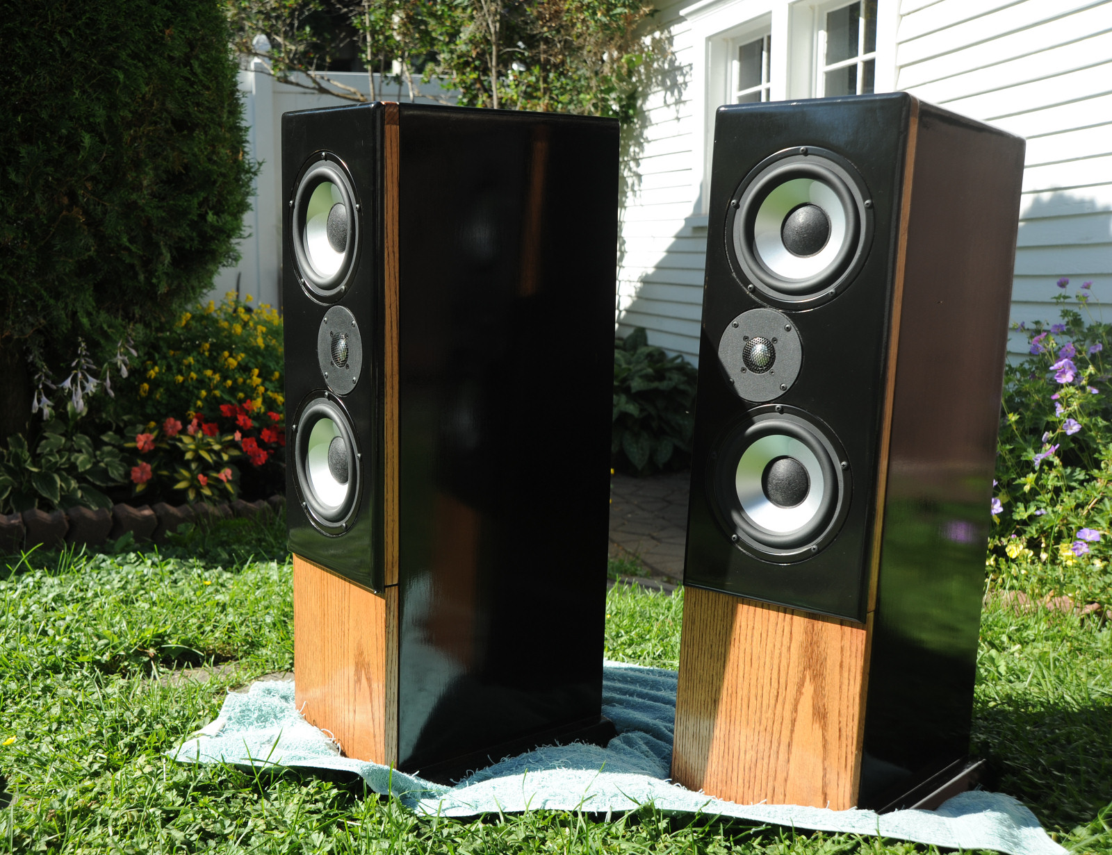

I just finished building a pair of MTMs, using Zaph Audio's "Bargain Aluminum MTM" design.
This system uses Dayton DA175-8 woofers and the SEAS 27TBFC/G tweeter.
Crossover is at 1450Hz.

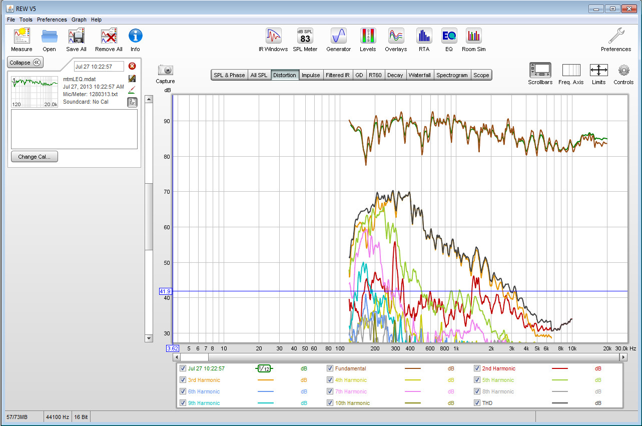

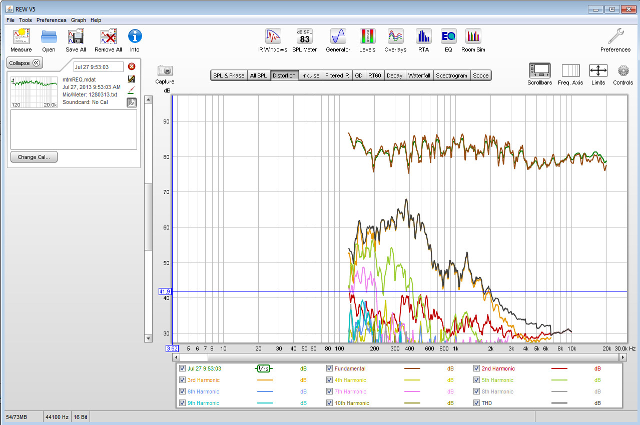

Testing with REW and a calibrated Dayton UMM-6 mic revealed high THD between 100 and 500Hz, tapering off above 500. Both speakers are similar. See plots (I included a shot of a measurement on another speaker I have, a Klipsch RF7-II, for comparison. It shows very low THD).
Notice that above the crossover point THD drops steeply. The tweeters, at least, seem to be on spec. Notice also that most of the distortion is odd-order. 2nd order is actually quite low.
Anyone have any idea what could be causing this distortion? Enclosure probs? Some wiring mistake in the crossover? Or are those woofers just crap? (Zaph's John Krutke thought highly of them).
Suggestions welcome!

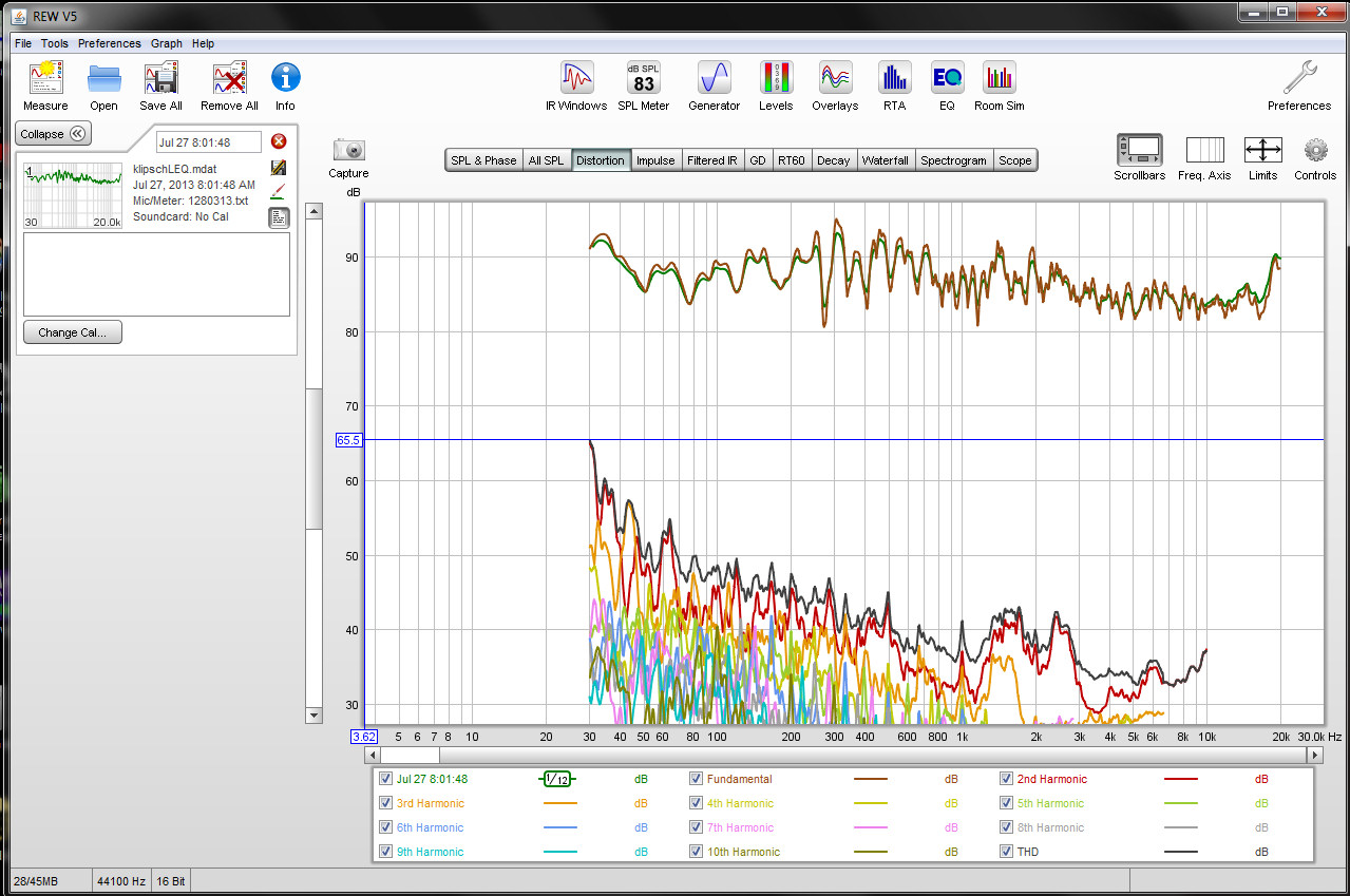

That's why I included the measurement from the Klipsch. Exact same setup (same amps, etc). It has to be in the speaker.

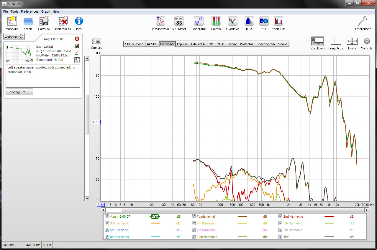

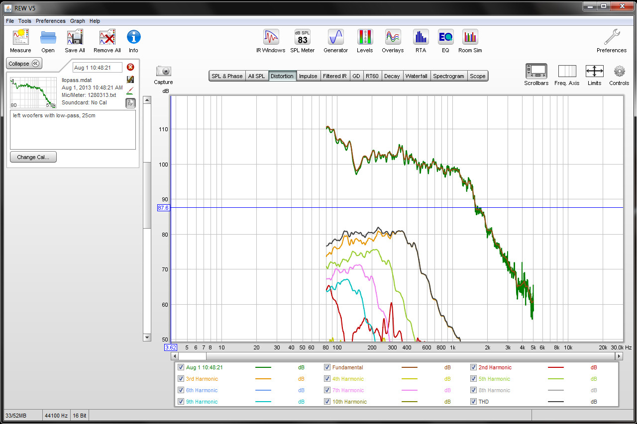

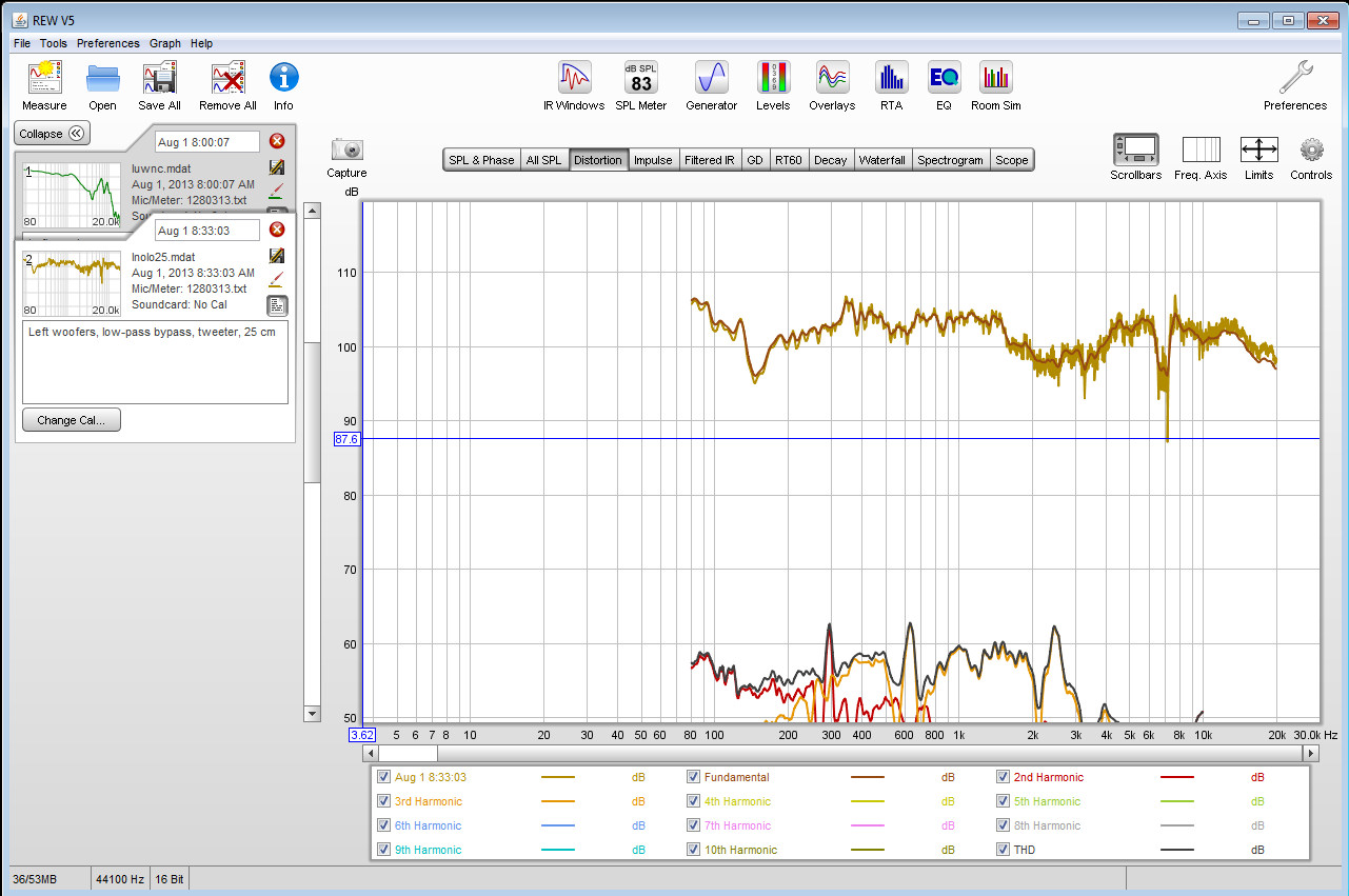

Following everyone's suggestions I tested the speakers w/o the tweeter or crossover (and the three drivers separately), then the system bypassing the low-pass portion of the crossover, then again with everything connected normally.
As you can see, those woofers are excellent. Smooth as can be, and THD -50db over most of their range. Photo is of the upper woofer on the left speaker, but the lower unit looks the same. Also tested the tweeter separately; it's just as good.

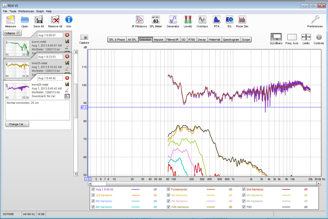

Next is the woofers with the low-pass section of the crossover bypassed, but with the tweeter connected via the high-pass circuit on the crossover. THD is still > 45 db.
Finally, the system with the entire crossover in the circuit. THD climbs to < 20 db below 400Hz.
Sure looks like the low-pass filter is introducing a lot of distortion. How can that happen?
