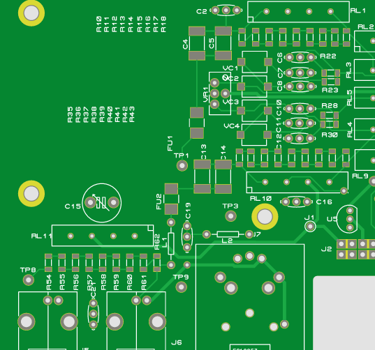

All right, I'll explain in more detail.
I have a power amplifier.
It uses 5 resistors in parallel as the upper NFB leg.
It feeds into a single resistor for the lower NFB leg.
Changing the 5 resistors in parallel to 5 in series reduces the effect of voltage coef to very much closer to that of the single resistor . Not there yet since I would need 27 resistors in series.
It is the same philosophy, try to get the voltage across any single resistor to match the voltage across the lower leg resistor.
If one can get the power dissipation in each resistor in the upper leg down to match that of the resistor in the lower leg, then the effect of tempco would also be reduced.
To get closer to that, I replaced each of the 5 single resistors with a parallel pair. I now have 10 resistors in series parallel to act as the upper leg of the voltage divider.
To me that is much better than 5 in parallel. The theoretical cancellation would require 27 resistors : 1 rresistor
That for the PCB would be impractical, but the implementation is much closer than the original.
Using two resistors instead of one to halve the voltage is not the same technique as using N resistors and one resistor to form an N:1 potential divider. Assuming identical resistors, the latter cancels all distortion. The former merely reduces distortion.
note that I said for the two resistor implementation
That reduces the power dissipation by 50% for each resistor and it reduces the voltage coefficient effect as well.
I did not claim complete cancelation of thermal or voltage coef generated distortion.

What's impractical?
If you want to skimp on a couple of R's you can do better with series in series leg and // in // leg.
Jan
