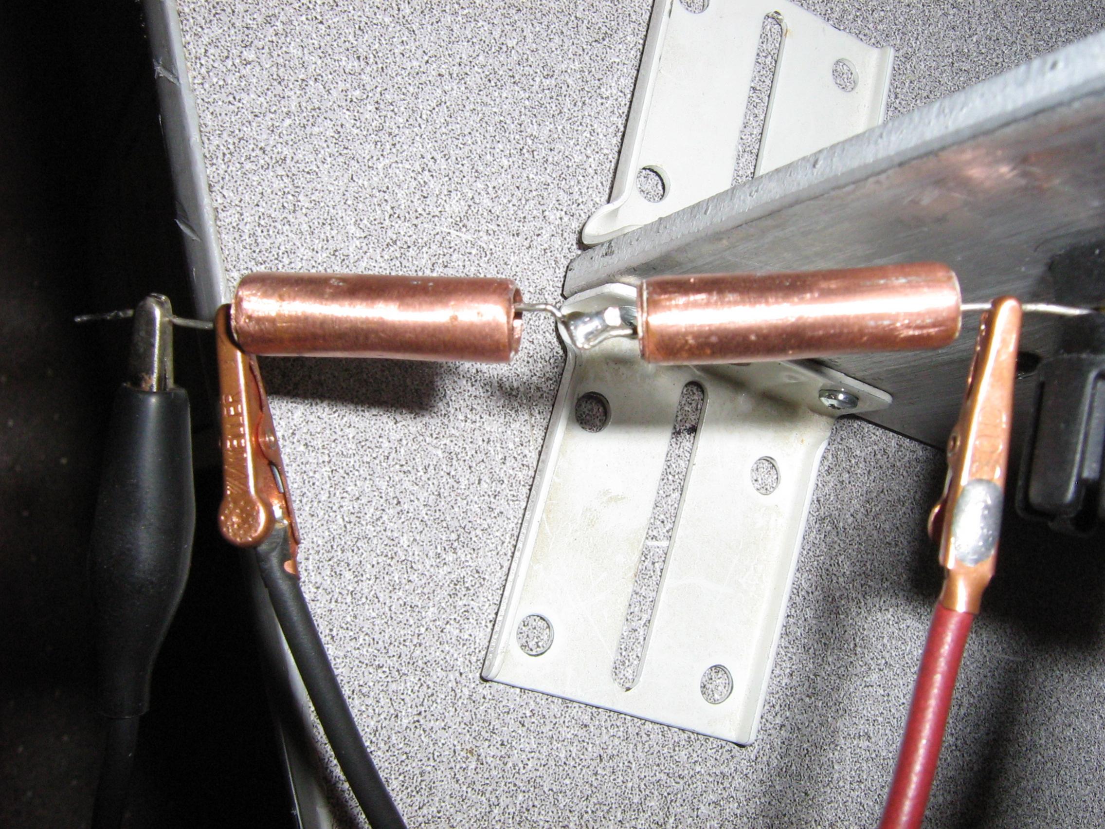

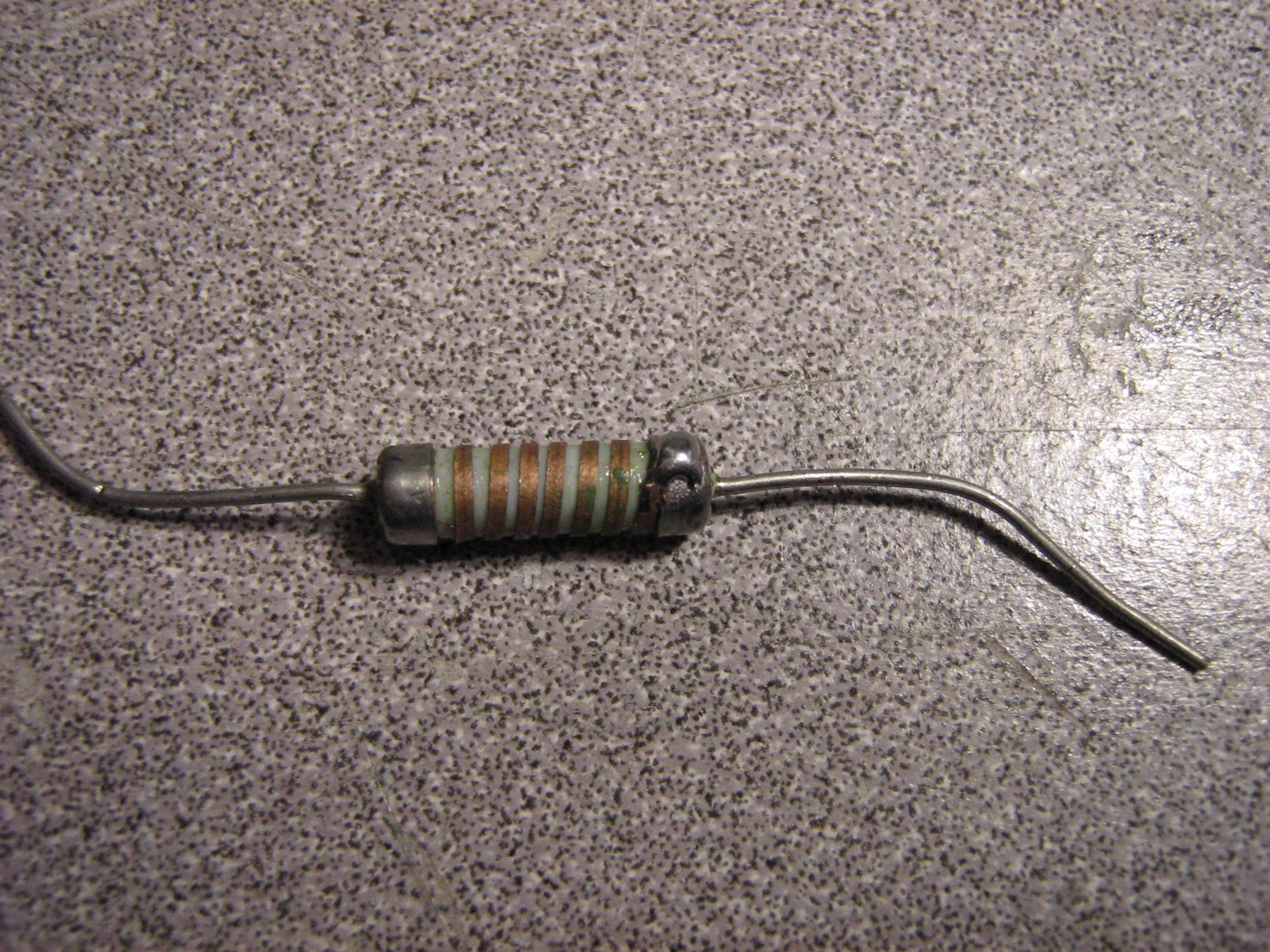

Since I haven’t seen any references posted other than that from RMJ1, I decided to do a little practical investigating myself by first removing the outer coating of insulation that covered the resistor, of which a photograph is attached (nonlinear resistor 003.jpg).
As can be seen, the connection between the tape type of resistance wire to the end caps seems to be spot welded and when I lightly stressed these connections, they appeared to be quite solid as was the lead-out wires as well.

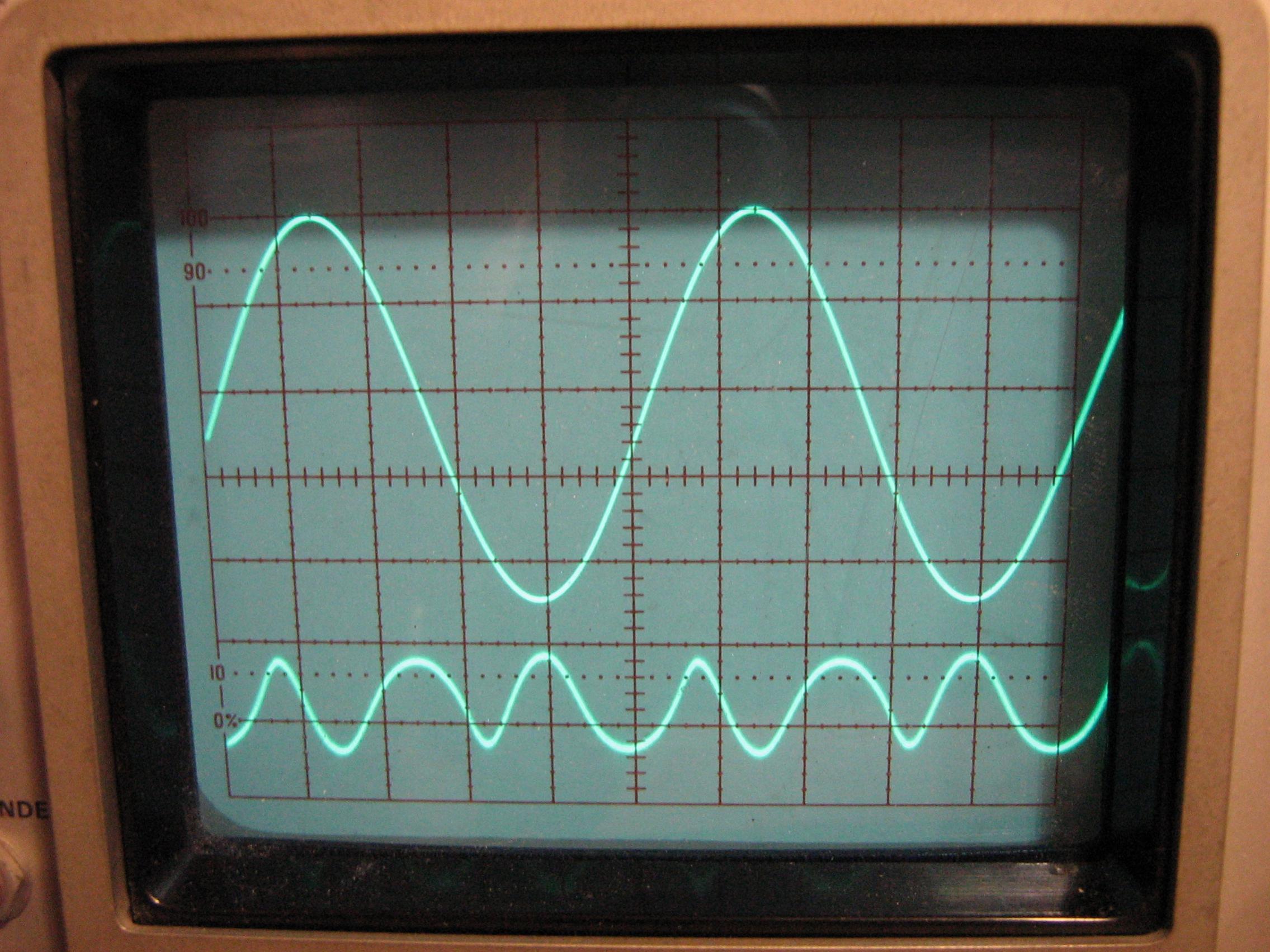

I connected this resistor (0R05) in series with an 8R0 resistor and connected the combination (8R0+0R05) across the output of my amplifier as previously described and noted that for this particular 0R05 resistor, the measured THD was 0.14%. Previous measurements used two 0R05 resistors in series, but with this new setup, I used just one. To obtain the same input voltage to the analyzer as previously, I increased the power output, hence the higher THD level. The THD at the output of the amplifier measured 0.003%.
I then scraped the surface of the tape over the points where it connected to the end cap and with some flux, I soldered the tape to the end caps as shown in the attached photograph (nonlinear resistor 006.jpg).
After reconnecting the 0R05 resistor back into the circuit, I was surprised to see that the THD had dropped dramatically to 0.075%.
I then soldered two 1.3mm dia. solid copper wires right on top of the tape connection points to the end caps (nonlinear resistor 009.jpg) and re-ran the test again and found an even more dramatic drop in THD to 0.0045%. The distortion output from the analyzer showed a small amount of wideband noise riding on the distortion waveform. Without this noise, I’m sure the THD would be even closer to the 0.003% of the amplifier. So at this point, I feel confident that the root cause of the problem is due to the connections between the tape resistance wire and the lead-out wires with the end caps.

1) The former on which the tape resistance wire is wound appears to be made of a solid round piece of white ceramic material.
2) The end caps were strongly attracted to a permanent magnet.
3) Neither the tape resistance wire nor the lead-out wires were attracted to a permanent magnet.
4) The lead-out wires appear to be made of tin plated copper.
5) The tape resistance wire appeared bronze or dark copper in colour.
6) My analyzer has a maximum sensitivity of 88mV in order to reach “set level” which is the level that was applied across the 0R05 resistor. Therefore the dissipation in this resistor was limited to 155mW. The rated power for this resistor is not known, but from previous experience, it corresponds in size to those that are known to be =>3Watts.
7) These resistors were sent to me by a company in China, so I would think it likely that they were made in China.

One more thing, I sprayed the 0R05 with freezer spray and its resistance dropped slightly, which reduced the voltage across it. The THD went down too, but returned to its original THD level when I readjusted the output voltage of the amplifier for the same voltage across the resistor.
So the non-linearity of the resistor seems to be sensitive to the voltage across it, not the current through it! I say this because the 0R05 resistor is in series with the 8R0 resistor, which makes the 8R0 resistor appear as a constant current source to the 0R05 resistor, since it is 80 times greater.
