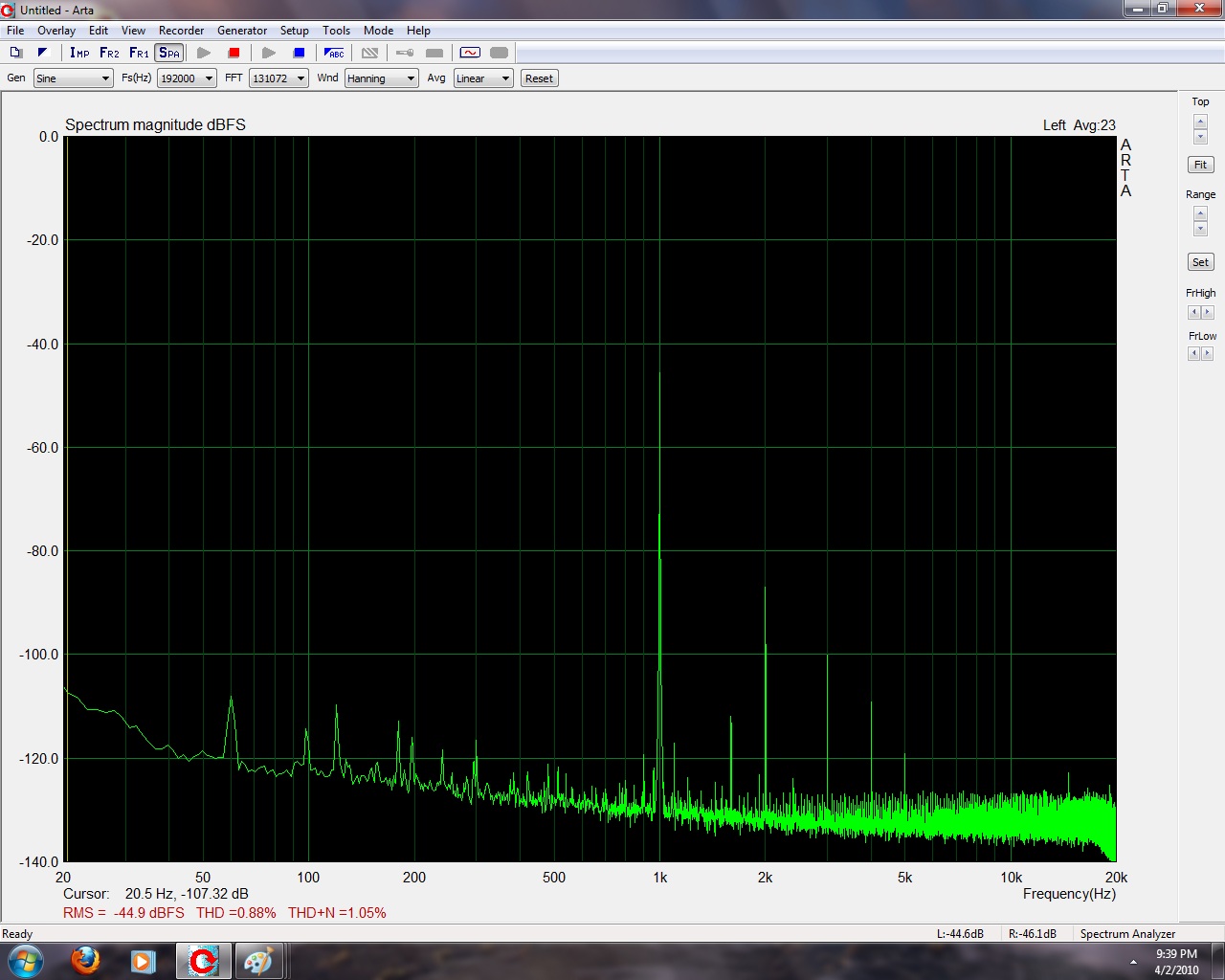

First let me say that I have never built an SE tube amp. However, I built a 50% cathode follower push-pull amp and as a result of compromises I made in the design of the last voltage amplifier stage I got some extra second harmonic distortion.
Many go on and on about how second harmonic is a euphonic distortion, but what many also overlook is that the non-linearity in the transfer function that produces the second harmonic distortion will also produce IMD when two or more tones mix (Hey, that occasionally happens in music). That will happen with any non-linearity in the transfer function. The best amp is the one with the straight transfer function. You just have to minimize overall distortion, make sure you aren't producing too much of the really nasty-sounding harmonics, ensure slew rates aren't limiting things, make sure transients get reproduced accurately, make frequency response flat, and reach your target damping factor, making trades as necessary. It's really quite simple.
By the way, my amp sounds awesome except when the singer makes an "s" or a "t" sound with any sort of musical accompaniment, then I cringe. Oh, well. Adjusting out the imbalance should be easy enough.

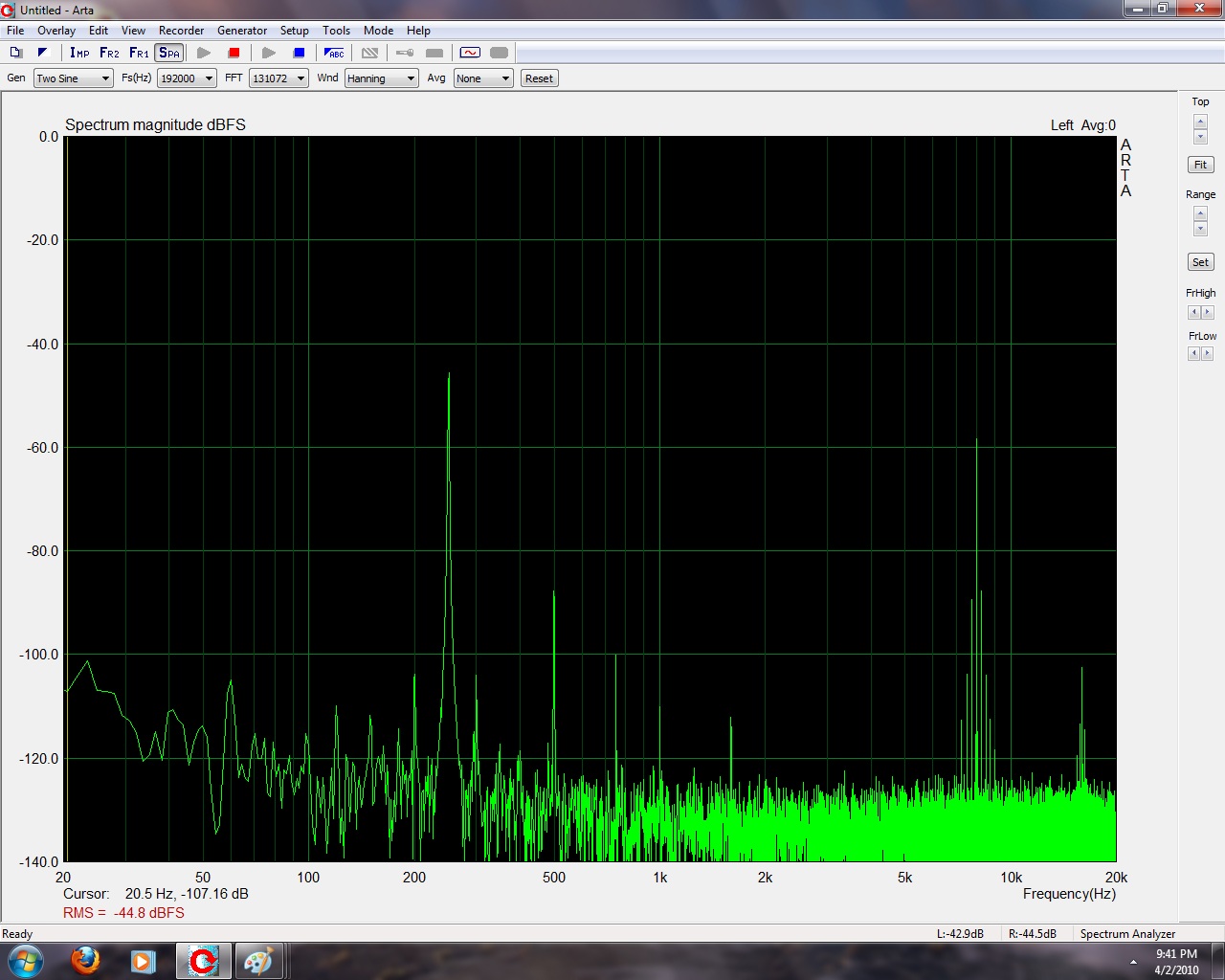

Attached are IM distortion results that go with my plot above (same amp same power level). The big spurs just off the 7k are the result of the same bending of the transfer function that causes the 2nd harmonic distortion, the next spurs are caused by the 3rd, etc. Wouldn't it behoove me to get rid of those big spurs caused by the 2nd?
2nd harmonic distortion may sweeten a single note, but screws things up for real music. There is no reason to put 2nd harmonic distortion into your music if you can get rid of it. A well designed push-pull amp shouldn't have too much higher order distortion, either. That's what we should be shooting for, distortion as low as possible with special care not to generate even minuscule amounts of nasty harmonics. Then pair that with some efficient speakers so it won't be working very hard.

Wow! That is one hell of a peak at 7Khz.
Not to mention the inter-modulation distortion around that 7KHz peak.
There are IM peaks greater than the 2nd Harmonic peak.
Well, it's an IMD test. Injected signal was dual tone 250Hz/7kHz, so 7kHz peak shouldn't surprise. The spurs are the IM caused by the nonlinear transfer function. And yes, they are about the same amplitude as the second harmonic of the 250Hz fundamental. Ignore the blip about two-thirds of the way between 1kHz and 2kHz as this seems to be an artifact of my test setup. I honestly didn't think it would work this well with the built-in motherboard soundcard.
Also notice that I have an ugly tumor on my spectrum at 14kHz due to the second harmonic distortion.
Remember, IMD can come from power supply noise and other places, but any curvature in the transfer function also causes IMD and IMD does not sound good.

What was the scale on the FFT? Was 0db one watt?
It seems to me I see PIM there... Sideband strips are of different heights.
I'm only aware of the mathematics of FFTs on a high level. Could the unequal sidebands be errors due to this just being a single FFT, as opposed to multiple FFTs averaged like the earlier post? The amp in question doesn't work at the moment or I would just fire it up.
The only thing I can think of that would produce PIM would be the FQPF2N90 source followers, but at 1W output from this amp there are still always a couple of hundred volts Vds at all times.
The total power on the 8 Ohm load was 1W (measured with one of those Pete Millett interfaces). I probably should have cranked down the attenuation since these levels are pretty low but I wasn't really in precision measurement mode when I took these, I was just trying to figure out how to use the software. You may notice that I hadn't figured out how to get it to compute IMD% yet with the software, otherwise it would be displayed at the bottom. Then a regulator went out on the amp and I decided to redesign the PCB before fixing it and there it sits. I should pull out a commercial solid state amp out and run the same test and see how it does just for fun.
