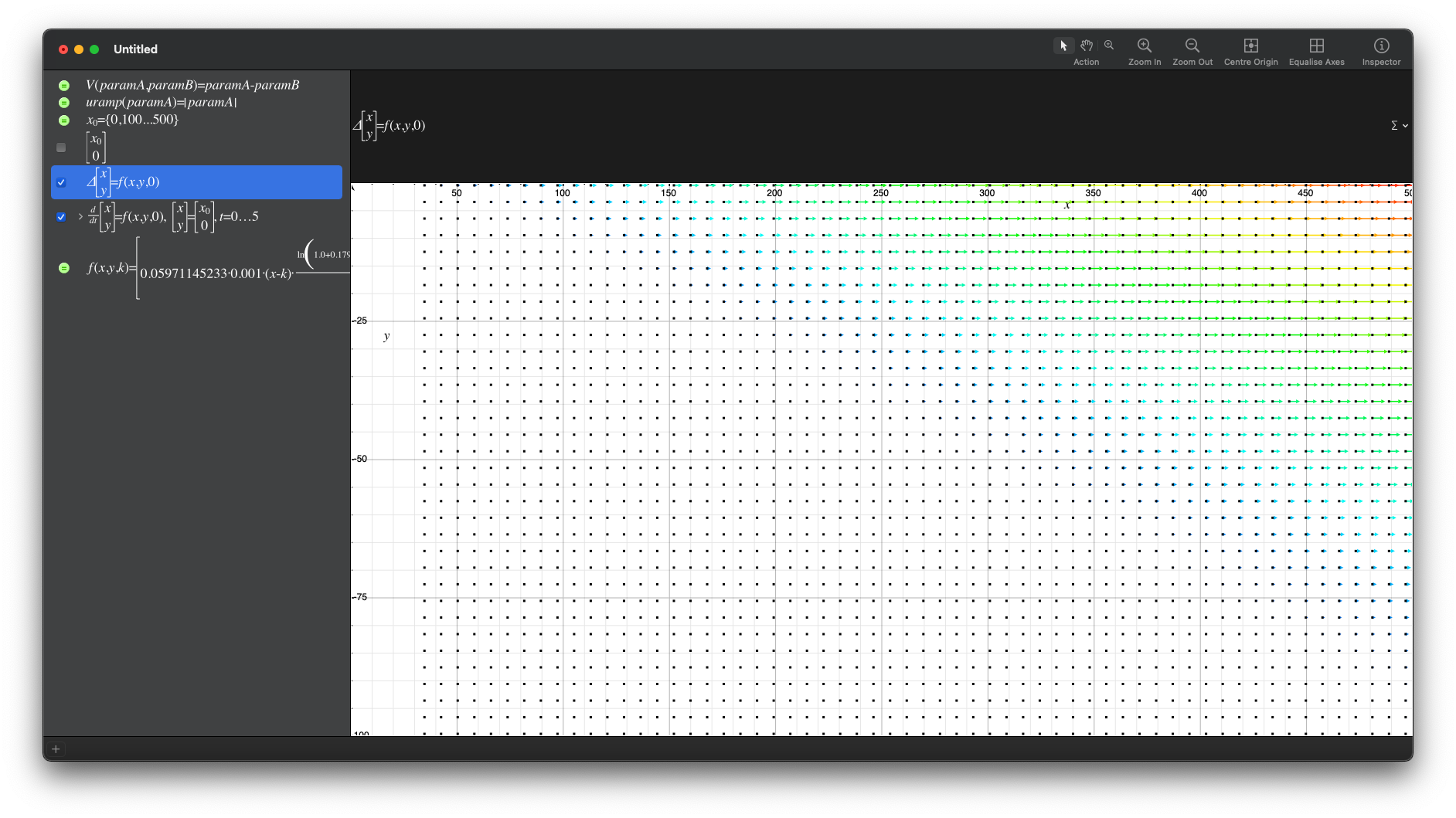

MacOS has "grapher" as part of the OS. For simple 2D and 3D graphing this works well. It has some interesting functions but it's not quite as programatic as Octave / Matlab / Wolfram:
I think I have this right.
So centre shows a sine wave (actually 4x so that it's fast). I've then created a simple e^x valve function as a mapping. Then applied the that and you can see the output of the spoof valve as the asymmetric waveform.
Super imposed on that waveform is the 3,5,7,9,10 and 20th odd harmonic that makes up the output wave.
Actually this grapher looks not bad. It's got quirks but manages todo differential equations and vector fields:
This is using the ltspice model of the 2a3. I need to play more but it would be good to show distortion over the field.

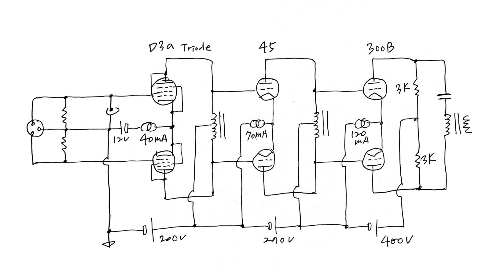

A dual triode input stage with coupled cathodes and a CCS in the parallel cathodes . . . that creates an extremely low 2nd harmonic distortion phase inverter. If necessary use another dual triode stage for the driver (if you need the extra gain and/or voltage swing), and drive the push pull output stage.
And I like the sound of those amplifiers too.
Just my opinions; just my experience
Hi 6A3sUMMER,
I happened to have built an amplifier that matches what you are saying. The final stage is resistor-loaded para feed, giving a lot of heat.
It's all SMPS-powered including heaters and Lundahl transformers, a result of experimental DIY using my ears for many months.
And I also like the sound of this amplifier. 🙂
