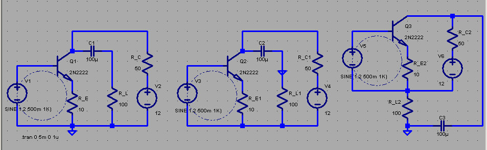

A few friendly remarks:
From p. 5 re: two transistor circuits:
<<there is another method for amplifier linearization, the literature erroneously
referred to as feedback. The picture above shows two functional identical
amplifier stages. The left amplifier stage is working with a negative feedback
loop, whereas the right one is linearized through a resistor in the emitter line.>>
Since when did good engineering textbooks become "erroneous literature"?
Left amp has "Neg. Voltage FB",
Right amp has "Neg. Current FB"
It is in the books.
<<...we have found that negative feedback reduces the output resistance. This
holds true for the left circuit part, but not for right part. The larger the emitter
resistance gets, the more linear the circuit and the larger the output resistance>>
Neg voltage FB reduces the output resistance, neg. current FB increases Rout.

The subject of distortion harmonics, generated by NFB, was covered by P. Baxandall long ago, and very well, and can be referenced.
It is in the books.

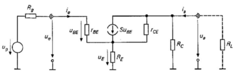

Thank you very much for the response
Thank you very much for the response.
The paper was written for absolute beginners as well as for someone with a bit more elaborate interest in audio. It should read in two languages, cover a lot of topics with some eye openers and should not exceed the 13 pages. This was difficult to achieve. If you feel, that it "is written not in a very good literary style: jumping from something to something, and not with very convincing logic", I apologize for that. There was simply no space for detailed explanation and argumentation. A customer for an audio product will never read textbooks; he is pleased to know a tiny little bit more about his amplifier / CD-player or what so ever.
I do not apologize for the content and there is nothing to be revised. The whole feedback yes / no issue has been discussed here in this forum and else where to death. I made my point on the current feedback issue, which is not a classic feedback for me. I know that textbooks like “Halbleiterschaltungstechnik” from the honourable authors Tietze + Schenk (the book is nearly a bible for German students) call it “current feedback”. Perhaps someone can show me the loop, can show me where the output signal is measured / probed for a correction loop.
In my perception it would be much more accurate to call this a) linearization or if someone wishes b) bootstrapping technique.
a) Every active device has a current specific transconductance gm, which is as we all know extremely nonlinear. The reciprocal of gm is a resistance, still nonlinear of course. By connecting a much larger resistor in series with the internal resistance we achieve linearization of the resulting gm'.
b) All circuit potentials change directly in dependence of one and the same collector current, bootstrapping the emitter and holding thus a change in UBE very small.

Ila, there is no need to apologise, Source/Cathode/Emitter degeneration is definitely not a feedback - no signal is being "fed back" and there is no loop and no reductive comparison takes place. It's just the way the gain devices are built.
Nelson's measurements confirm big difference between degeneration and feedback loop.
Horowitz is not the only textbook author, there are/were people in this world that really understand the topic.
Best regards!

The “not touching/sampling the output” is not a valid objection – controlled current sources have 2 terminals – the “output” from either is the same for analysis - - and remarkably accurate for real world 3-termianl gain devices
Haven’t you seen the analysis trick of moving the gnd? – we can label any one node of a circuit with the gnd symbol without changing the operation in any way
But sometimes the transformation aids understanding by fitting a circuit into a more commonly recognized pattern:
below the circuit topology is identical in all three drawings – the dotted “loop” is the same, but maybe the third picture makes its interpretation as local negative feedback more easily seen
the formal feedback language is that R_E in "series" with the load "samples" the output current, the R_E Voltage drop is subtracted from the Source V by the "series" connection in the Vsource, Qbe, R_E loop
making this a "series-series" feedback circuit

the source LTspice file is attached (just strip the .txt) and you can check measurements by using the "differential" probe feature, click a node with the red color "probe", and hold down the button while moving to the "reference" node, releasing when the black "probe" is on the node - you should see that the component V differences don't care about which node is labeled with the "gnd" triangle

But of course there is! Without the Re the current trough the device would strongly increase with increasing Vin. With an Re, the voltage across Re subtracts from Vin to make the Vbe and therefor the current cannot increase so strong. max gain is 1 because of 100% nfb.

What you say is that control value (Vbe) becomes smaller because of the raise of the emitter potential (caused by voltage drop across Re). That kind of reaction is not a feedback. It's emitter degeneration.
Yes. Same thing, different word. All the concepts, calculations and circuit attrributes resulting from the application of negative feedback are fully in force for an emitter follower. Stability, change in Zout, improved linearity paid for with decreased gain, thermal eqilibrium, just use the well-known nfb calculations and there you are.
