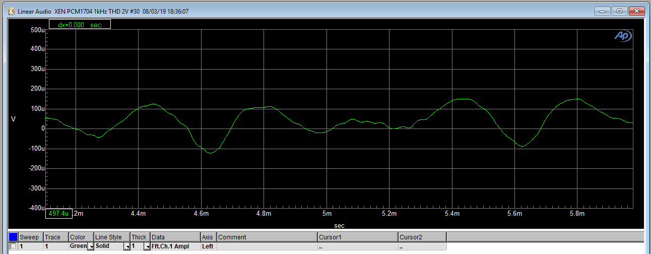

Jan doesn't the AP have a monitor readout of the residual distortion? You can look at the residual on an O-scope in the time domain. If you view the fundamental on another channel you can see the phase difference. Using the add function on the scope has an interesting result. You can identify where the distortion is occurring in the waveform, e.g. crossover distortion etc.
Yes, but the residual has all the harmonics and is not a 'nice' waveform. The attached is with a 1kHz fundamental (not shown, but I understand to make the phase relation visible)
What I can try is to set the FFT such that it only takes the 2nd and then convert to time domain.

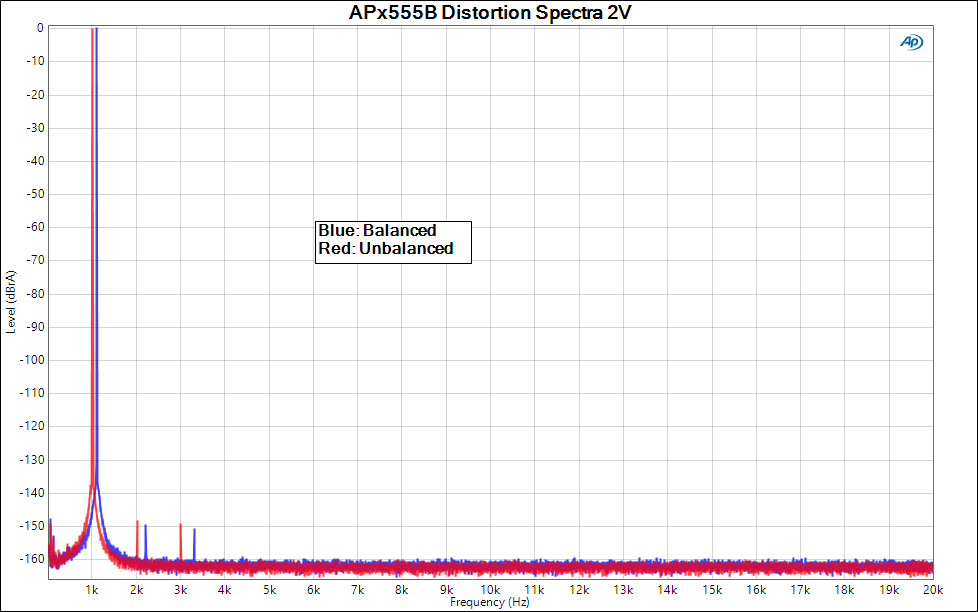

Edit: if you are looking for a target performance, the attached is a real-world measurement ...
