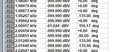

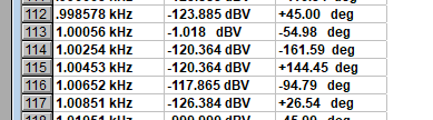

As first step I tried to generate a waveform that has a 1k fundamental at 0dBV and a -60dBV 2nd with a defined phase difference of -90deg and see it the analyzer recognizes that.
Defining the waveform is easy, but I can't make anything from the phase results (amplitude results seen OK). Used the FFT analyzer but the phase info looks nonsensical. See relevant data attached.
Might have an issue with triggering of the FFT but it's hard to find out what exactly is going on...

Are the two screenshots results of one FFT? They have a different bin (2Hz vs. 4Hz).
If so, the result looks like the 2nd harmonic has not been phase-shifted. The fundamental is at -55deg. The H2 is twice as fast. Should be 2 * fundamental shift + initial shift. You have it exactly at 2 * fundament = -55 * 2 = -110deg. But again, it does not look like the two values are from the same FFT run.
Can you configure your FFT to fit the sampling rate, so that you hit integer Hz in FFT? I am using 48k for 48kHz sampling rate, each bin is exactly 1 Hz. 96k, 192k, etc. all would yield a bin with 1,000Hz center exactly.
Of course the method requires that DAC and DAC run synchronously, so that 1kHz by the DAC gets sampled as 1kHz by the ADC. I assume it holds for your PA.

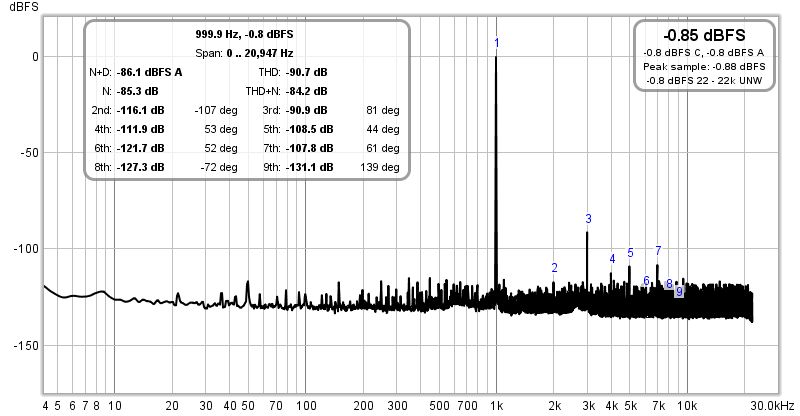

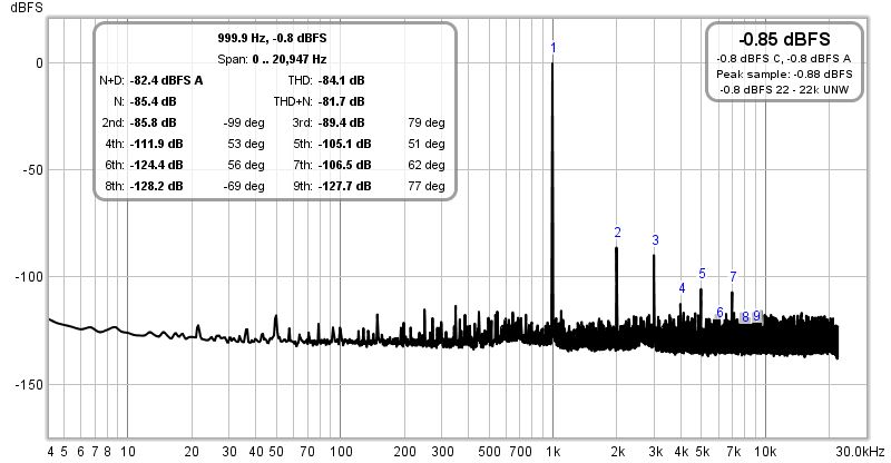

There's nothing wrong with the principle, though "zero" may be a challenge :). Here it is done on a cheap 16-bit soundcard, for the second image an opposite phase 2nd harmonic was added to the test signal, dropping the level of the distortion component by 30 dB.
Well I would be very happy with a 30dB reduction!
How did you generate that opposite 2nd, sound card digital generator?

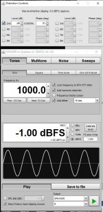

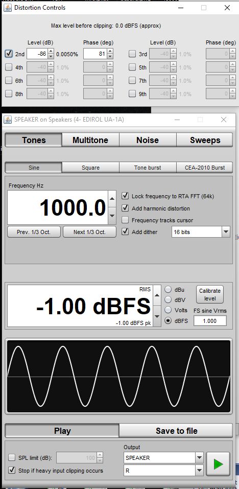

The purpose of this is to measure the amplitude and phase shift of a 2nd harmonic in a loop-back self-test result and generate a new test tone with a 2nd harmonic that has the the same amplitude but opposite phase, compensating for the self-distortion. IOW, generate a test tone that, ideally, shows zero distortion in loop-back.
That is why I call joint-sides calibration applied to DAC side.
FFT (at any time, triggering is irrelevant) will tell you fundamental and harmonics phase + amplitude.
Harmonics amplitudes:
a) scale harmonics level linearly to your fundamental level so that the relative amplitude fundamental vs. harmonic is same. E.g. generated -3dB fundamental, recorded -6dB fundamental, recorded -100dB H2 -> pre-distorting H2 on DAC side will be -97dB.
Harmonics phases:
a) Calculate time offset (T) of the measured fundamental phase to time zero when fundamental was at 0 deg.
b) Calculate how much phase shift (fi_offset) each harmonic accumulated during that time T.
c) Subtract fi_offset from your measured harmonic phase, yielding fi0. That is the harmonic phase at time zero, when fundamental was at 0deg. This is how much your harmonic would measure if your FFT was triggered at time zero when fundamental was at 0deg.
d) Generate your compensated (pre-distorted) signal with fundamental starting at 0deg and harmonics starting at their inverse fi0 (fi0 - 180deg), so that each will cancel out with the corresponding harmonic generated by the loopback chain.
