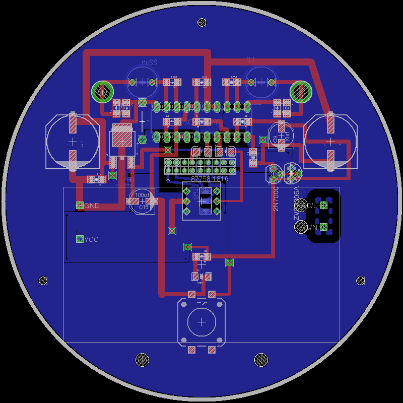

I have been building a simple TPA3122D2N based mono class D amp, trying to follow as precisely as possible TI datasheet. PCB has been lay out in Eagle and manufactured be Seeedstudio, soldering has been kind of a hassle (damn you smd component) but in the end it worked! The power supply is a IRM30-12 by meanwell.
Trouble is there seems to be some distorsion on high frequencies. Some really strong harmonics, that can only be heard on the tweetter.
I checked and checked but still the most probable issue is that I made a circuit mistake or badly selected a component.. So I came here for help! I join a PDF of my circuit board with farnell references of component used. By the way, if anyone wants the eagle file, don't hesitate!

Could be a layout issue. I never experienced that sort of problem with the boards I built around this IC.
Probably not related to your problem, but you do realize that grounding one input and using the outputs in a differential fashion has no advantage other than avoiding the use of output caps? It is not truly "bridged" without inverting the signal on one of the inputs. You are basically just trading more output noise in exchange for not having to use DC blocking caps.
I'm guessing the problem is indeed related to using the IC that way.
Well, I experimented with using it that way and I don't remember it having any negative effect other than slightly higher noise, which is why I suggested it might be a layout problem.
I would definitely try to run it as per the datasheet to see if the noise goes away though. Don't need to do anything other than put a cap on the output and reference the load to ground instead of the other channel.

Regarding the layout, I followed every instruction in the TI notice. The only quirk I indulged myself was to use a VCC plane instead of a ground plane. But then again, I come from electronics not audio, so all these analogue stuff still looks like voodoo to me!
For reference I join an image of the layout (there is a HDCD radio receiver board that get soldered in the middle of the pcb, hence the 5v regulator and the button and status led).

After testing, indeed, using it as a true stereo chip and using only one channel does indeed reduce noise. It is faint but audible. And to answer my own question, after a little research, to use it you have to transform tour single ended signal into a differential one.
Many ways to do it, but if I manage to put my hand on this , I'll try it out!
It's really not worth trying to run it bridged. The chip can't handle much current output, so with an 8 ohm load you will only gain 5W bridged.
For the cost and complexity of adding additional circuitry to run bridged, there are many more suitable class-d options out there.
I know you already put effort and money into your board, but I suggest either just using one channel or find another IC and start over.
Yeah, it kind of was my take on this too! Anyway the power output on one channel is more than sufficient for my needs.
The next version of my card will include the capacitor and everything will work out fine!
Honestly I was kind of blown away about how easy it is to work with those chips. I thought I was kind of reckless to send the pcb to the fab house without any breadboard pre-testing but in the end it turned out better than expected!
