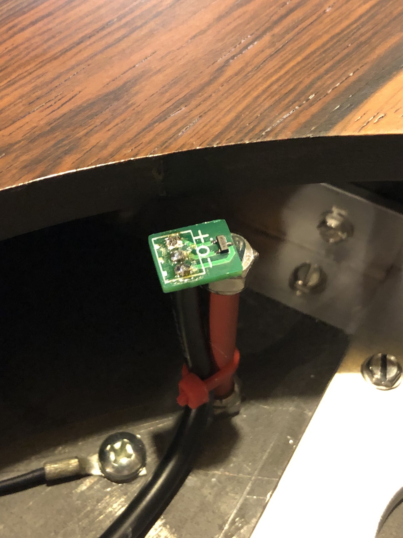

Where in the world are you? If you're located in North America, I'd be happy to mail you a board (plus the Hall effect sensor pcb), gratis.

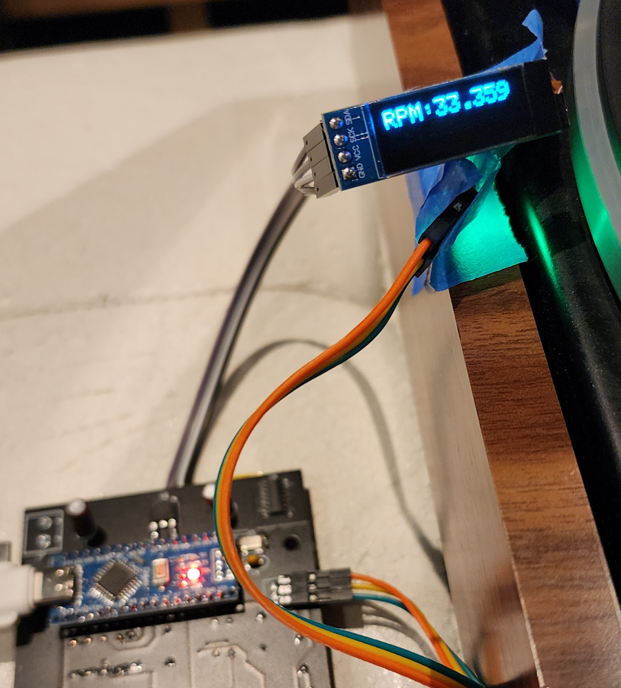

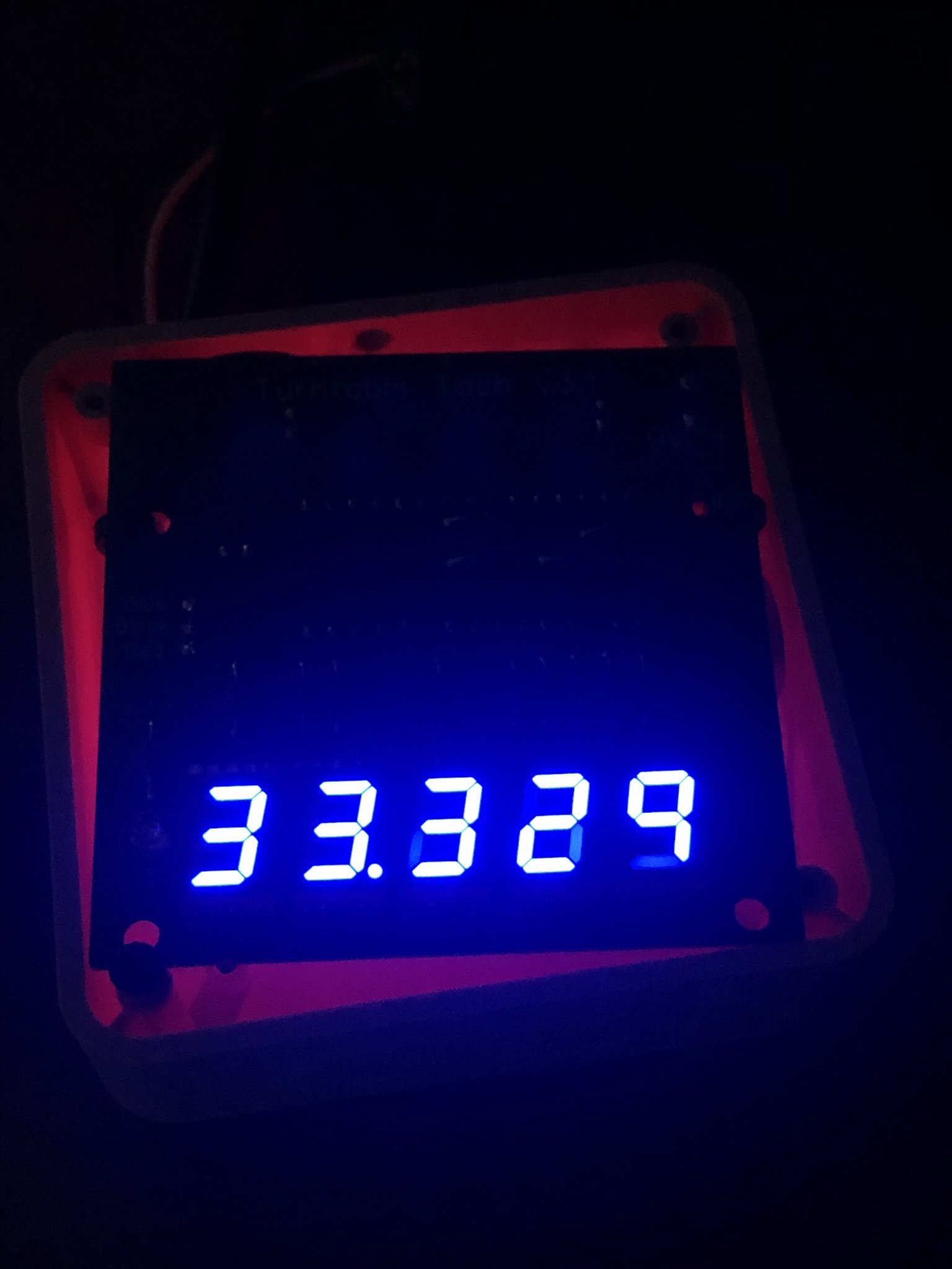

Final parts arrived last night and was able to get it all up and running!
Made a small change to the program to illuminate the top segment (A) for the number 6. Changed line 21 to: B10111110, //6.
Have also experimented with an OLED display. Display uses IC2 comms which are on pins A4 and A5. Have to unsolder pins A4 and A5, so it's the LED's or OLED display. Wish the board has more AO's so I could run both simultaneously. This gives me an option for a small display to be placed near the TT.
Setting an a random box for now until I figure something else out. Gears are turnings in my head for a 3D printer to make an enclosure.
Here's some photo's. Thanks to John (johnhenryharris) for posting the project and to Scott (SRMcGee) for graciously sending me the boards!
Nice. I tried the OLED display on prototypes, worked well but I couldn't find one in the size I wanted so went with the seven segment LEDs.
I've built a few of these for friends and managed to injure an led or 2 along the way so the OLED is a great low cost, lower effort way to get a working tach in some cases. Thanks again johnhenryharris for sharing this with the community. I'll post some pictures once I get a chance but for anyone who wants to build this with a 128x32 OLED (the 0.91" is what I used), here is the .ino. I'm sure there are 1000 ways to improve this but it's been many years since I had to write any code.
To get this working with the current pcb, don't install any of the display leds or resistors and connect the OLED to 5V, GND, A4 and A5 as usual. You still need the rest of the bits associated with timing (crystal, etc) but if you power directly through the arduino board, you can even omit the 7805 and caps.
Cheers!
Cheers!
Nice job with the code, I had something like that in the prototype with the OLED.
Do you have a pic of your display?
