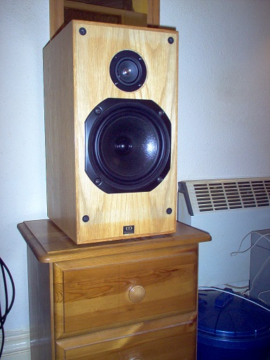

Here's that relentlessly boring WLM La Scala speaker which plain fascinates me:

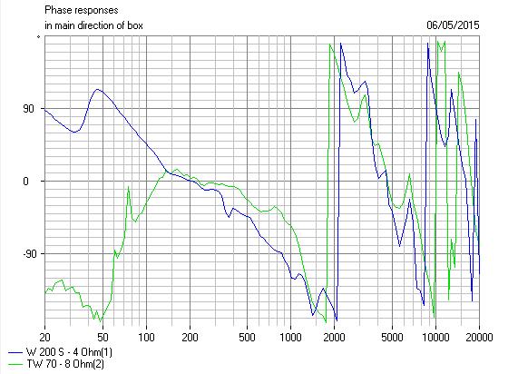

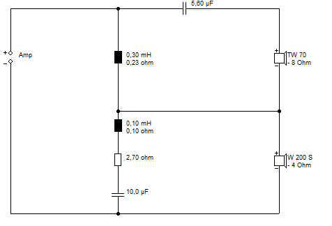

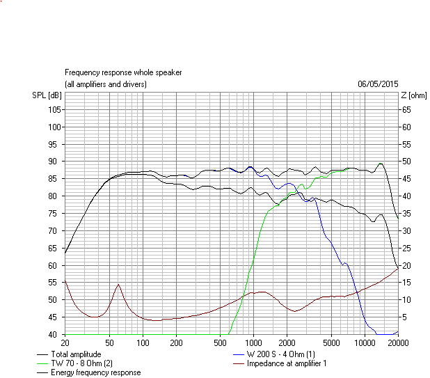

I have good reason to think that WLM are using the Visaton W200S-4 ohm driver along with that TW70 cone tweet. It looks shocking on paper, but give it a simple series filter, and I revise my opinion. Qms = 3.99 BTW with a rubber surround. Not 10, but high. Obviously no SEAS-type metal former there. 🙂
What an amazingly simple crossover that works at so many levels! The drivers are MADE for each other. 😎

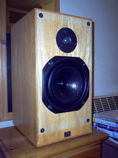

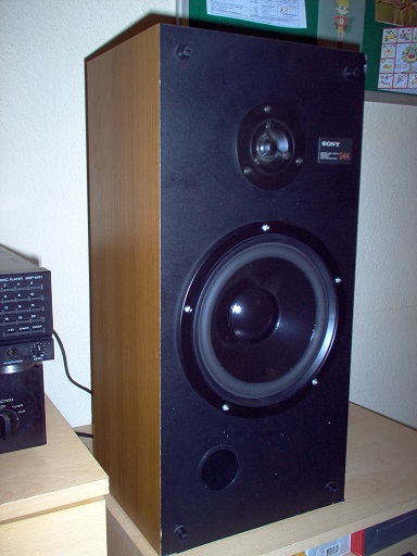

Below, The GOOD, the BAD and the UGLY. In terms of tweeters. 😀
