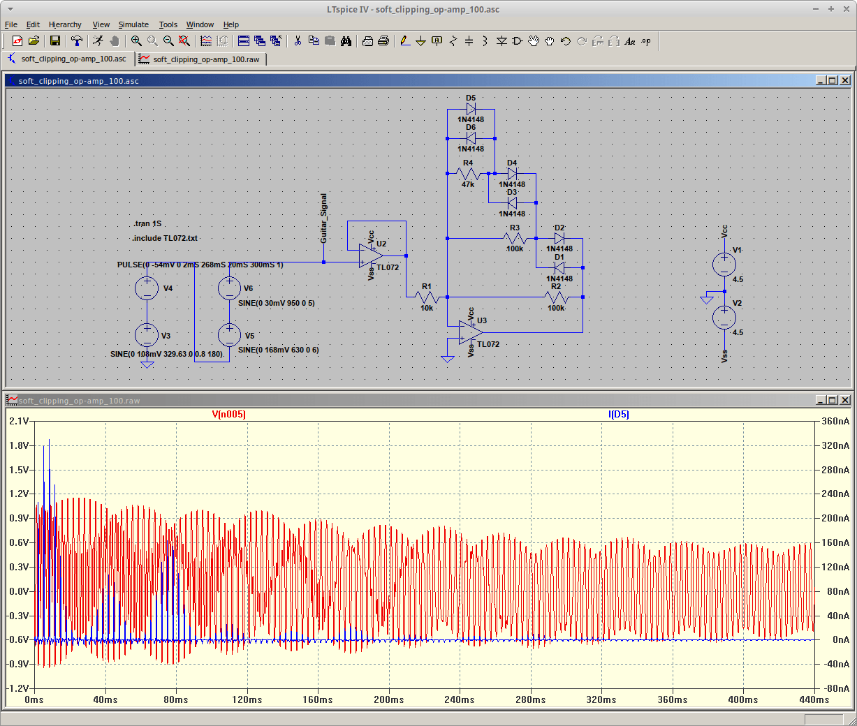

Here's a quick implementation of the above idea. Resistance values have not been optimized - I just threw the circuit together as fast as I could.
R1/R2 set U3's gain to x10 for small signal levels (compare with x11 for the earlier simulations without the diode network).
The diode/resistor network in parallel with R2 roughly halves the voltage gain when the output signal is big enough for D1/D2 to conduct at around +/- 400 mV, halves it again if the signal becomes big enough for D3/D4 to conduct (at roughly +/- 800 mV), and finally clamps it hard if/when D5/D6 conduct (at roughly 1.2V).
The attached image shows no hard clipping at the output (red trace).
The overlaid blue trace shows current flow in D5; evidently the signal does get big enough at some instants to trigger D5/D6.
As mentioned earlier, I don't love the sound of diode clipping - but it may be better than harsh op-amp clipping. And if signal levels and stage gains are set well, D5/D6 may never conduct, or only at the very strongest signal peaks.

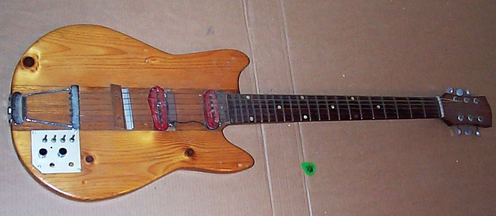

The attached photo was my first electric guitar, a diy project I built some 35 years ago, around a neck and tailpiece from a friend's broken archtop guitar.... some unusual wiring including a tiny switch to run the pickups out of phase.
You can see four little toggle switches on the aluminium control panel.
One of them was a pickup selector. Another one put both pickups in parallel. A third reversed the phase of one pickup.
The forth switch was a rhythm/solo switch, the idea being to drop the signal level a few decibels for strumming chords, then bring it back up to play a guitar solo.
I quite liked the ability to parallel both pickups, then reverse the phase of one. But there were other problems with that guitar (I didn't really know what I was doing when I built it), so I moved on.
I've never had another guitar with a phase-reversal switch. Pity.

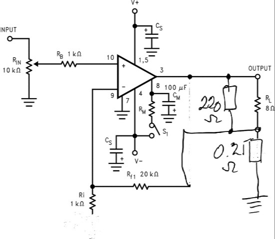

Here is what I did...like I said, for my HiFi- OK (not quite done yet), but I really like what it did to my Guitar amp...
https://www.diyaudio.com/community/threads/viral-projects-sort-of.351475/page-4#post-6410089
And the schematic
And the schematic

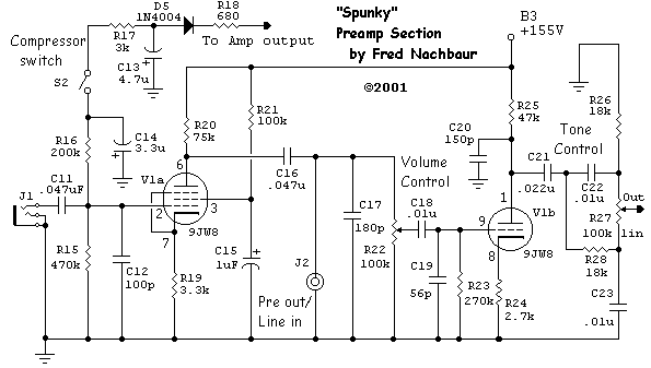

The relatively soft clipping of signal peaks a tube amp is instantaneous and seems to happen only for milliseconds at a time on signal peaks - unlike a compressor, there's no rectifier trying to guess the average signal strength, and no variable gain cell trying to adjust the gain accordingly. When set for clean tones, this doesn't take away any playing dynamics or "feel".
The late Fred Nachbaur's "Spunky" DIY tube guitar amp had a small-signal pentode input stage, and included a compressor option: speaker voltage was rectified, filtered, and fed back to the control grid of the input pentode to dynamically adjust bias point and voltage gain. I would have thought mixing the control signal with the guitar signal like this would have been a bad idea, but apparently it worked for Nachbaur.
I'm attaching his schematic for this part of his amp.
The full Spunky article is here: http://www.dogstar.dantimax.dk/tubestuf/dv8index.htm#index1

Thanks! Yes, that will definitely raise the output impedance of the amplifier (a lot!)
The 0.22 ohm resistor senses current flow through the loudspeaker, and Rf1 feeds back that signal, so the feedback is based on output current, rather than output voltage. And that will make the amplifier try to behave like a constant current source (very high impedance) rather than a voltage source (very low impedance).
I have my doubts if this is a good thing for Hi-Fi (frequency response will be massively mucked-about).
But IMO, high output Z is a good thing for a guitar amplifier feeding an actual guitar speaker, and will give you the EQ curve that the speaker is actually supposed to have in a guitar amp.
True, but you can equalize that out with a filter. Current drive of dynamic loudspeakers reduces (non-linear) distortion at frequencies far from resonance. With voltage drive, at frequencies where the back-EMF doesn't dominate the impedance, it's essentially the voice coil impedance that converts the drive voltage into a current that drives the loudspeaker - which would be just fine if the voice coil impedance were linear, but in fact it has some substantial non-linearities. What happens around resonance can be complicated, but some have measured worthwhile distortion reductions also around resonance.
