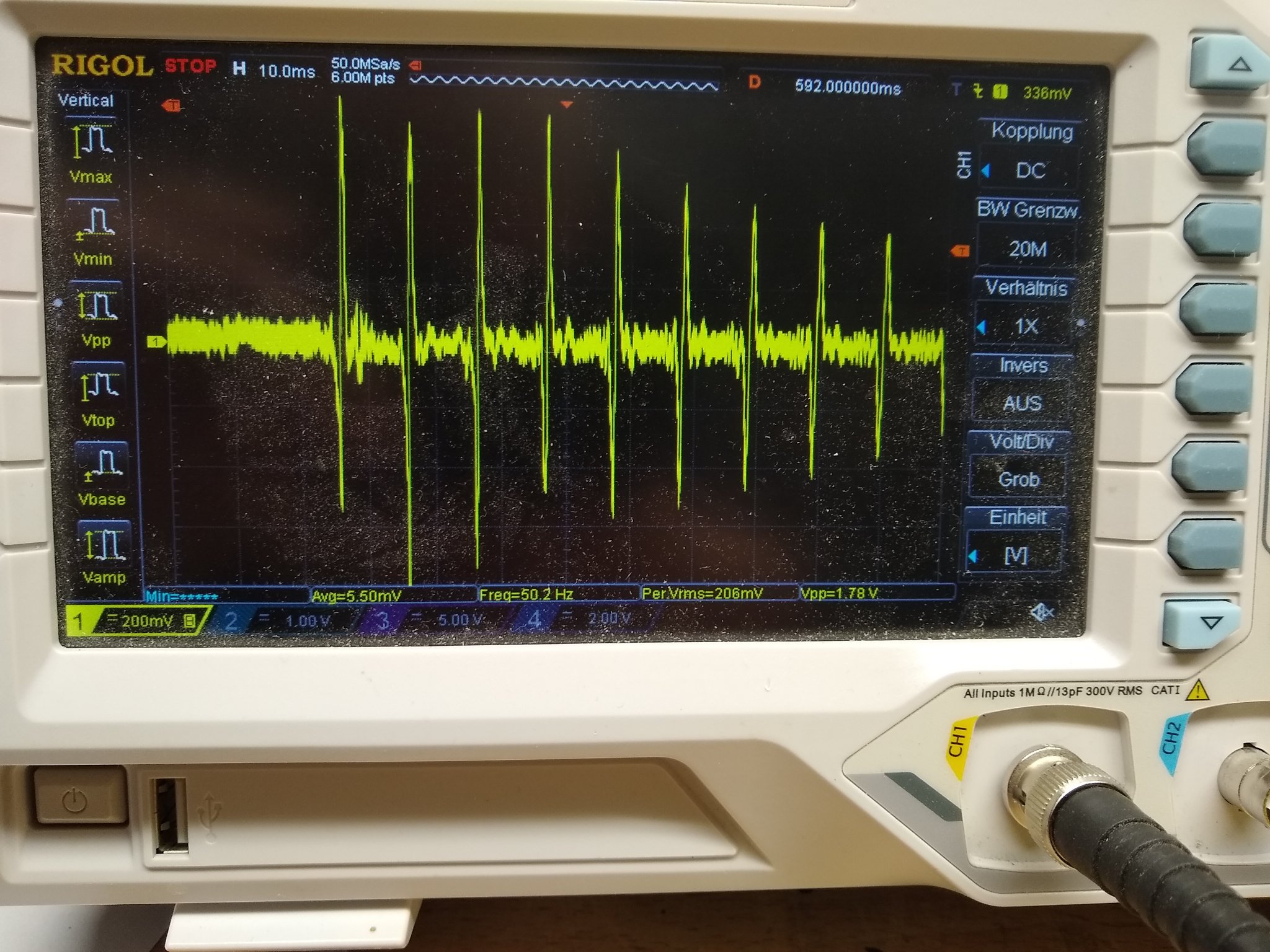

Hitting the strings firmly I achieved upto 2Vpp with the single coils. This may rise to about 5Vpp with a "hot" humbucker.
Thanks for chiming in! I remember previous posts on diyAudio where you mentioned seeing 5 Vpp from your guitar, and I was hoping you would confirm that here.
So I did some listening tests while watching the scope and found that in fact a certain amount of visible hard clipping was not audible to me - not so surprising as the percussion click decays immediately to moderate levels.

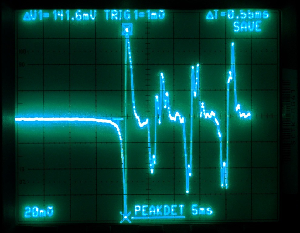

I found the scope picture in the HBAC folder on my hard drive. That guitar can hit about 1.5 volts peak to peak on the initial attack with a single note played.
Thanks for posting that image here. I remember seeing it in one of your posts on the HBAC thread.
By the way, stumbling across the HBAC thread via a Google search - after the brass band had left and most of the dust had settled - was the main reason why I joined diyAudio in the first place. 🙂
One of the more striking things about the guitar waveform you captured is how very spiky it is. That means lots of high overtones, and very little fundamental frequency.
I think that may be the spikiest guitar waveform I've ever seen.
Something to do with the stiff guitar pick, probably, and maybe the pickup position (very near the bridge?).

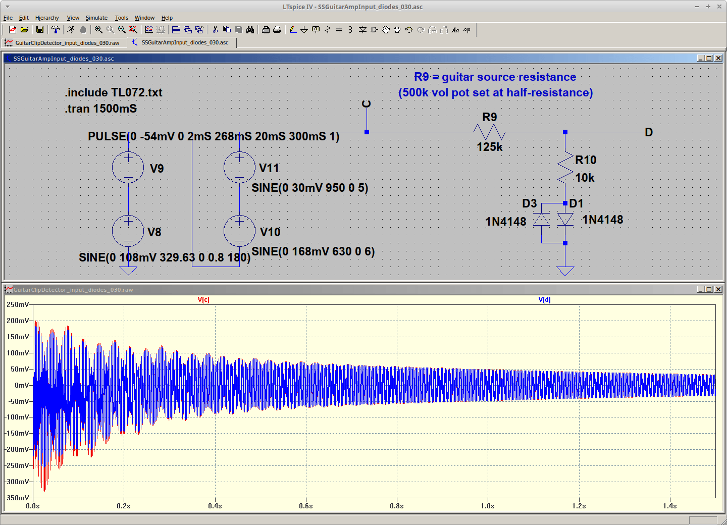

We've already talked about how the curvature of a triode transfer characteristic tends to round off negative signal peaks from the guitar.
But one thing I've forgotten to mention until now is that a tube input stage almost certainly squashes positive going (input) signal peaks as well.
One way in which this happens is well understood - a positive input signal causes the anode to swing negative, and if it swings far enough, anode-cathode voltage drops low enough for the triode to start to "bottom out".
I think there is a second mechanism as well, and I've never heard anyone else bring it up when talking about tube guitar input stages.
Consider a typical half-12AX7 input stage. Vgk is typicall around -1.5 V. A positive input signal peak of, say, +1.2 V brings the grid within 0.3 volts of the cathode, at which point there is already some grid current flow. The input resistance of the tube drops from near-infinity down to some 50 kilo ohms; given the high source impedance of an electric guitar, this is low enough to start to squash the signal peak.
Obviously even bigger positive-going input signals will bring the input grid close to 0V, maybe even slightly positive, input resistance can drop down to just a few kilo ohms, and that big positive peak will be squashed significantly.
If I'm right, uncomfortably large positive signal peaks from the guitar will be squashed right at the input grid itself, and then squashed once again at the anode as it runs out of voltage.
I've suspected this for a long time, but lacked accurate data showing grid current vs Vgk in the vicinity of Vgk = 0.
Today I spotted some interesting data posted by diyAudio member bmc0 about the input resistance of a half-12AX7 when Vgk is near zero, or slightly positive. See posts #266 and #269 in this thread: https://www.diyaudio.com/community/threads/building-a-ss-guitar-amp.381758/page-14#post-7157552
As we've already discussed, uncomfortably large negative signal peaks will also be squashed, this time because of the curvature of the triode characteristics near the origin. And then squashed some more at the input of the second gain stage, because they've been turned into positive-going signal peaks by the signal inversion in the input stage.
Soft signal limiting right at the input - that may be part of "tube mojo" that's been quite overlooked. Now that we suspect this, can we engineer it into solid-state input preamps? Do we need anti-parallel red LEDs (or a couple of 1N4148s in series in each direction) right at the input of an SS guitar amp?

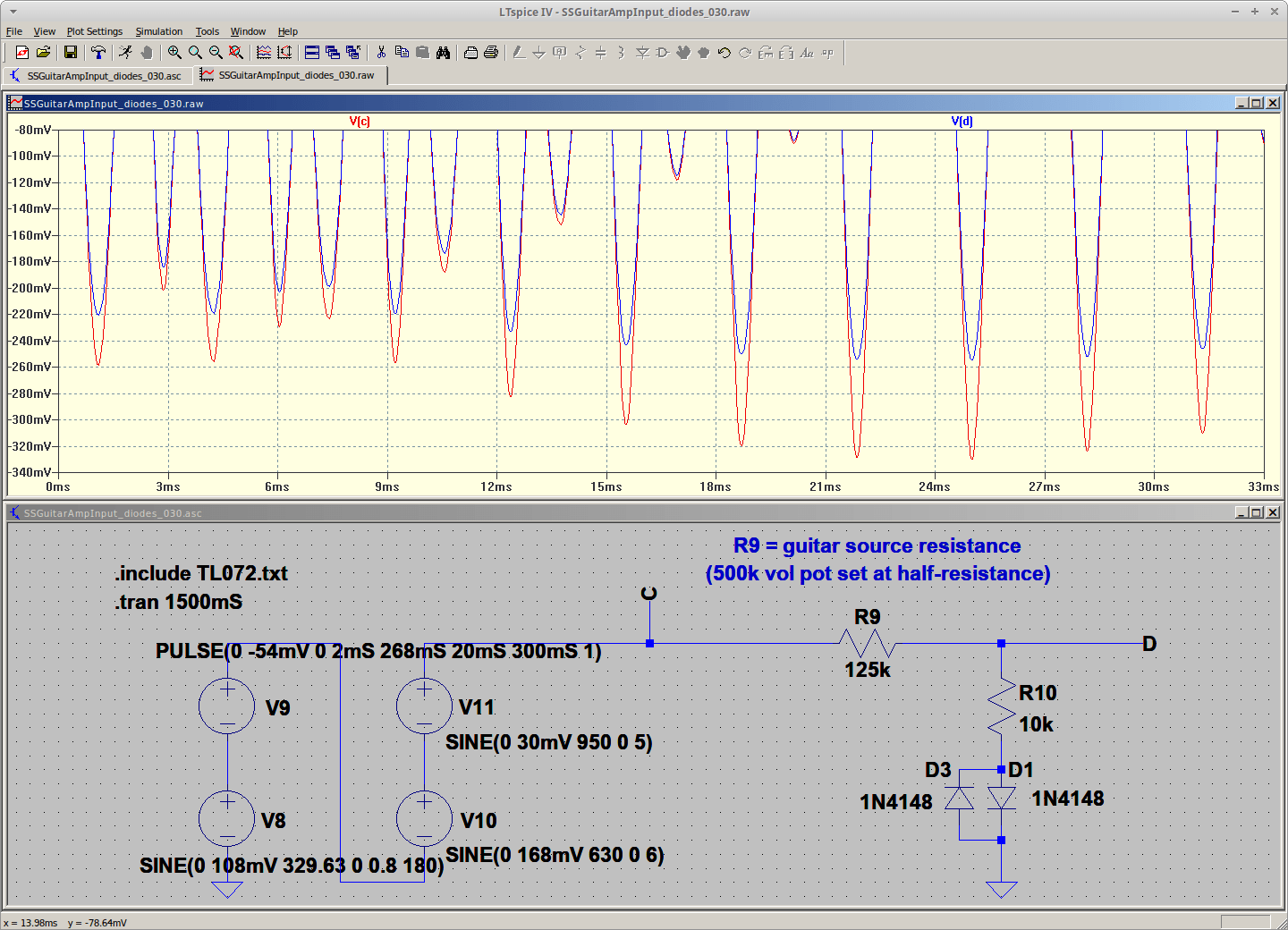

The two attached images are interesting. I've added a pair of anti-parallel 1N4148 diodes in series with a 10k resistor across the output of the e-guitar, and plugged in a guitar source resistance equivalent to the Thevenin resistance of a 500k volume pot set at half-resistance.
The red trace is the signal straight from point C, the simulated guitar pickup (the stack of voltage sources). The blue trace is the signal at point D, which would then be fed into the op-amp input stage.
With this particular input signal (the one modelled off one of Rod Elliott's measured data), LTSpice thinks that even with only 500 mVpp of initial signal, the clamping diodes flow a couple of hundred nano amperes, enough to significantly squash the biggest signal peaks.
LTSpice also thinks the diode clampers produce much softer signal limiting than the harsh clipping of the TL072 in the earlier sims I did.
I've never been a big fan of the sound of diode clippers. But if you must use an op-amp to amplify e-guitar, maybe adding antiparallel clipper diodes at the input is the lesser of the two evils?
Maybe somewhat harsh diode clipping is better than even harsher op-amp clipping?
-Gnobuddy
Instead of simulating based on vague assumptions a simple real world measurement is setup within 10 minutes. The plot depicts a max hard stroke on the low E-string using the bridge pickup of my strat. To measure this you certrainly do not need 4 seconds record, and 8 bits ADC is enough resolulation as well. To get the abs max peak the only thing you do is increase trigger level as much as possible in the "normal" trigger mode. This was the highest level I could produce, playing "normally" levels are a fraction of this.
The next thing to do is use another of the four channels on that scope, to display the output of a sonically approved guitar amplifier made of 100% vacuum tubes, when fed that very same guitar pickup signal. You may be able to discover whether it "clips" or "limits" or "compresses" or "squashes" or "poops out" when amplifying that guitar pickup signal.
Thank you for the plot you posted.
To capture one specific waveform, sure, a ten minute experiment with a DSO might be enough.
To prove that an input stage op-amp actually does clip, and to provide details of how, when, where, and why it clips, no your ten-minute experiment isn't enough.
But if you're feeling energetic, by all means build my four-op-amp clipping detector, run your guitar through it, and capture the actual clipping behaviour of some typical solid-state input stages.
That would take me a few hours to do properly. I doubt you can do it in ten minutes, either.
While the image you posted does say something specific about your guitar and your picking technique, we still have only what you called "vague assumptions" about the general case. (An assessment I do not agree with, by the way.)
For example, other diyAudio members have posted very different data - one member showed 10 volts peak-to-peak straight from his guitar pickup - more than five times larger than the plot you captured.
There will always be dramatically different results between different guitars, different string gauges, different plectrum (pick) stiffnesses, different picking styles, different types of guitar pickup, et cetera.

Exactly. And that is why my plot is a only one individual example - not relevant to your needs. Relevant to your personal needs are your real measurements. All I wanted to show is how simple it is to capture the real percussion peak.
This is a goal we should definitely strive for - but how do you actually capture and display subtle squashing of a handful of few-millisecond signal peaks buried in several thousand cycles?
On which of my several guitars? Playing which song? Verse or chorus? At the emotional peak of the song, or at the languid introduction? On a day when I'm hyped and excited, or on a day when I'm exhausted after work, and just barely found the energy to drag myself to the music jam?
There simply isn't one "real" measurement to be had, and I don't understand why you seem to think there is.
Newton's equation f = m a is incredibly powerful because it is general, and therefore, applicable to millions of different situations. It is the universality of the equation that made this an incredible advance for humanity.
If Newton had instead measured the force and acceleration on one apple, and said "0.94 Newtons of force applied to this one apple resulted in an acceleration of 9.8 metres per second", that would have been virtually useless to anybody.
In the present case, the best we can do is get a number of individual data points, and draw some generalized conclusions.
The most important conclusions we can draw are the ones which apply generally to most e-guitars. Conclusions about your specific e-guitar, or one of mine, on one particular day, at one particular time, are much less useful.
Several key points have already been made:
One, we can make a usefully realistic guitar signal in LTSpice.
Two, that signal has already revealed clipping in a solid-state input stage.
Three, that revelation is already leading to new ideas to explore.
Nobody here was in doubt about how to capture a trace on a DSO.
But do realize that capturing only a short part of the beginning of a note reveals only one thing - the instantaneous peak voltage.
It doesn't reveal many of the other things that can be seen in Rod Elliott's 3.75 second captures. I discussed several of these in post #2.
