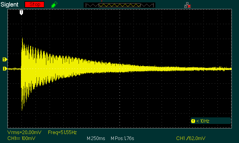

Let's take a closer look at one of the waveforms from Elliott's page. I picked one that displays several typical characteristics shared by other waveforms on that page.
Elliott says that the vertical scale on all these images is 100mV/division, and the horizontal scale is 250 mS/div. From initial trigger point to the end of each waveform is 3.75 seconds in every case.
Here are a few observations:
1) Initial amplitude is around 500 mV peak-to-peak.
2) The waveform is quite asymmetrical. The initial negative peak is at around -300 mV. The initial positive peak is around +200 mV. The signal is offset below zero volts.
3) One second into the waveform, it's offset the other way - more amplitude above the zero-volt line than below it.
4) The initial amplitude is enormous compared to the amplitude after 3.75 seconds. At the start, the signal is about 500mV peak to peak. At the end, it's too small to make out clearly, but appears to be roughly one small "tick" of the vertical scale - that's 20mV peak-to-peak.
This means the signal starts off 25 times stronger than it ends. That's 28 dB stronger at the start than at the end.
5) There are multiple frequencies present. This can be very clearly seen in the first 0.5 seconds - look at the "beats" in the amplitude. Also, you can see "kinks" in the envelope, as different frequencies die away at different times.

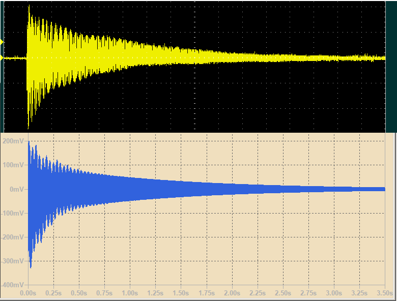

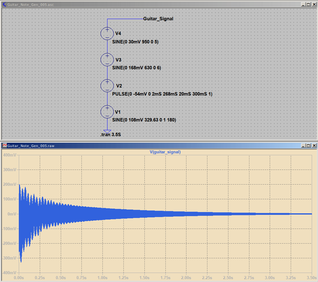

The next question is: What happens if we feed this guitar signal straight into an op-amp, set up with a little voltage gain to act as a preamp?
In order to answer that question, I quickly designed a circuit that could detect and display if clipping had occurred. But lacking tons of spare time to build that circuit, I thought it worthwhile to see if I could use LTSpice to simulate the problem.
To do that, we have to start by teaching LTSpice how to create a signal that looks like a typical guitar pickup signal.
This took a fair bit of tinkering (more details soon), but here is the outcome. The yellow trace is Rod Elliott's 'scope capture. The blue trace is from my simulated LTSpice source.
I've scaled both graphs to the same volts/div and time/div, and same physical size, so you can easily compare them by eye.
The blue (LTSpice) waveform doesn't fully reproduce every nuance of the real thing, but I think it captures enough of the salient features to give us a solid starting point.
Note, in particular, that the blue waveform is also asymmetrical, just like the actual guitar signal.
-Gnobuddy
Thanks, Nigel!
Good point about pick vs fingers; easy to hear, but I've never thought to record and compare the two waveforms.
I found that I could get close to the representative Rod Elliott waveform by stacking four LTSpice voltage sources in series. One of them is the fundamental at 329.63 Hz (open E on the first string). I added two overtones at frequencies near 660 Hz and 990 Hz, tweaking the frequencies until they produced beats similar to the ones in Elliott's wave capture.
All three sine voltage sources are exponentially damped. I arrived at the decay time by trial and error, to closely match the reference (real) guitar signal.
To generate the asymmetry, I added the fourth source, a slow-going negative pulse that pushes the entire waveform negative for the first few hundred milliseconds, to match the real guitar signal in Elliott's scope capture.
The combination of all four LTSpice voltage sources generates the blue trace in the image I posted previously. It's a pretty good match to most of the features of the Rod Elliott guitar waveform.
Here is my LTSpice circuit. First a screen capture, then the actual sim file (LTSpice .asc file), in case anyone wants to tinker with it.
-Gnobuddy
  • Guitar_Note_Gen_005.asc

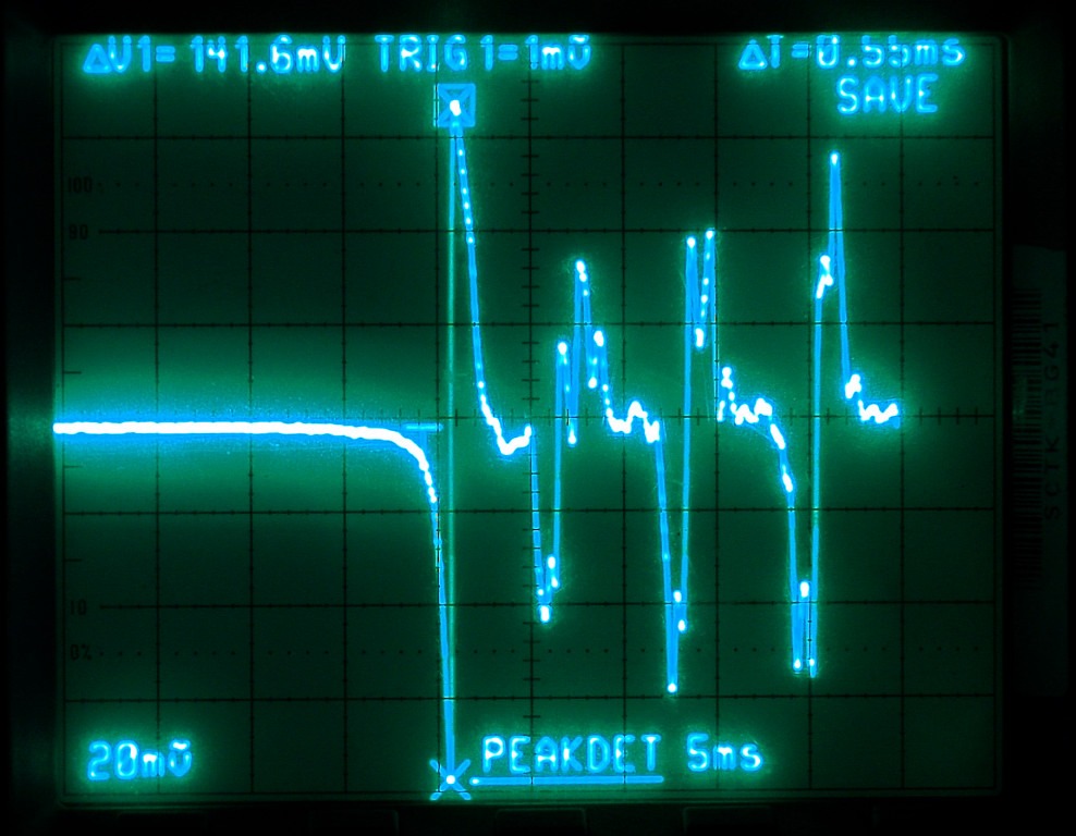

When I got my first analog scope I took a look at the guitar signal of my strat. I learned that the initial peak vastly depends on your playing technique. Hitting the strings firmly I achieved upto 2Vpp with the single coils. This may rise to about 5Vpp with a "hot" humbucker. So I did some listening tests while watching the scope and found that in fact a certain amount of visible hard clipping was not audiblte to me - not so surprising as the percussion click decays immediately to moderate levels. On the other hand my personal playing style is not so extreme, so there is less danger for hard clipping. All in all Gnobuddy confirms my ancient observations except the fact that he seems to be more sensible to short, hard clipping occurence.

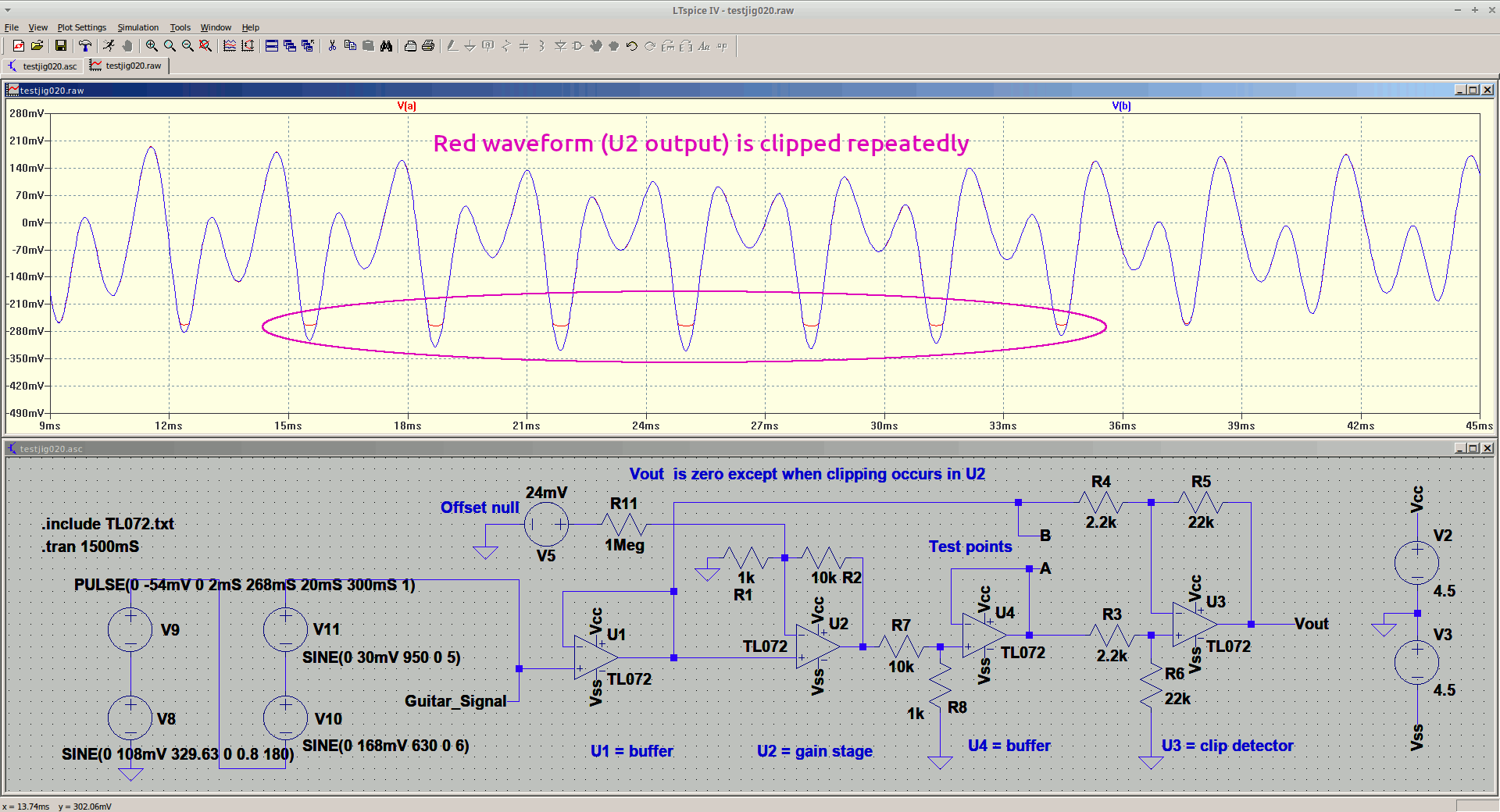

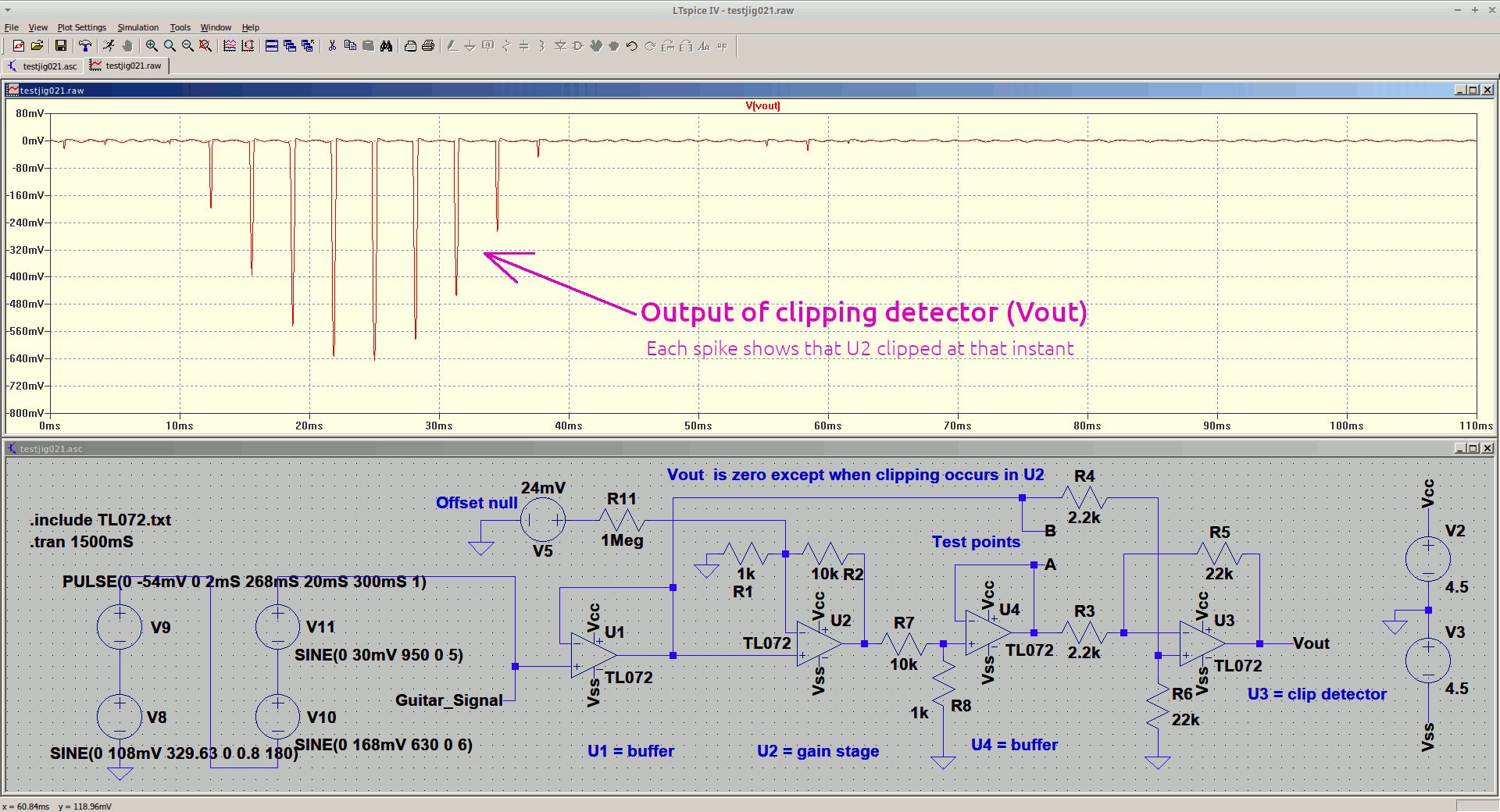

Thanks to everyone who's chimed in. It's great to have your participation and shared ideas!
I have some responses to some of the posts, but I think it's time to get back to the simulation that started this thread, so I'll do that first. :)
I anticipated that any clipping might be brief and hard to spot in a graph, so I designed a clipping-detector circuit. I'll go into more detail on that in a moment.
In LTSpice, I started with a unity-gain buffer (a TL072), because we're going to put a heavy load on the signal later. Running on the usual 9V supply (i.e. +/- 4.5 rails) I figured a unity gain buffer won't clip with the Rod Elliott reference signal as input.
As we've seen in this thread, several people have seen more than 3V peaks out of their guitars. If one of those signals was used in the simulation, even a unity-gain TL072 will clip! A TL072 running on +/- 4.5V DC rails clips at about +/- 3 volts at its output.
From the buffer, the simulated guitar signal goes to a second TL072 op-amp, configured as a non-inverting amplifier with a gain of x11. Feedback resistors (R2/R1) are 10k and 1k. This is the circuitry around U2 in the attached image.
The output of U2 is then fed to a resistive attenuator consisting of R7/R8, which have the same values as the feedback resistors R2/R1. This divides the signal down by a factor of eleven, exactly cancelling the gain of U2.
If U2 does NOT clip, then this signal should be exactly identical to the input - amplified eleven times, divided eleven times, so back to exactly the same as it started.
U4 buffers this signal. It's output is test point A in the schematic.
Test point B is the guitar signal straight from the unity gain buffer (U1).
If U2 never clips, then the signals at test points A and B should be identical.
So I ran a sim and plotted both signals, overlaid on each other.
As the attached image shows, the two signals are not identical. The signal at point A is repeatedly clipped during the first 100 mS or so.
The effect isn't as subtle as I had been expecting. With the two traces overlaid in different colours, it's quite easy to see the clipping on the graph. In other words, the clipping problem is much worse than I had thought it would be.
Keep in mind, this is a very conservative simulation. The simulated guitar signal is quite a conservative one (a single string, picked with average picking force). U2 is set for a voltage gain of only +21 dB (i.e. x11). Clipping would be far worse if a chord was played (rather than a single string), or if U2 was set for more than 21 dB of gain, or if playing intensity was increased, or if thicker-gauge strings were on the guitar, or if the guitar pickups were higher-output types.
-Gnobuddy
On to the clipping detector.
In the attached image, U3 is configured as a differential amplifier (along with R4/R5, and R3/R6) with a gain of 20 dB. Signals A and B are fed into it.
The output of the differential amplifier is the difference between the two signals, amplified ten times (plus small error terms).
So: if U2 never clips, then signals A and B will be identical, and therefore the output of U3 (Vout) will be zero all the time.
However, if U2 clips, then A and B are no longer identical at that instant, U3 will amplify the difference, and Vout will be non-zero.
In a nutshell - if we see anything other than zero at Vout, that's clear evidence that U2 is clipping.
As you can see from the image, under these particular test conditions, Vout shows that U2 clips quite a lot during the first 40 milliseconds or so.
There are many guitarists who can play 25 notes per second, in which case each note only lasts 40 milliseconds. In that situation, there would be harsh clipping for virtually the entire duration of every note played at that speed!
-Gnobuddy
