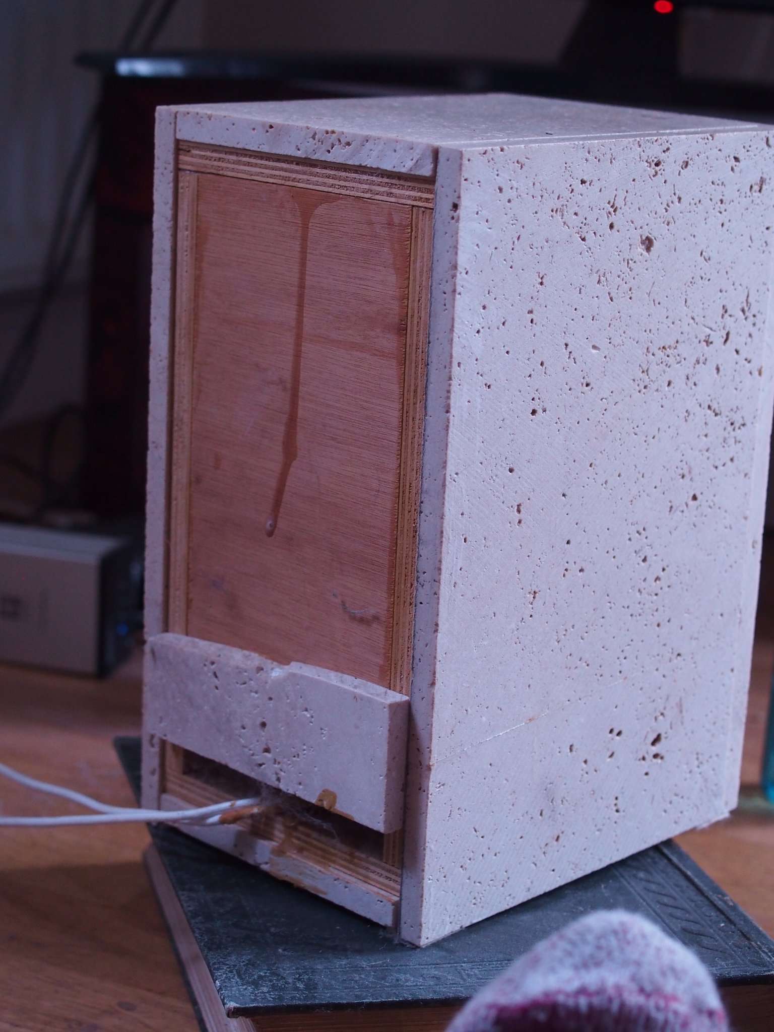

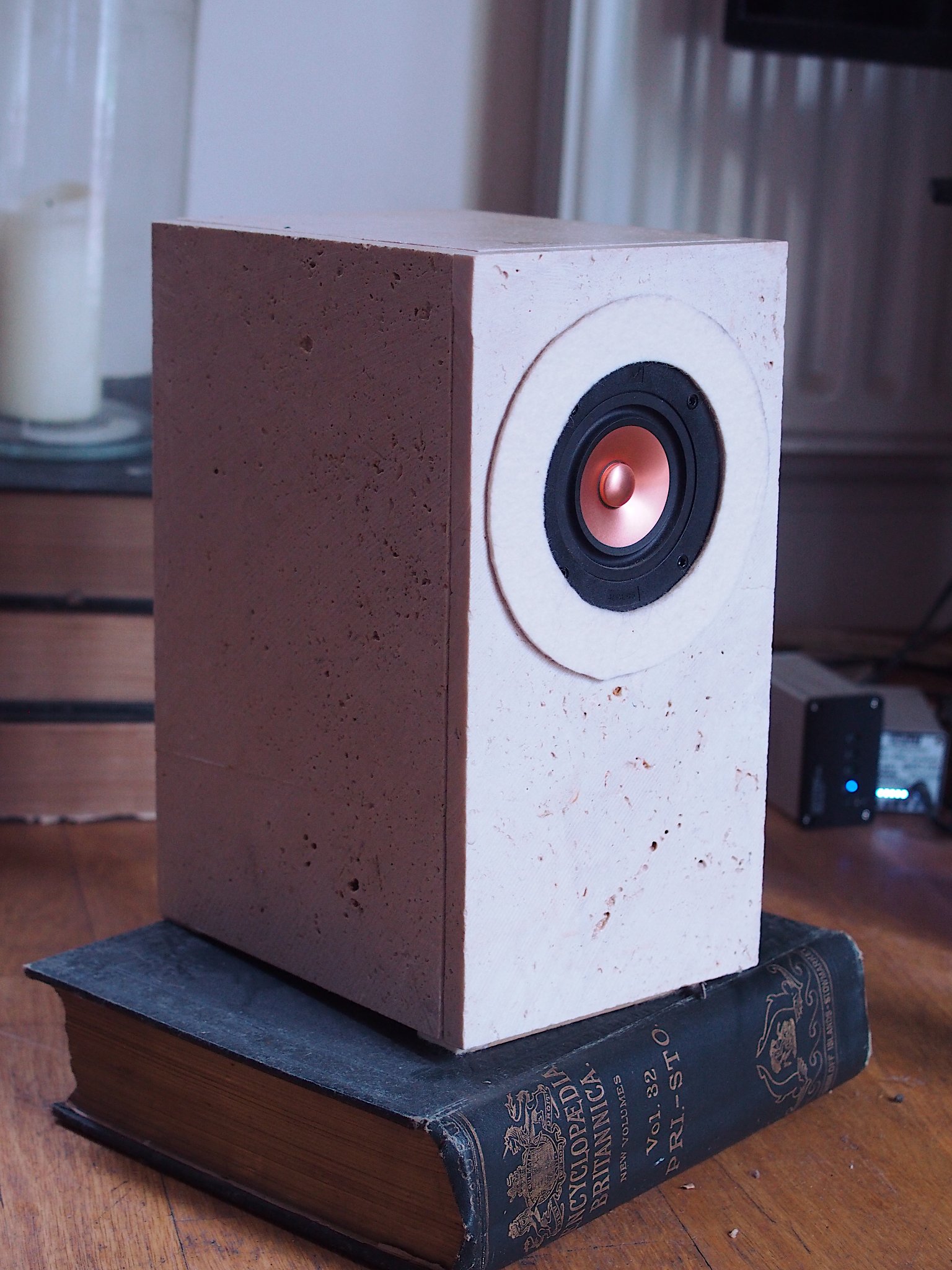

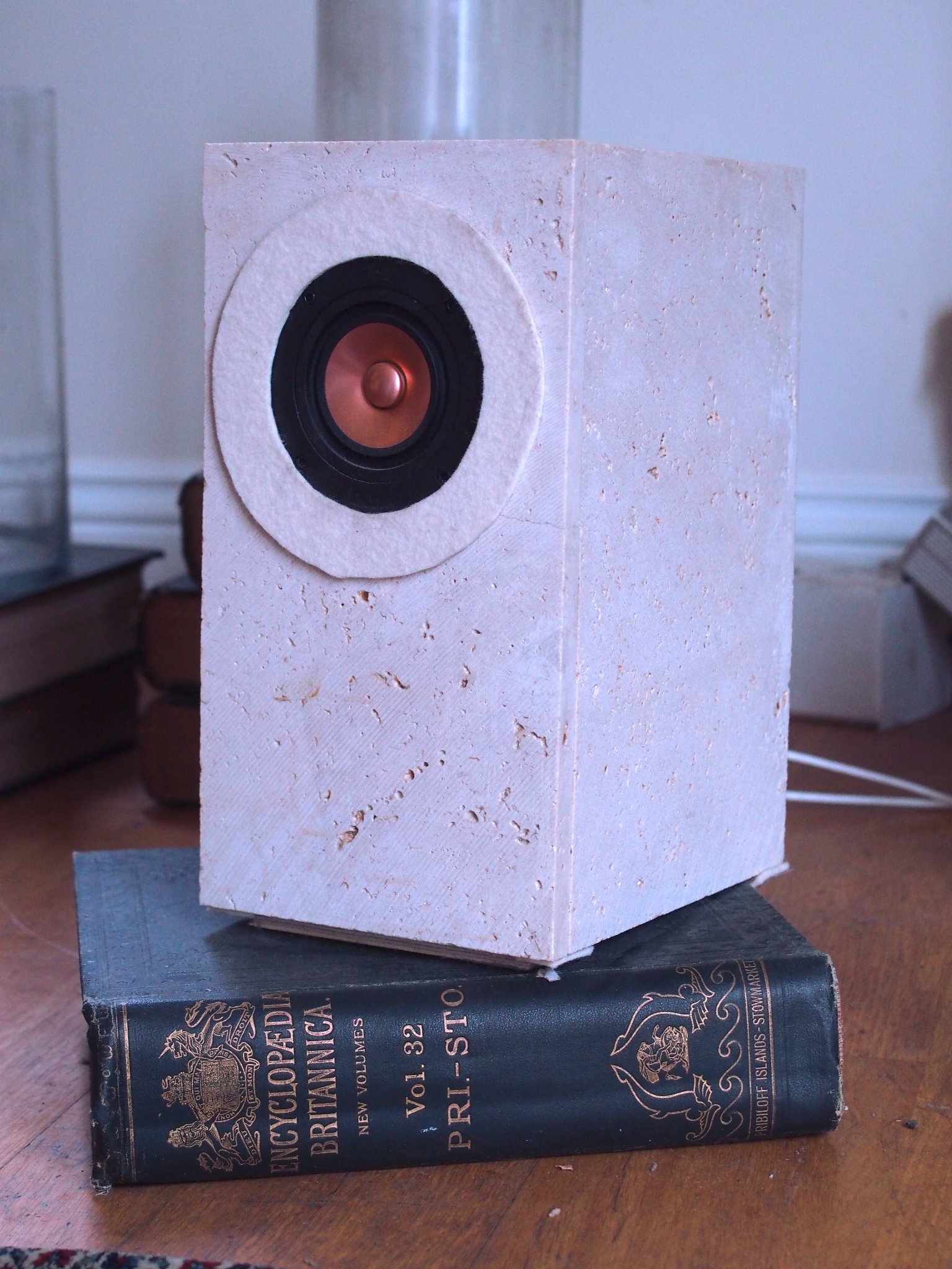

Moving on, I'd completely endorse Pigmy's view, working stone tiles is easier than I thought til I tried, inspired by his posts here. I've built a pair of small Woden Bulldogs for the MA A5.3, in 12mm MDF first as a frame really, then covered with 12mm travertine (limestone) floor/wall tiles. Needed a special wet saw to cut them to size, but the result is v nice and I can detect no resonances whatsoever. They're in daily use, favourite small speakers so far. I'd recommend using stone tiles, they are a consistant thickness, readily available in UK up to 900mm, (mine came off Facebook Marketplace as left overs from someone's new bathroom), can be cut with the right equipement (my wet saw was only a cheap one for £50, a better one would make the job even easier and can be hired from most tool hire shops), and the cabinets are totally solid. Just don't drop one on your foot.
Floorstanding the weight might start to become prohibitive, though having seen the results I'm still tempted to give it a go.
pics to follow, though they're none of them as nice as the big slate and leather jobs.
Reactions: androxylo

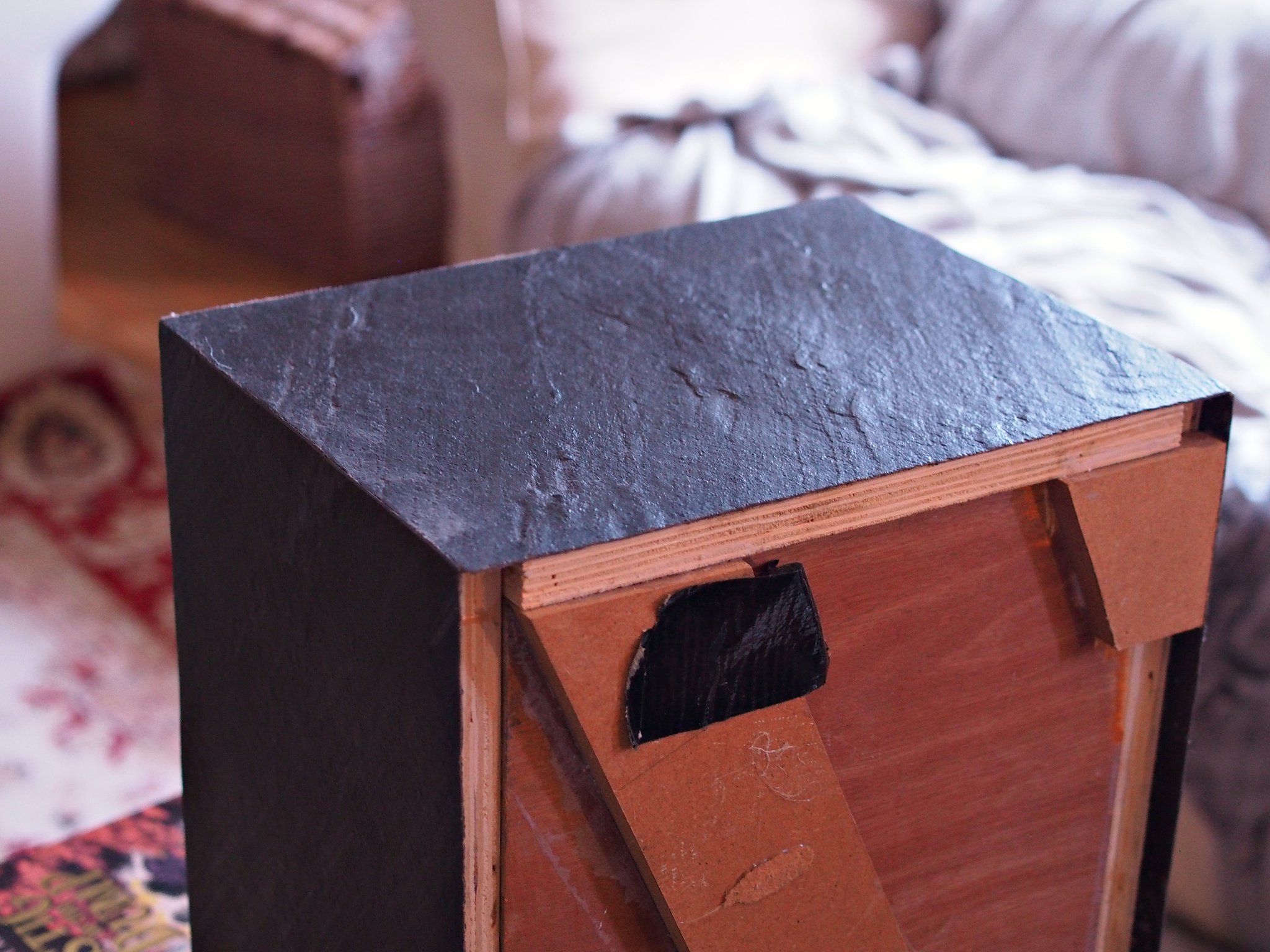

Pictures as requested. Constructive criticism welcome. The ideas are often better (!! or possibly not) than execution. I've included the ugly back to one to show the random exterior anti resonance bracing.
The travertine tiles used on the MA 5.3 have the holes filled on one side, that's the side usually exposed in bathrooms etc., but I preferred the holey side. The felt circle was an anti diffraction something I'd read, whether it makes any difference is doubtful.
Driven at the moment by a Temple Audio Bantam Gold, lovely little class D made in Manchester.

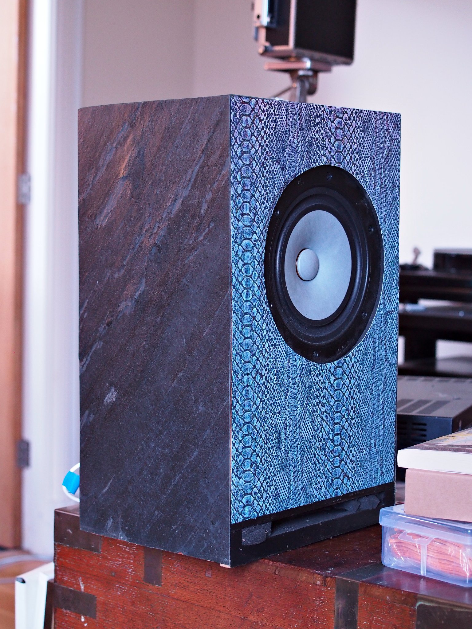

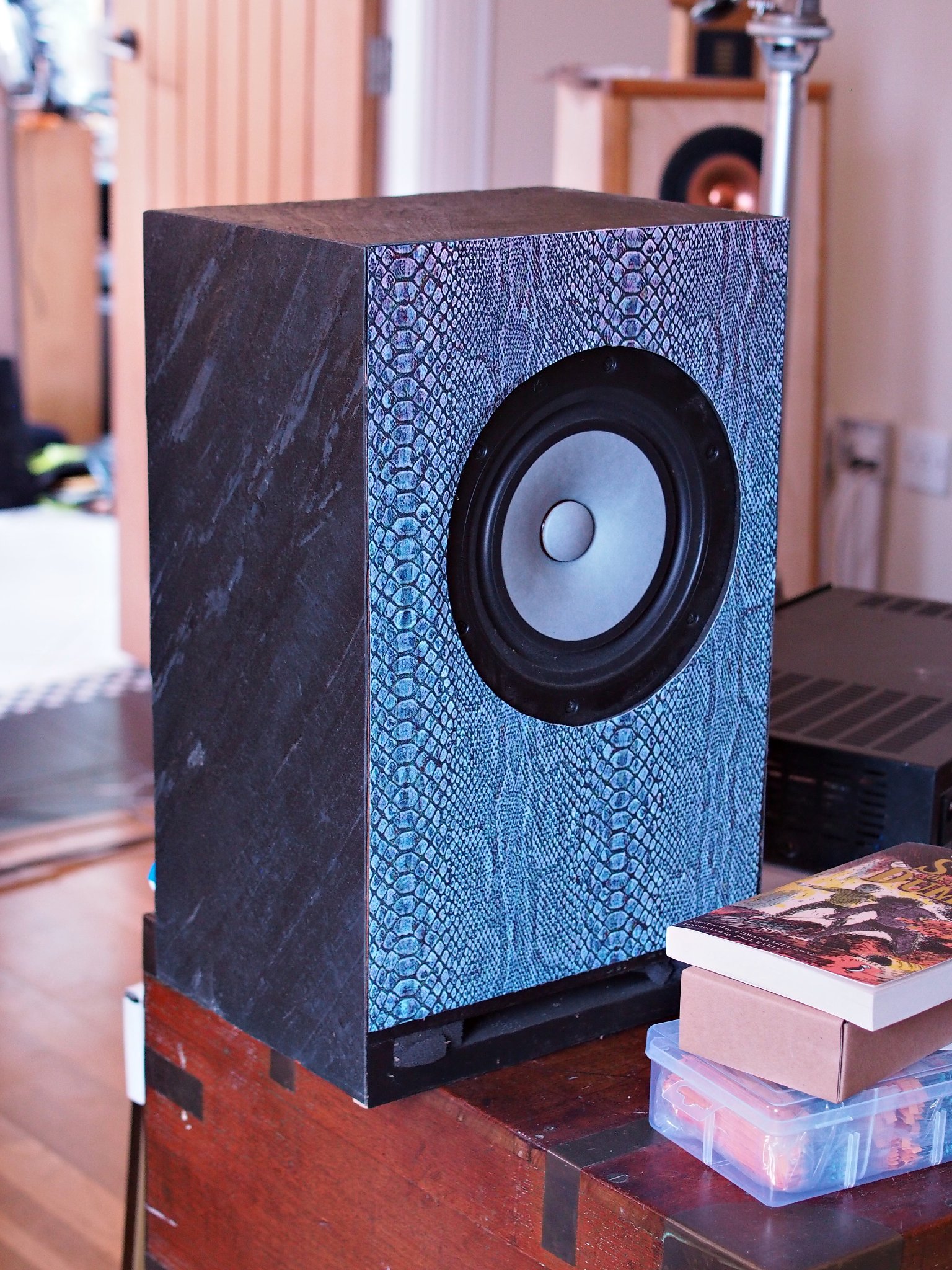

The MA 12pw's were even more of an experiment. The box itself is far from ideal but it did demonstrate just how good a driver the A12pw is. I've some more to build boxes for next year.
Again the finishing could have been better, looking at them again to photograph drives this home. The slate veneer has a nice uneven surface. It can be a b****r to cut cleanly, but a sander takes off surplus fairly easily. Finish with a stone sealant, though a water based acrylic varnish would likely work as well. There are a number of different stone finishes available, red sandstone is tempting.
The baffle covering was another experiment. It is injet canvas printed with a snakeskin pattern and given multiple (5 or 6) coats of water based acrylic varnish, ends up a little like thinner vynyl flooring. Makes the eyes go funny in some shots, but paint can be boring after a while and the colour matched the cones, imo at least.
These had a surprising WAF, having got them down to take pictures they were described as "retro" and "quite nice", and are preferred to the FH-XL s in the background (I suspect because they're smaller though).
