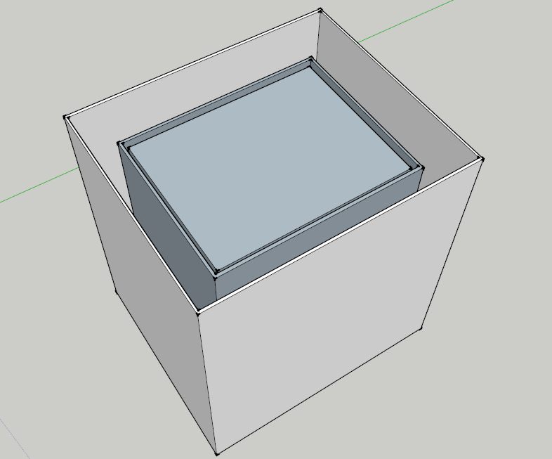

One way to bond the skins together is to use spray foam as the core - it will adhere to the skins as it is expanding and curing.
To construct this way you can start with the inside, a complete rectangular box made of pieces of flat sheet metal and epoxy the seems together. Then use 6 more sheets that are slightly bigger than the first ones and glue those onto the box with silicone, making the layer of silicone about 1/16" thick. Last build a bigger box, about 1" bigger all round than the inner box but leave the top off so that it can be filled with spray foam.
Fill it with spray foam, let it cure for a few days then cut off the excess from the top and glue on the metal sheet that forms the top.
Sounds like fun. 🙂

Here's an interesting panel building method:
It has 2 skins, bowed away from each other. The skins could be 1/4" hardboard and the space left between could be filled with spray foam. The advantage for this is vastly increased stiffness and the loads would be transfered and concentrated at the strongest part of the box - the corners.
No need for internal bracing.
It would make for an interesting build but it might be worth the effort.
BTW, what happened to Dave? He ran away?

If you built up your tapered foam panels by clamping them on a flat table you could have the inner layer flat and easy to assemble and the outer layer bowed out
Hi Mark,
I see that layer of Corian as being stiff enough on its own. The advantage of a sandwich is high strength, stiffness in a lower weight panel. Using a heavy, stiff core negates that advantage. There is some benefit at some frequencies due to the layering of different materials.
I thought about doing the panels flat on one side but I couldn't see any advantage to it. The flat part would need to be a stiffer (most likely thicker material to withstand the tension from the other skin, even if it was clamped in this position while the glue dried. The addition of ribs to the mix to ensure the flat side stays flat would complicate the construction quite a bit.
And lots of disadvantages. You are going about it the right way. My only concerns are possibilities of the foam having its own parasitic resonances. The only way you are going to find out is to build it. I am following that thread with interest.
