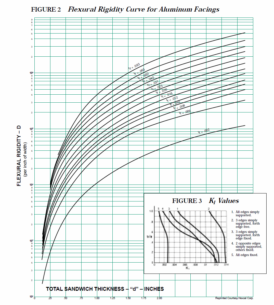

That's roof flashing - maybe 22 gauge and not really thick enough for this. You'd want at least 16 gauge for some rigidity.
Thicker is better. If 22 gauge is 0.0253" and 16 gauge is 0.0503", based on the graph below, for a 1" composite panel (foam filled) the flexural rigidity values are about 120,000 and 230,000 respectively. The best plywood would come in at about 165,000 for 1" thick but is way heavier. This is why aorplanes are built out of these kind of panels.

Where do you find all of this data? You are good with the research 😉
I knew a metal skinned sandwich was stiff but I had no idea it was that much stiffer than a comparable thickness of plywood - wow!
