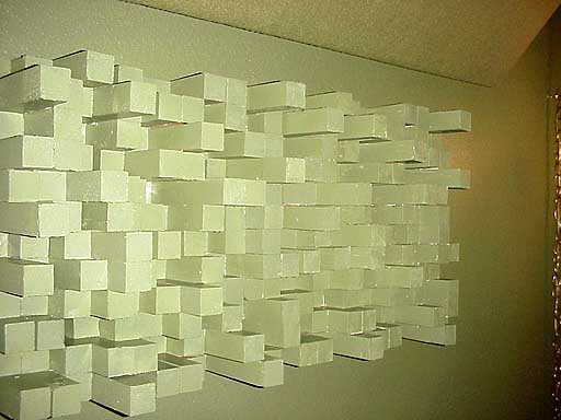

Thanks Ed for a great contribution. I saw the BBC paper or had seen the Schroeder design sometime in the past and I've used a room before in a studio with that type of diffuser. To my ear they seemed to work well. Someday I'm going to build a few panels for my house. That calculator you found is great!
Anyhow that idea of the square shapes is in the mix. If you think of anything else post it.
Another paper I've found is from RPG Diffusor Systems, Inc.
http://www.rpginc.com/news/library/tyndall_paper.pdf.
My brain is getting a workout! :yikes:
Good one Ed, but my old lady would pitch a fit if she had to dust many of those!

I was thinking of its use inside the enclosure as well. My reason for asking was that cutting up hundreds of pieces of mdf would be tedious in the extreme and the benefits not worth the effort, perhaps. However...............flooring insulation comes in 50mm dense sheets. Model airplanes are made of it. Blue foam by Sheffield Insulation in the UK are the largest suppliers I believe and there will be an equivalent in your neck of the woods. This dense foam cuts with a hot wire very quickly and with a good surface. Admittedly it is not lossy, but it does have lots of very tiny "bubbles". It is light and will glue to itself or wood with regular PVA glue. It would be relatively easy and quick to make up some panels to insert inside the enclosure. Just a thought.

Yes, Styrofoam. This is a definite possibility. Might work better than MDF, and certainly easier to cut (I'd still cut it on the table saw). One drawback is that it will add nothing to the overall rigidity of the panels, unlike a solid like MDF.
