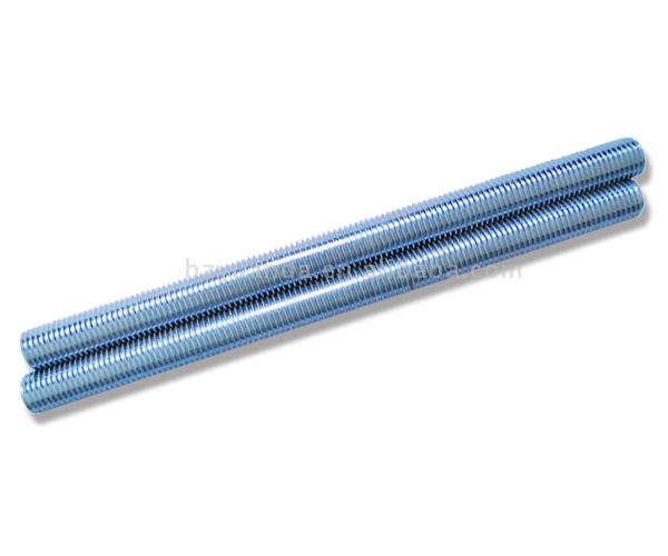

Another topic I'm coming in late to, and I'm not sure if this has been mentioned, but, along with using damping and bracing, I use threaded rods in my speakers occasionally. Using a couple of these along with washers and nuts inside and out of the cabinet will arrest just about any cabinet vibration.
Also, moving the inner nuts closer together (farther away from the outside of the cabinet) allows you to adjust the rigidity of the wood by flexing it taught.
You can make some interesting adjustments this way. Just my two cents.

DoctorDyna said:I use threaded rods in my speakers occasionally. Using a couple of these along with washers and nuts inside and out of the cabinet will arrest just about any cabinet vibration.
This can be very effective. By stress loading the panels you are making them slightly curved and significantly increasing stiffness... it does take some effort to design around to get a stiff box... the threaded rod can also serve a dual function when used to bolt together the bezels of a push-push pair.
