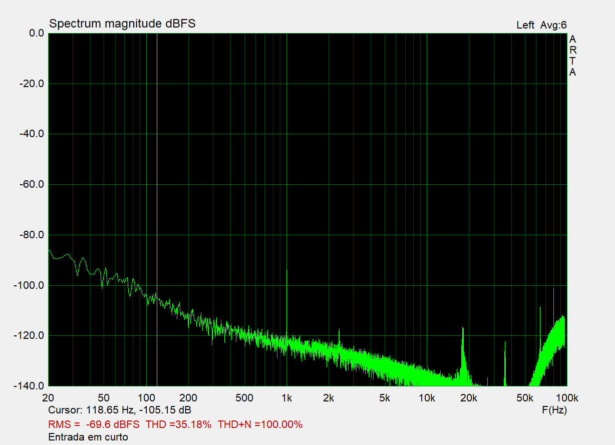

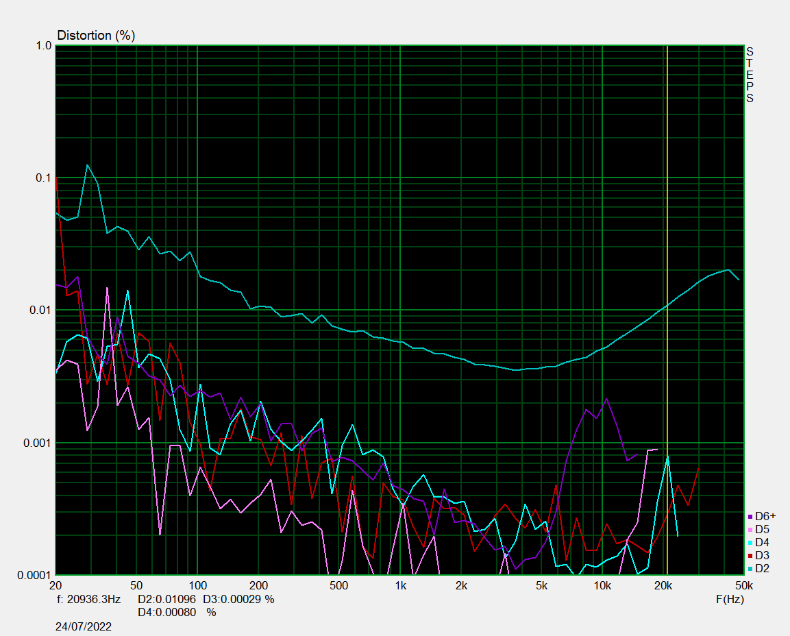

Time for some measurements (in fact, it are save in my PC time ago, but now I see I not lost it ;-)If people want to play with cascoded germanium, here is a circuit that I've made, with excellent results, sonically and technically.
Now the pre was with a friend of mine and he is very happy! Far better (in his words) than other preamps he tested against, including commercial ones.
I recommend!
PS.: the input bootstrap 4u7 capacitor needs to be at 390R side (my drawing here show options).
Shorted input:
The 1kHz residual are from the gig this time.
Inverse RIAA:
HD vs freq (sweep using inverse RIAA):
Results from my schema quoted here.
The actual owner continues loving it. Great sound.
