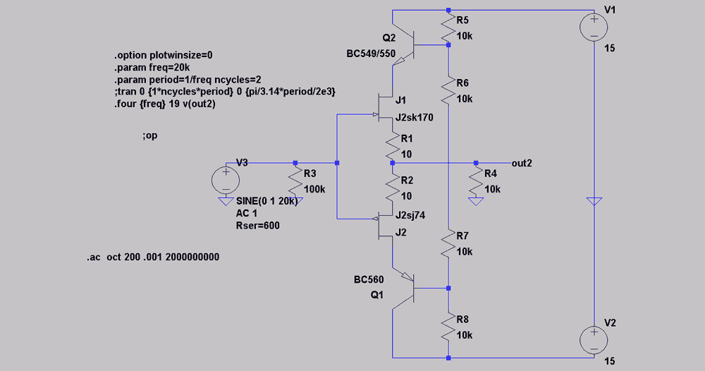

-3dB BW is around 8Mhz witout c, and *worse* with cascoding (5Mhz)
3rd and higher order harmonics rise at an order of magnitude, 2nd is the same (and dominating).
all simulated.

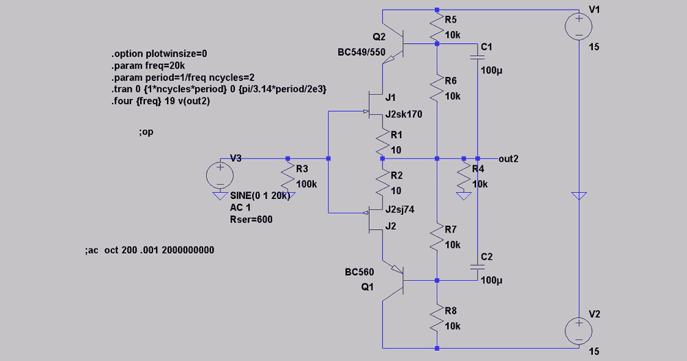

oops..
but this one is an order of magnitude *better* EDIT: only with high freq (20k), 20Hz is still better without cascode!
Just an simulation trick without any connection to the real world?
Rüdiger
