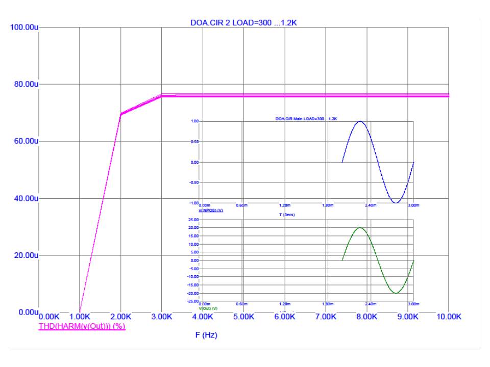

Anyway 600 ohm was my target.
When I use my own favorite output stage it looks good down to about 150 ohms.
The picture shows THD with load stepped from 300 - 1200 ohms. (at 40V pp)
Stein

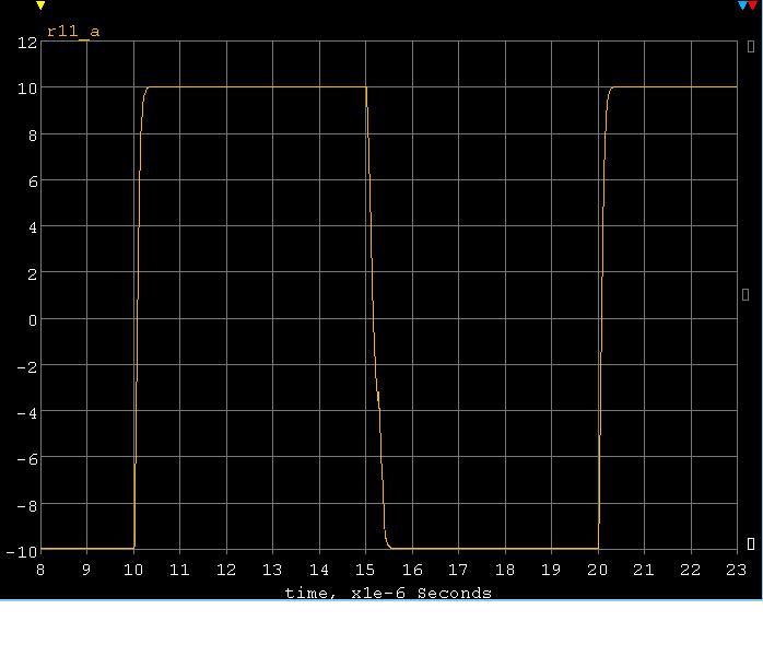

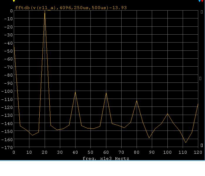

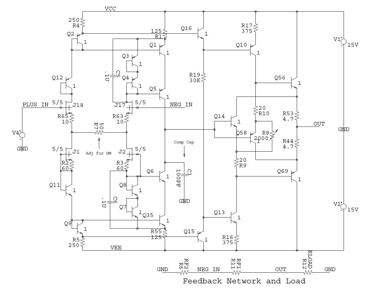

Here is the first output buffer that was simple enough without compromising performance. I'm still looking at G = 10 and up performance because there is a some fine scale work needed to insure stability at low gains. Also as bcarso points out there might be an opportunity for power on latch-up so there might be a simple clamp needed somewhere. I don't think this is a big problem.
The output stage is biased all the way back from the input (via Q15 and Q16). If you follow the signal path this gives a feed forward slew boost directly to the output, unfortunately this only works in both directions if one of the fully differential input stages is used.This idea appears in many current feedback amps and this single gain stage approach provides the same opportunity. I will eventually repost all three ideas for input stages including this output stage. The other two versions were the Rush cascode and the complimentary version with hard to get FETs.
All versions rely on the input biased at 5mA per side. R8 provides trim of output bias which should be at 8mA. This gives a total supply current of 25mA. R19 should be chosen to give ~1mA for the supply voltage used. The values of R7 and C1are open to experimentation to vary GBW product and slew rate.
Nothing is chiseled in stone I'm sure there are numerous choices of devices that will work. At this waystation things look pretty good for G = 10 and up, 600 Ohm and 1000pF drive. Considering all the diode connected transistors could just be diodes there are only 16 or 18 active devices needed.
Attached are 20k 20V p-p THD and 100k square wave response (600 Ohm load)
