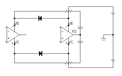

what is the best way to bootstrap my headphone amp circuit for higher voltage operation instead of using higher voltage transistors?
One option would be a floating supply with the mid-point driven from a HV opamp like the OPA453 IIRC.
One limitation to that would be the input stage; you can't lift the V- above ground because then the input stage gets into trouble.
But it should at least give you double the voltage range (also depends on your amp gain).

How much higher ?what is the best way to bootstrap my headphone amp circuit for higher voltage operation instead of using higher voltage transistors?

split 48vdc or +/- 24v. maybe slightly higher for losses due to heavy local nfb resistors used in amp circuit.How much higher ?
[using +/- 12v now]

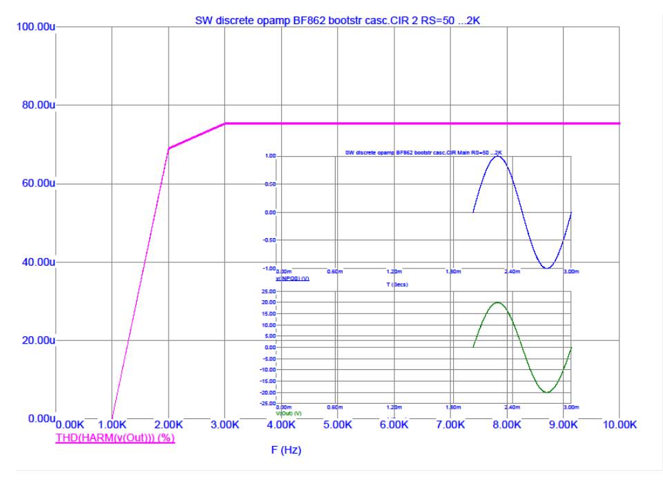

SW discrete opamp BF862 (post 135).
I have put in bootstrapped cascodes on the front end and 5401/5551 as the cascode BJT's in the "VAS", so there is no problem using the circuit at higher voltages.
As you can see in the attached file I have stepped the source resistance from 50ohm to 2kohm and there is almost no change in THD.
It is possible to improve the circuit, but it is rather pointless to design a perfect front without using a relevant output stage.
So in order to move forward we must, among other things therefore agree on the load.
600 ohm or 30 ohm?
BTW: Maybe the circuit needs a better name than "post 135" or maybe not?
