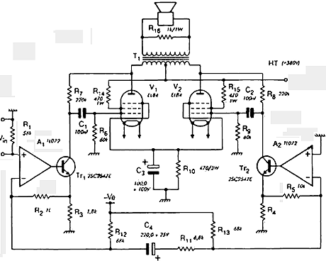

I found one more interesting discrete opamp. Looks like an instrumental amp loaded on output transformer. V/I converters drive controlled by current common cathode stages with deep feedback by voltage. However it is power amp, but can be used as line level output stage with smaller tubes. Thanks to transformer output can be balanced, for professional studio usage.
Tie R3, R4 together and change to cascoded jFEts? Change pentodes to low power triodes = line stage.
