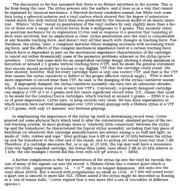

I'm certainly not an expert, but it does vary enormously with stylus shape. A phono stylus actually traces a path that includes a fairly "liquid" medium. Contact pressures are in the tons per square inch, and operating temperatures are somewhere in the 400 degrees F range (some say higher - I have no way to measure). A stylus shape that elastically deforms the vinyl less will measure as a higher resonant frequency.

The attachment is from the March 1977 BAS meeting, reported in:”THE B.A.S. SPEAKER” Volume 5, Number 7, April 1977
George

I've seen that 400 degree temperature thing being thrown around before. Any idea if anyone actually measured this or if it's one of those legends-that-won't-die? It frankly doesn't make much sense.
It's a really big number fersure, and I've heard bigger, even 700F. You're gonna make me do my homework on this, aren't you? Fair enough, I'll see what I can dig out. Might be in one of the Tomlinson H papers; I'll look there first anyway.

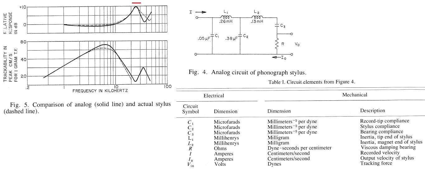

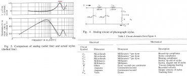

The upper curve of fig. 5 bears a striking resemblance with the curves that Joachim showed. The peak (it is a peak Joachim, sorry for the noise!)is due to tip-record interaction/resonance. From the following article:
http://shure.custhelp.com/ci/fattach/get/29245/

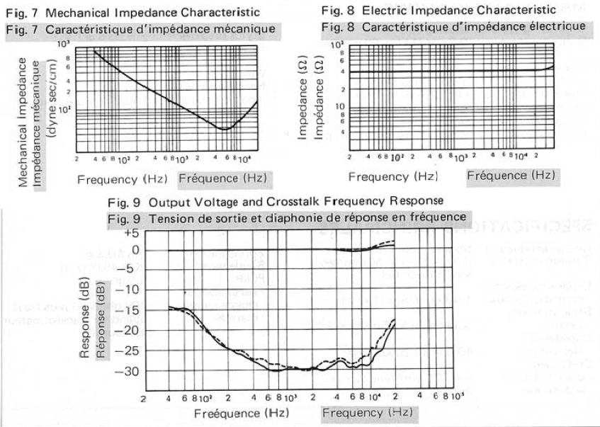

The trackability curve which draws as the inverse of the mechanical impedance of the tip is a very indicative figure. I havn’t seen many manufacturers show such curves (Denon publish mechanical impedance curves, see DL-103 attachment 2, but limits the data to 20KHz, while the resonance is above it.)
