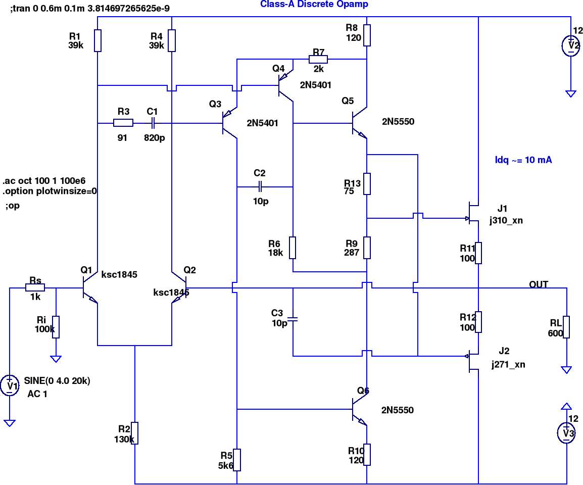

No, please do NOT use those devices: Use J113, J175 devices.
OK, I need to dig up the Spice models of the J113/J175. Meanwhile, I plugged in the J310/J271 instead as the output stage of the venerable Melcor 1731, and it doesn't look terribly bad for 6+2 actives: GBW of ~3 MHz. Degeneration can be added, LTP compensation changed, etc., to improve this.

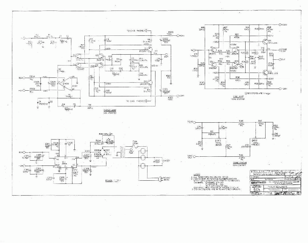

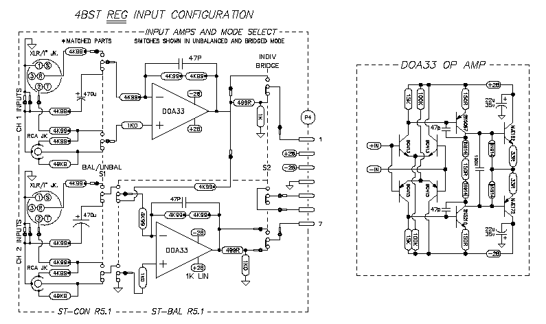

I was wondering when someone was going to grab one of the professional discrete opamps. API2520 anyone? DOA-12, DOA-17 from Five Fish... etc.
Maybe we should make it fit the pro plugin format of 1.1" square? :eek:
Fortunately for me, I don't know what this means! :D
(except that it sounds bad)
Da#n..I was sipping coffee...:D

I would assume that the input differential pairs would be monolithic if possible. For example, I know that I can get current mirrors (SMD) that are in one unit with 3 really tiny tabs. I do know that PNP and NPN transistor pairs are available as one unit also, but I do not know if jeft's are available like that any more. So, maybe have to change the circuit to bipolar inputs in order to take advantage of monolithic construction and stability? somebody? anybody?
I'm virtually certain that the two DOA's from Five Fish use monolithic transistor pairs at the input stage. I'm just not sure about getting complementary sets (I mean an NPN monolithic pair that are a complement to another PNP monolithic pair).
I've posted this link before and got no responses.
Linear Integrated Systems - Products
They make monolithic transistor pairs but they don't say if they are complementary sets.
If not, then the topology for the DOA has to be changed.

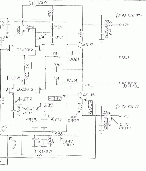

The JLH design in #306 is an interesting and useful design, both to talk about, and to upgrade to newer devices.
The original parts made by Motorola were available since the very late '60's and were the FIRST 'complementary' pair easily available. I used them for complementary jfet followers in 1970, and within a year developed the complementary differential jfet input stage with them. However, by 1972, Siliconix came out with better, higher Gm devices that appear today as the J113 and J175, derived from the NC and PS geometry that they developed. Unfortunately, due to mobility differences between the N and P channel material, the N channel jfets had about twice the Gm as the P channel.
Later, much later, when Toshiba introduced its line of complementary fets, they compensated for this by making the P channel larger to get a better Gm match, losing parasitic capacitance similarity, unfortunately, but a better overall combination, that we have run with for about 1/3 century, and now we are losing out.
