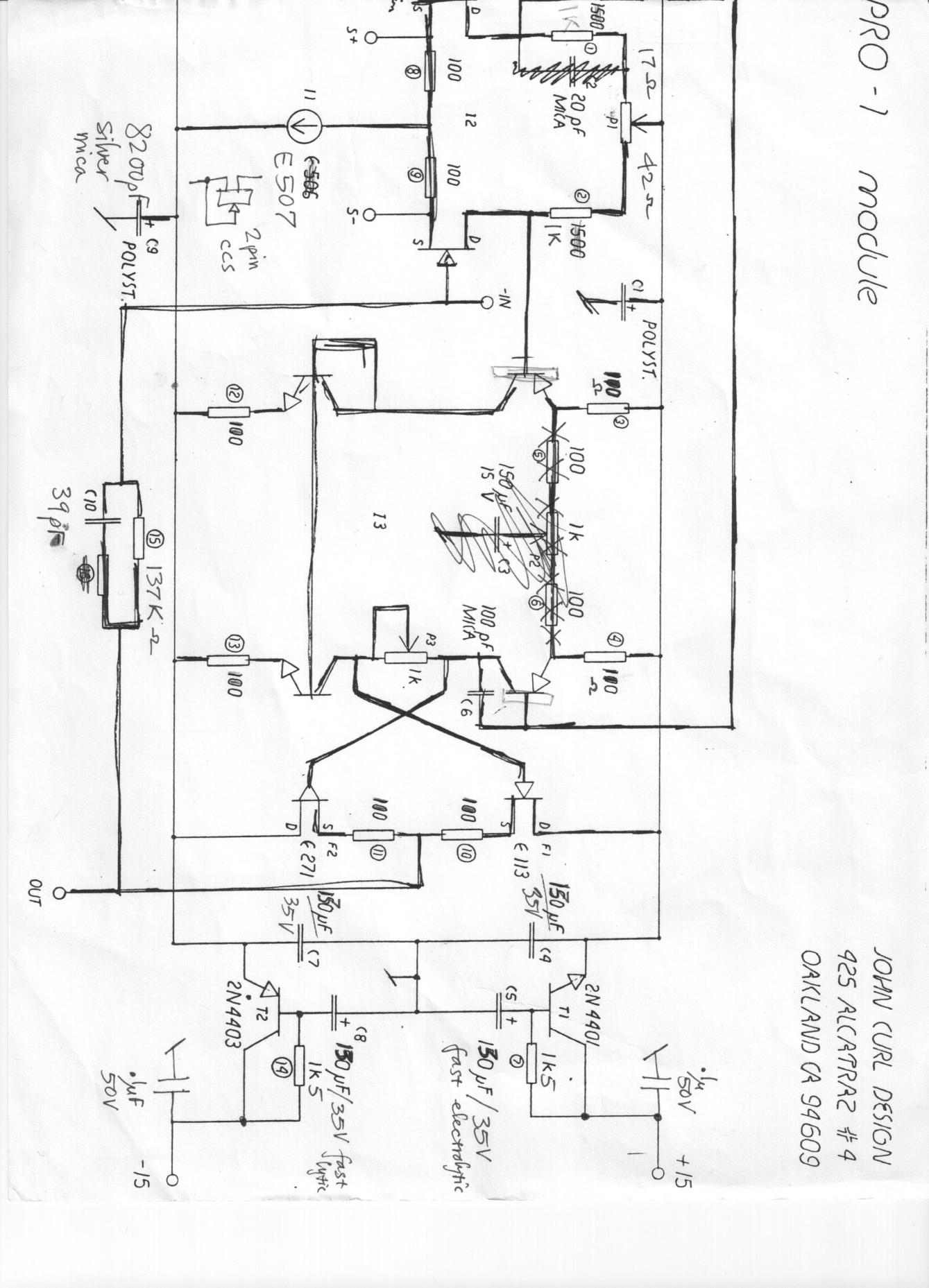

Now why did I choose these devices? They are representative of still available devices that can still be purchased, that Levinson used in the early days. OF COURSE, the Toshiba devices are easier to match, lower noise, and higher Gm. But if you can't get ANYTHING (Toshiba jfet), then alternatives should be chosen.
I would also point out that complementary differential works best when complementary jfets are used. Perhaps a different, single jfet pair, circuit would be best.

This is a recommended alternative to a complementary differential fet design. This design was used in several professional mixers as well as in three 30ips master analog recorders.
sorry about the bad copy, the original schematic goes back to about 1977.

These can be considered ' complementary ' ?
http://www.fairchildsemi.com/ds/MM/MMBFJ177.pdf
http://www.fairchildsemi.com/ds/J1/J111.pdf
Yes, these are the devices. Many manufacturers still make them. However, they have a LARGE Idss spread, so only dumb luck will match the P's to the N's, but that is not very important, within limits. Just good N to N, and P to P is the most critical.
