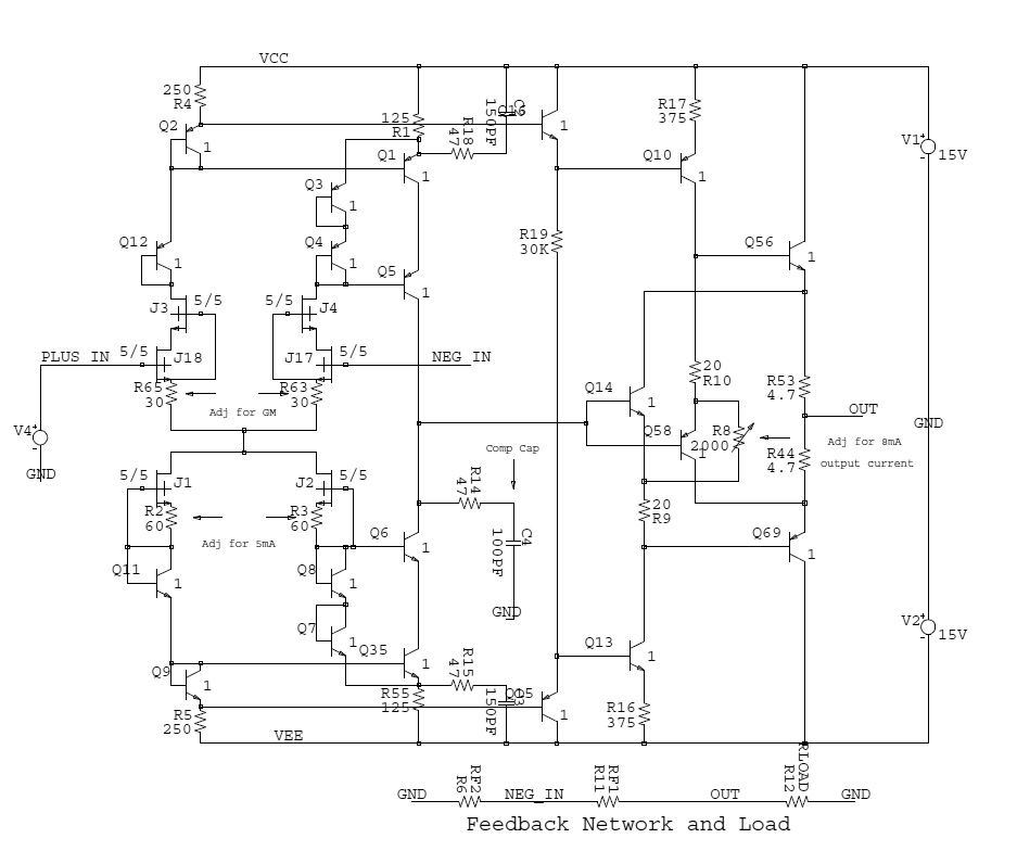

I'm posting what is very near a final [*] design for a JFET 990. Such beasts have appeared in the past so what's different?
[*] in as much as anything which hasn't been built can be called final 😉
Lots of good stuff here, worth a build. We could simplify but let's try it first.

In the above Q3, 4, 8, and 7 can be ordinary 1N914/1N4148. I think your list of posts included the single 1N914 diode needed to catch a power supply sequencing issue (with it there is no need to worry at all). Depending on particular application not all the compensation components are needed and an output Zobel network should be considered for difficult loads.

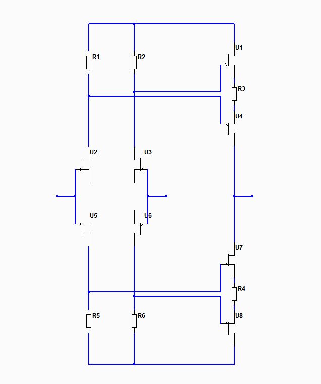

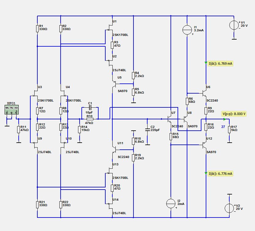

But I have ideas ..... thats a start!
I have one solution regarding OPamp.
It is the link between the input differential and the VAS.
Warning!
I have not seen anyone use this approach before.
Not even John Curl.
This solution can we see simplified in figure #1.
And see it in a working OPamp in figure #2.
There are both benefits and drawbacks.
The benefit it elegantly takes the gain of input stage
and combine it in second VAS into one point.
The drawback is it takes some volts out of Vas stage.
But 🙂 I like the idea very much.
Let's call it Lineup's JFETspecial.
See post #1884. One big issue with the series differential is the matching of devices and/or selection of the common source resistor. But a lot of potential for homebrew.
