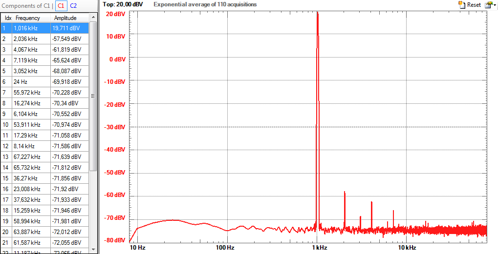

I'll do it! For those who are interested in this little nice toy, here are a few examples of what it can do. Added a very simple jig to have analog inputs and outputs on BNC:

My 239A clone @ 20 Vpp out - given that the clone THD is in the 0.0001% range, it seems that SFDR at ~80 dB is a little lower than expected (and dBV normalization is wrong: for Digilent's WaveForms 0 dBV = 1 Vp instead of 1 Vrms....):

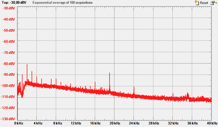

The true 239A thru a double Bainter notch with 40 dB post notch gain (-80 dBV -> -120 dBV) up to 40 kHz- reasonably clean apart from a few hf low level spikes (both the box and the jig are unscreened, but most of the hf noise seems self-generated).

Looks good, thanks. The post notch thing is exactly one of the things I was going to try. I suspect the input null technique would also work well here. I have found the THD of the A/D and DAC's a little more than I had expected. BTW the developer got right back to me (he's actually in Romania).

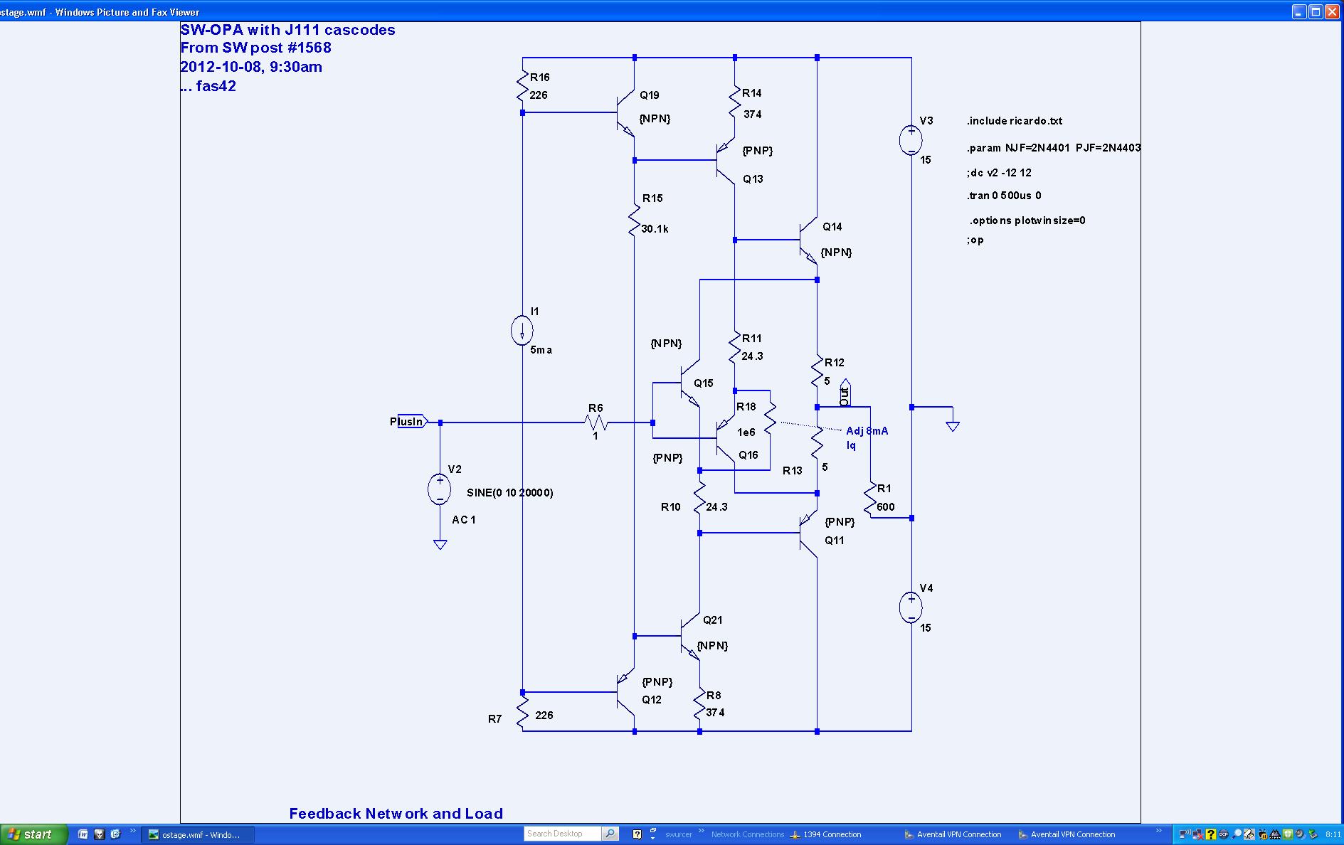

No surprises on the output stage. At no load Gain = .99809, seconds -84dB, thirds -91dB. At 600 Ohm load Gain = .99098, seconds -79.4dB, thirds -80.5dB. Now to proceed to the compete amplifier. I am going to make daughter card for each variant on the input stage and compare with the output being the same.
These results are comparable to the sims, the seconds are a little bigger but that is of little consequence. 0.02% open-loop distortion is pretty good.

Have had a bit of a play with Scott's output stage, trying 4 combinations of BJT models on a 600R load. Not much variation of the 3rd harmonic, about 2 1/2 db. But for the 2nd there was a variation of 10db, tending to confirm for this circuit that this is more dependent on the accuracy of the model, or characteristics of the real devices.

At 8ma of Iq, what class of operation are we in? How far can we push it into class A? Thanks, Ray
Well into class A at 600 Ohm load. Because the collector current of the predrivers is captured you can simply fire it up with the pot zeroed (always turns off the output) and trim measuring the total supply current until it is 8mA greater. BTW you can find the "magic" point where the thirds null, it might make an interesting experiment to adjust the 4.7 Ohm resistors so this happens at ~ 8mA. The values in the above schematic simply reflect what I had in my kit (closest 1% values). We don't stock below 10 Ohms so I simply paralleled two to make 5 Ohms.
A very esoteric point 10k source resistance actually supressed the thirds a little so there must be some vector subtraction going on at the ppm level. So one can see how counter intuitive observations can be made.
