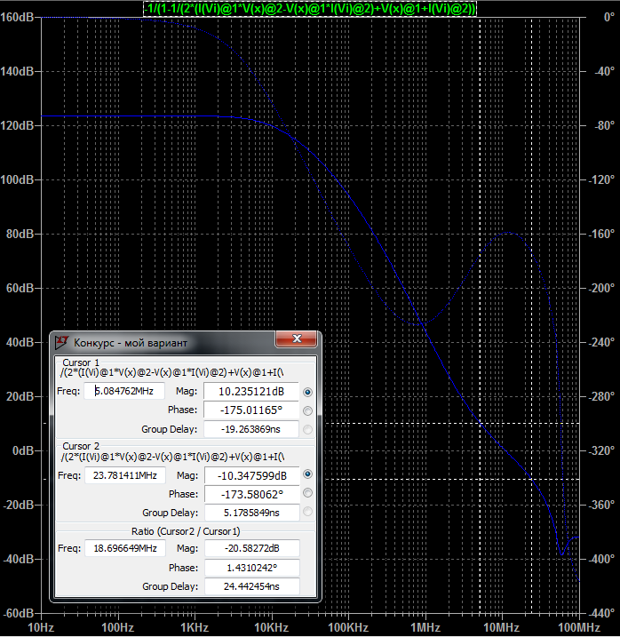

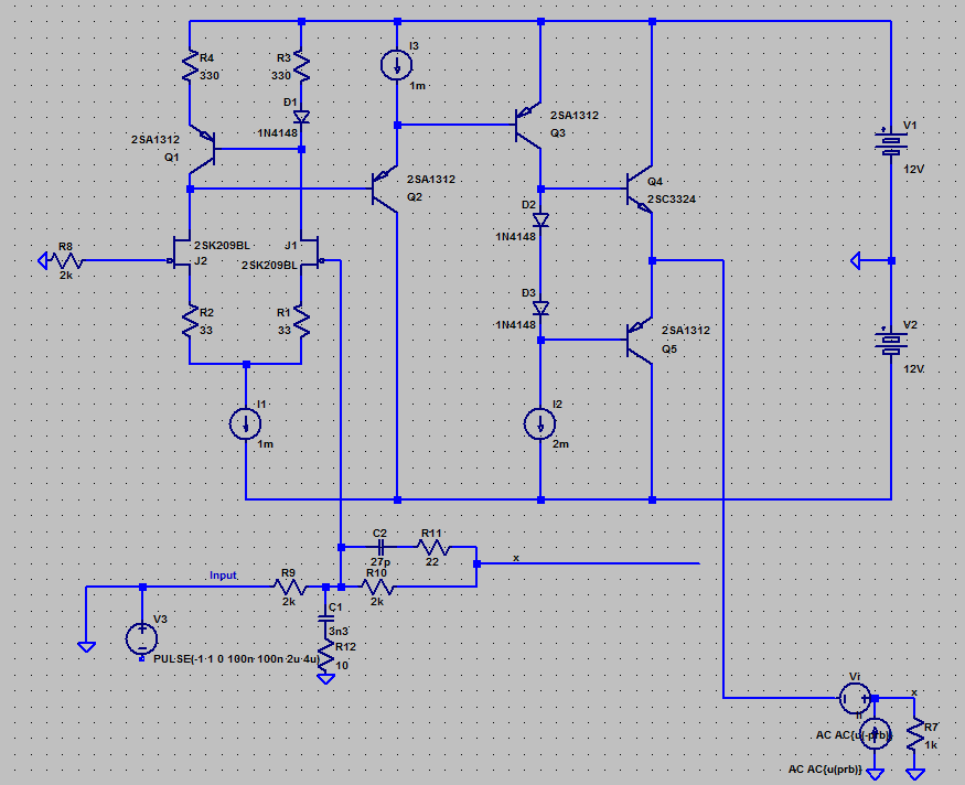

And unity gain stable without any caps ?
Show us then.
I succumbed to the heat a bit, but really in the framework of decency.
All external compensation.
Aperiodic step response with 100ns rise/fall times.

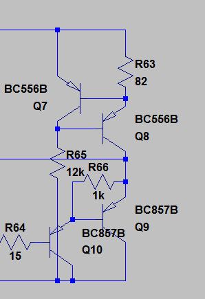

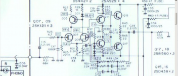

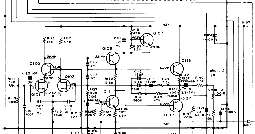

How would a discrete output stage be done?
I've attached a fragment from one of my LTspice sims. R64 comes from pin5 of AD744, the output (and feedback) comes from emitter of Q9.

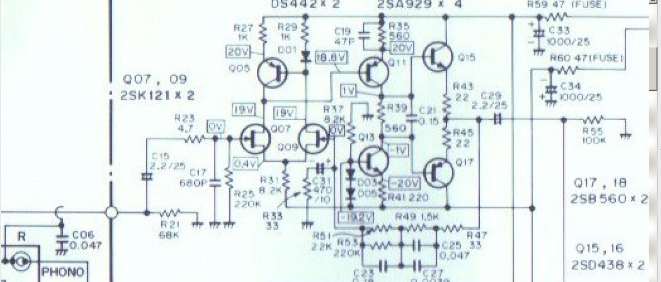

for example the Topping A30 has an LM337D2 going to the output RCA's. Would that be considered a discrete output?
Isn't LM337 an IC regulator? Not at all discrete.

What I'm trying to figure out is why would a regulator be placed on the output stage?
Assuming that we identified it correctly and it really was an LM337 then I think it could have been used as a current source to bias a single-ended classA output transistor.

I'd guess it's a mistake, Topping uses ICs for almost everything that I've ever seen.

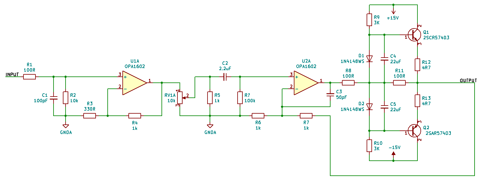

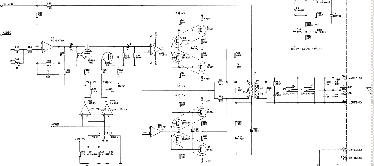

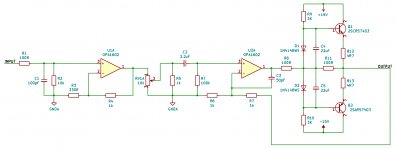

Boosting opamp power output is indeed possible. So called composite amplifier topology is very interesting.How would a discrete output stage be done? For example the Topping A30 has an LM337D2 going to the output RCA's. Would that be considered a discrete output?
Also, can an OPA627 with a BUF634 be replaced with an AD744 for better noise, distortion while still using a discrete output to drive big loads like 300 ohm easily? I've been thinking about paralleling 4 of them but it's not exactly cost effective.
Thanks guys
You can have a look at pages 62-66 in Op Amp Applications Handbook by Walt Jung. He describes this kind of circuits, even including usage of AD744 which you mentioned.
Today we have even better ICs suited for that role. BUF634A or LME49600 are high speed buffers designed to work inside of feedback loop of an opamp, boosting its current capabilties.
Also you can check my project incorporating OPA1602 and TPA6120A2 - LINK.
U2 can be replaced with discrete amplifier. I've played with circuit as in attachement but later decided to stick with ICs.
Discrete transistors means more parts, more complex PCB and higher costs. Here's another example - Class A output stage in feedback loop of LM4562.
Paralleling opamps is another viable approach. Schiit Magni Heresy or HPA part of RME ADI-2 DAC uses paralled OPA1688. Very popular O2 also uses paralled opamps at output stage. Composite amplifiers should yeld slightly better performance, but they are much harder to design however.
There is also very clever circuit by Shaq888 which uses both nested feedback and paralled opamps at output stage - "The Crocodile"
