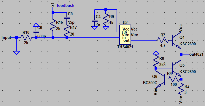

No, only the most hardest of the hard hardcore, THS4021, AD8067, LM7171, LT1222.You could probably go single EF after e.g. an OPA1656
There are no way to override their huge feedback depth while you are familiar with proper compensation techniques.
*attached*
200 mA @ +/-15 V would mean frying away a solid 6 W per channel
The winter wasn't cold this year, so, yes, we could talk about push-pull or even AB-output.
So by the time you decide to go with something BUF634-ish, you better know how to keep supply inductance down. Really, there are many different ways of tackling this particular problem.
Ok, EF-1 could be easily changed to BUF634 or even, with some tweaks, to LT1210. Supply rails could be decoupled with solid-polymer caps.

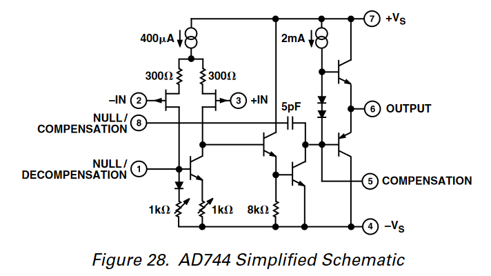

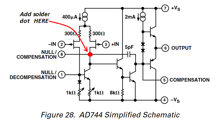

I'm fairly sure (Scott will confirm) that the schematic has an error. The pin8 connection should go to the right JFET drain and the 5pF. So to get unity gain stability another 5pF is placed in parallel with the internal 5pF. In short, there's a dot missing where the wires cross.
A "simplified schematic" can be mainly fiction - they have their intellectual property to protect, treat this as a rough guide to circuit topology only unless you have a set of die-photos at hand to check against...
Maybe Scott csn explain :
I do not quite understand how connecting pin 8 to pin 5 would make it unity gain stable.
Aren't the 2 pins already internally connected, as shown ?
Thx,
Patrick
Yes that error (don't know when it appeared) would not have been deliberate because the schematic is already very simplified. The data sheets were done back in the day with stick on symbols, tape, and stat text.

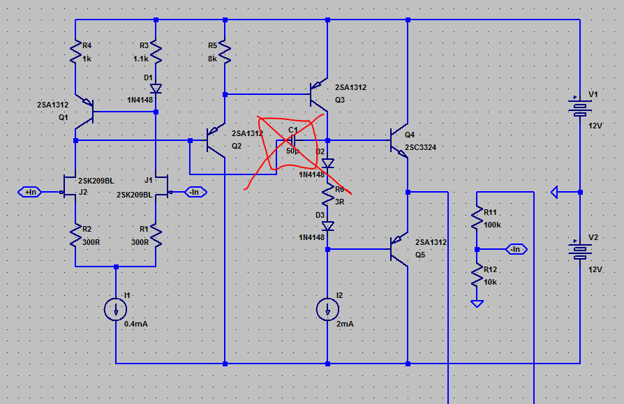

Just for fun
50 pf is a really good joke!
Let's compete?
The goal will be to remove that ugly cap and achieve as much loopgain as possible at 20 kHz while keeping amp schematic and biases.
Sorry, I don't get it.

And unity gain stable without any caps ?
Yes, let it be as challenge at unity gain stable and inverting connection!
No, not without any caps, but without any cap at the C1 position of yours schematic.
Only external circuitry relative to the shown opamp structure.
Just a simulator compete for curiosity how and how much...

Oh, yes, and let's add aperiodic step response at, say, 2 Volts input square wave.
PPS
Also i'ld set R1&R2 smaller, say 22 Ohm and R5 say 1k for making things even complicated.

An opamp which is "universally" applicable in a any existing circuits would not required external compensation.
No-no, nothing about "universally" applicable.

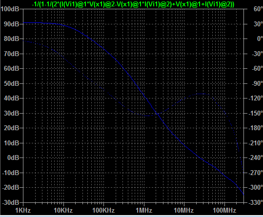

That's nonsense with something having at least 120 dB gain at 10 kHz.
This is really beast to be tamed anyway.
So, let's try? For curiosity, of course!
