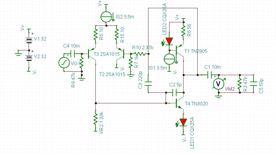

Without the buffer, performance is still good but it is sensitive to load impedance. I've juiced up the VAS and it's more happy that way. I was able to cut way back on the Miller capacitor. Bandwidth is good, with a nice smooth roll off at about 2MHz. Distortion is generally 0.0002->0.00038% depending on the frequency and load. I call this version 1.2, no buffer.

Your Miller cap is now the 220 + 5 pF. The schematic might make it appear as if it is the 5 pF, but note that with the loss of the buffer (which accounts for the sensitivity to loading) the two caps are now in parallel.

It looks like a buffer is a good idea regardless of how much I try to make this thing perform well.
Miller cap is now 47pF. Response rolls off nicely beyond 10MHz. It's still load sensitive. I wonder if Tina can figure out the output impedance for this circuit?

Oh, if I was designing this from scratch, it wouldn't look like this at all. I'm trying to optimize an existing circuit board that I have already purchased.
For example, I tried a current mirror as the active load for the LTP, and it made a huge difference in lowering distortion. But, adding something like that to these circuit boards is really hard, so I'm not planning on doing that. Trying to make something useful with these boards has been a real challenge. I might as well use another board I have that already has a buffer on it.

If I add a simple single ended MOSFET follower with constant current load, performance goes up dramatically. Here it's driving a 1k ohm load with 0.0003% distortion. I guess I can treat this thing more like a tube preamp with all single ended circuitry. One thing I learned is that adding a follower like this really increases the bandwidth and almost always introduces a RF resonance, so the feedback compensation has to be adjusted when I do that.
