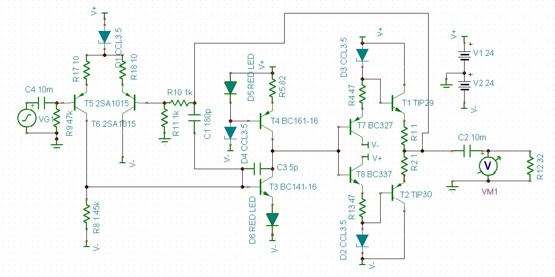

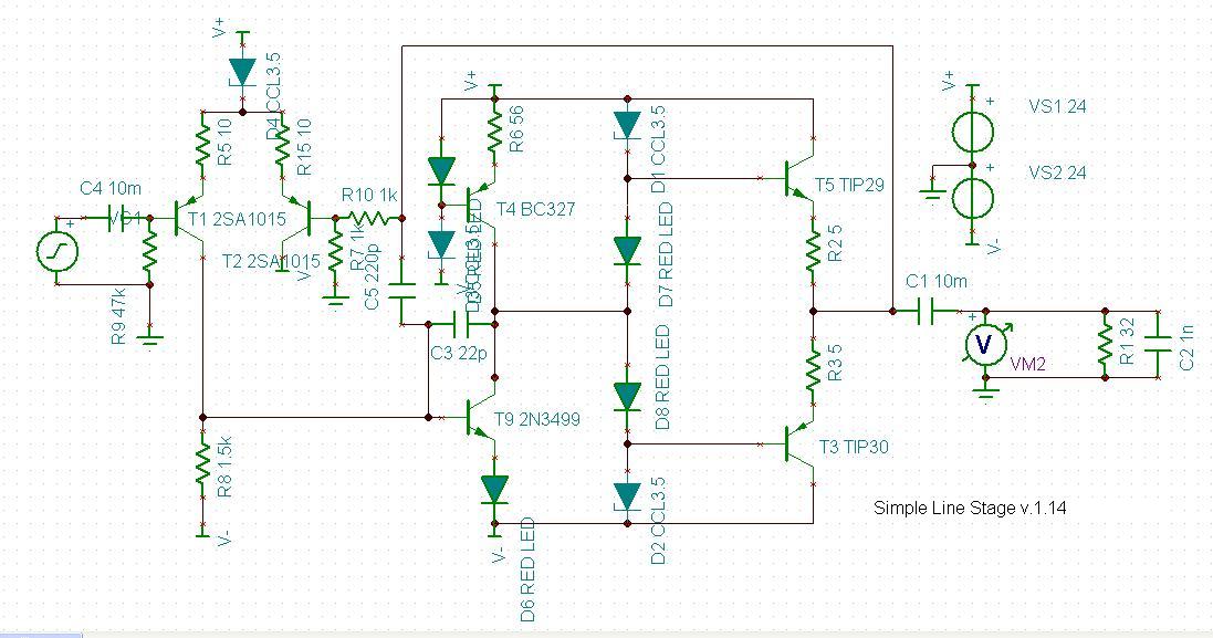

Now that the schematic is just about correct, start investigating what voltages exist around the circuit.
Start investigating what currents are flowing around the circuit.
Start understanding why the circuit works.
Remember I was trying to get you to investigate the voltages around the output stage loop.
Do that now for this latest schematic.
You will find an anomaly. The red LED voltages needs to be VERY low to get your circuit to bias properly.
I've been doing that all along, from the beginning. I just never thought to mention it to you. It's a normal part of designing the circuit.

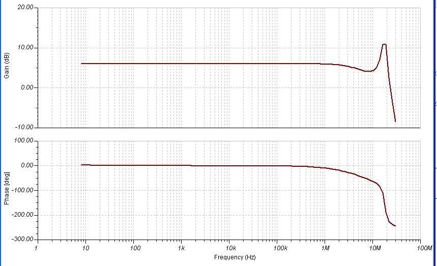

Dang Darlingtons! This often happens when I add them to a circuit. The resonance at about 19MHz is a pain in the neck. What suggestions can anyone make to damp this resonance (besides the Miller and feedback capacitors)? I suppose I could just ditch the darlingtons all together.

If you had been doing that, then you would have spotted the LED anomaly
Look, I'm trying to be polite to you, but you are really pushing me.

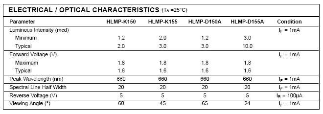

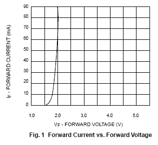

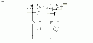

"But first it should be noted that LEDs are rated with a nominal forward voltage drop. If an LED is connect up such that it is emitting light, a multimeter can be used to measure a voltage drop across the LED. This voltage drop usually varies from 1.5V up to 5V, depending on the power output of the LED, and also the color. Low power LEDs tend to have low voltage drops, and high power LEDS have the higher voltage drops. Likewise blue or white LEDs tend have higher voltage drops, than red LEDs."
1.47V forward voltage is not outside the realm of normal for LEDs.

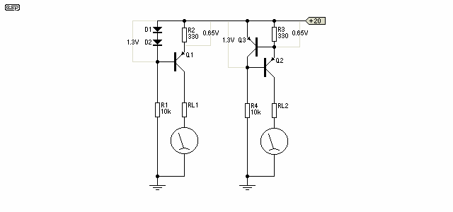

2.94V to bias on a pair of Darlingtons does not sound right.
2.4V to 2.5V is more the ballpark your Darlingtons should be near.
That would require 1.2Vf to 1.25Vf for the red LEDs.
Red LEDS normally have Vf from 1.5Vf to 1.9Vf.
You should be able to see that just by looking at the schematic.
If you can't "see" that, then ask the sim to tell you the voltages and currents around that output loop.
Get rid of the 220pF capacitor. Increase the 22pF capacitor if necessary. Maybe add base stopper resistors for the output devices.
That's the smart option if this is going to be a preamp. For a power amp, you won't have enough current gain without Darlingtons.

Also the temperature coefficient for the forward voltage of red LEDs is a reasonable match to one base-emitter forward voltage, not two. So you will still have a tendency to a large increase in output devices' quiescent current with temperature, both ambient and signal-induced. You'll be closer to stability with two standard (~1N4148) diodes in series in place of each LED.
Remember that where almost all Spice falls down terribly is accounting for temperature. With some sand-state devices this isn't as much of a fatal flaw as with others, but bipolars are very susceptible to fatal errors. That is why the counsel of emitter resistors is well-founded.
Brad
Brad
Tina has a temperature drift for DC analysis available. I tried it out. The voltage at the junction of the two final emitter resistors goes down with temperature, from about 1.7V to about 1.6V @ 100deg C. not sure where you want the DC drift with temperature measured.
Tina and all other simulators that I know of that have a temperature function account for ambient changes only. That's a start, but the more pernicious effects are due to signal-induced changes and orders of magnitude more difficult to model. There are many thermal time constants and thermal resistances for example, the chip, the chip to package, the package to ambient or heat dissipator...
But if your emitter resistors are large enough you can shrug most of this off.
Brad
The voltage between that junction and what? ground? That's just the DC offset.
...not sure where you want the DC drift with temperature measured.
The voltage between the emitters of the output transistors, or just measure the collector current of one of them. With emitter resistors it should be OK. Without them, there would be a problem, and it would be much worse if the transistors are heated up and the LEDs/diodes stay cool (as is likely in real life).
I think this one is pretty good. I gave up on those Darlingtons. The RF resonance issue is just too hard to fix. This one rolls off nice above 1MHz. Distortion into 32 ohms is something like 0.00015% at full output for headphones. Headroom is huge, with 0.001% distortion at over 8 volts rms output, 1kHz. Gain is 6dB out to 1MHz. This is in sim land though...

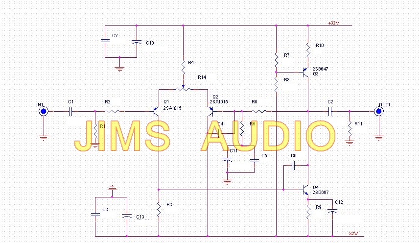

You have to realize that I am not designing this from scratch. I'm working from some circuit boards I got from Jim's Audio, as described at the beginning of this thread.
If I was building from scratch, I'd do something different.

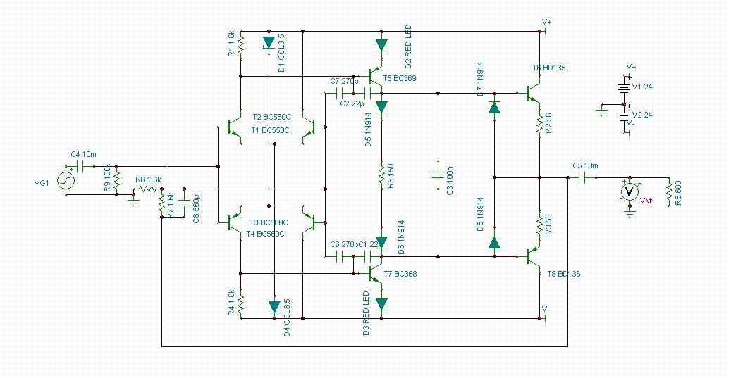

Well, this does perform very well. Something like 3.5x10^-5% distortion @ 1kHz into 600ohms. There's a nasty spike at 10MHz or so. I tried to tame it but don't really have an idea. It would most likely fit on a 1" square PCB. I don't understand the function of the 100nF capacitor, nor the 150ohm resistor between the two diodes. Also, I don't know the function of the last 2 diodes connected to the output transistors, but I was able to figure out that the input is just two LTP's of opposite polarity. I think this is to reduce even order distortion?
I continue to mess around with this one. I removed some of the capacitors and reduced the Miller capacitor and the distortion is even lower but the resonance at 40MHz or so is still there.
