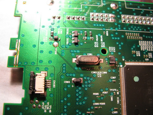

CD-rom
Anyone tried this in a CD-Rom?
i have a Plextor PX-712A used as transport and i really like it
have used different PS for it and have long time ago scrapped the SMPS and use aether batteries or a LM317 PS. (one for each voltage)
Under is a pic of the crystal, wold be fun to tweak this further
Any thoughts ?
Any thoughts ?
