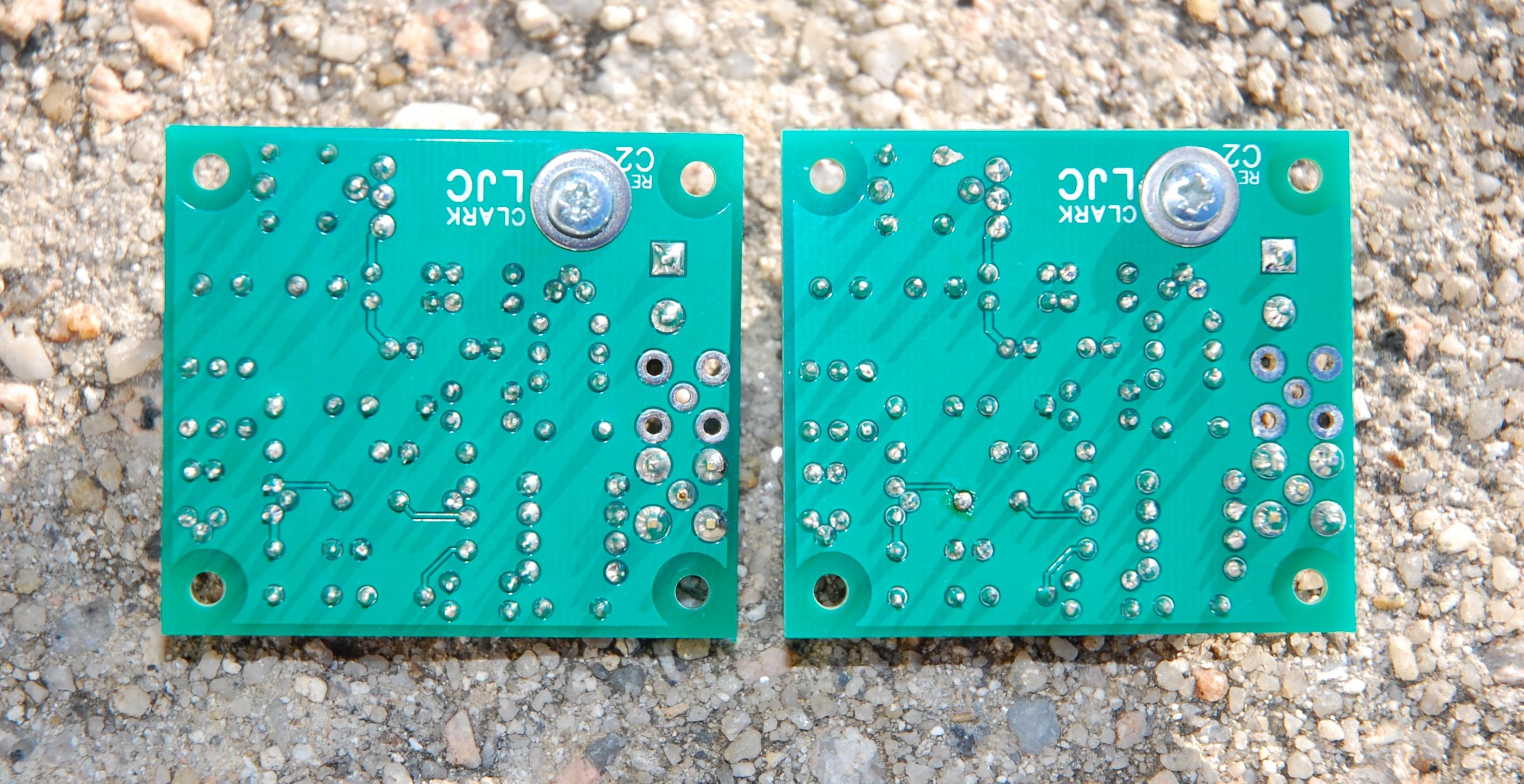

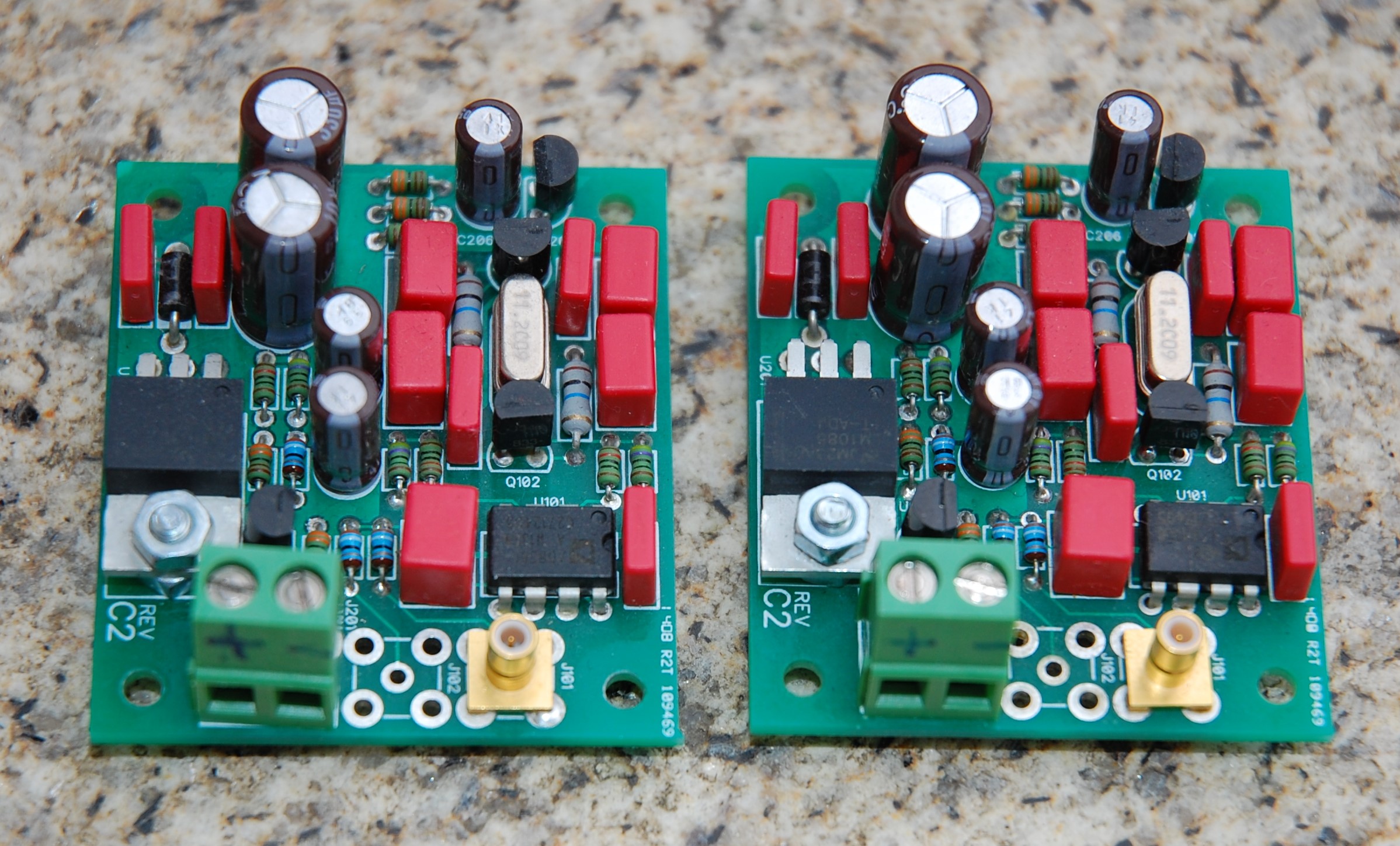

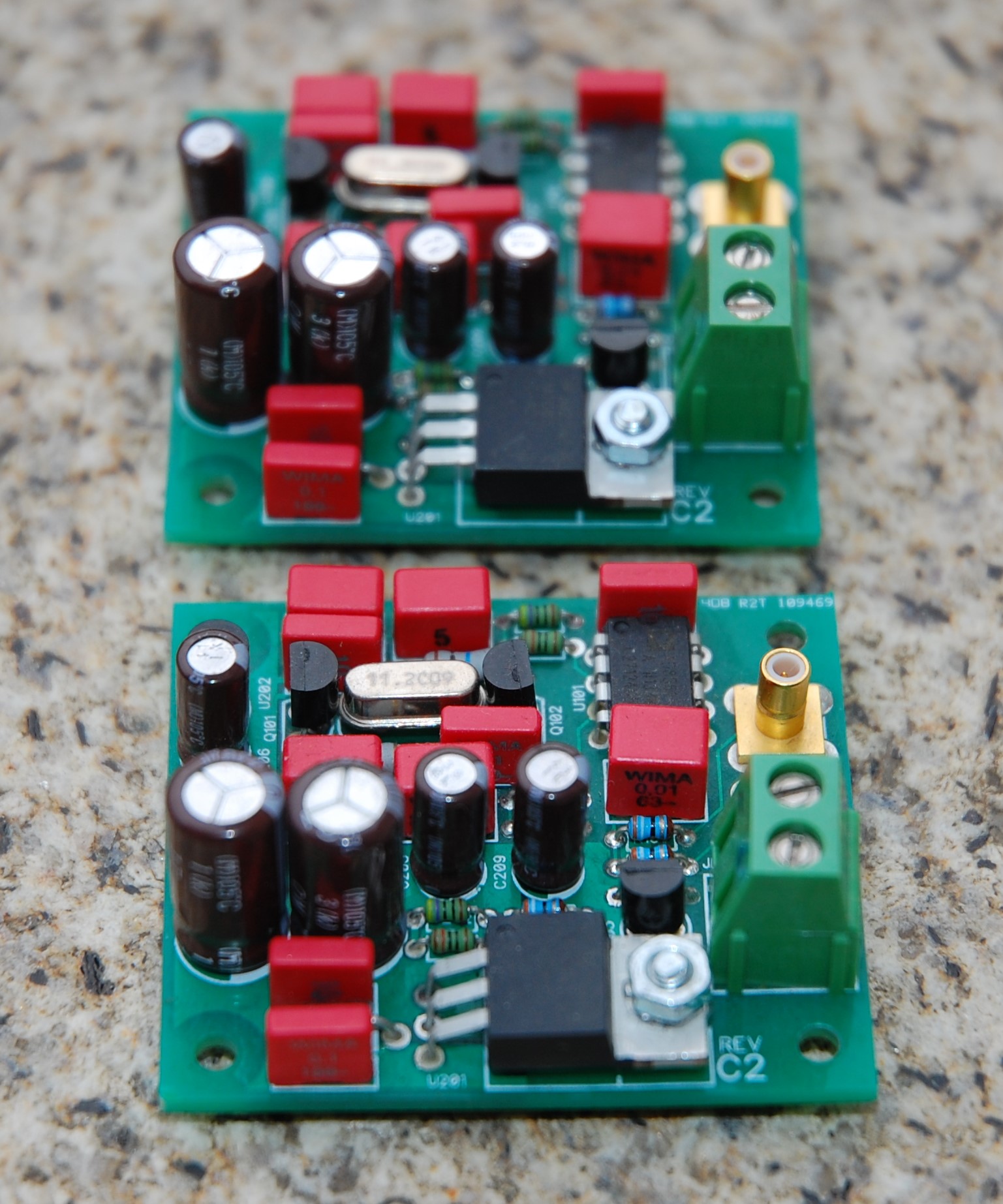

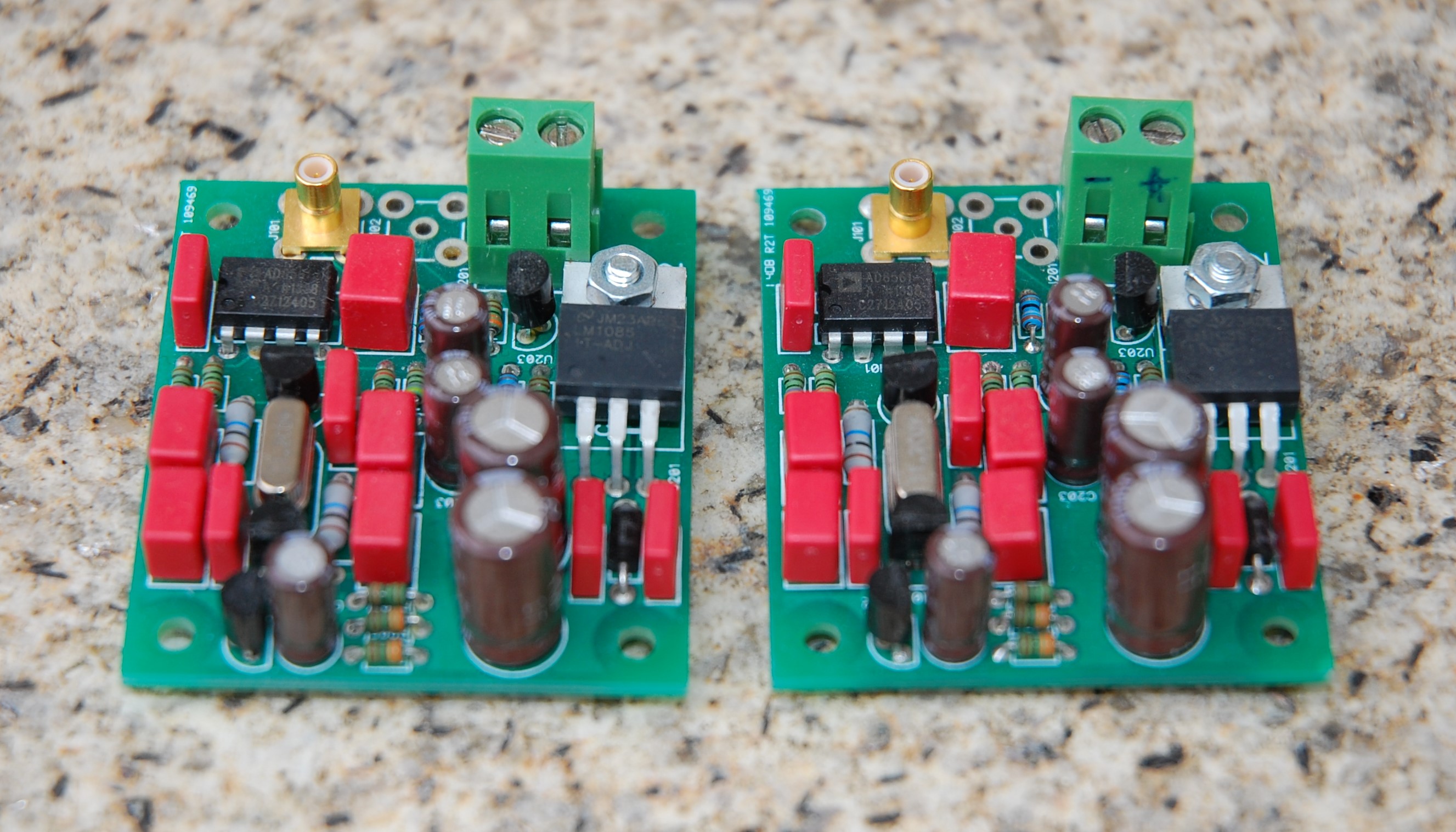

You must remove the flat washers from underneath the heads of the regulator mounting screws. With it assembled like that you'll probably short the regulator's output to ground.
