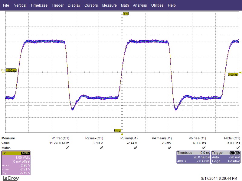

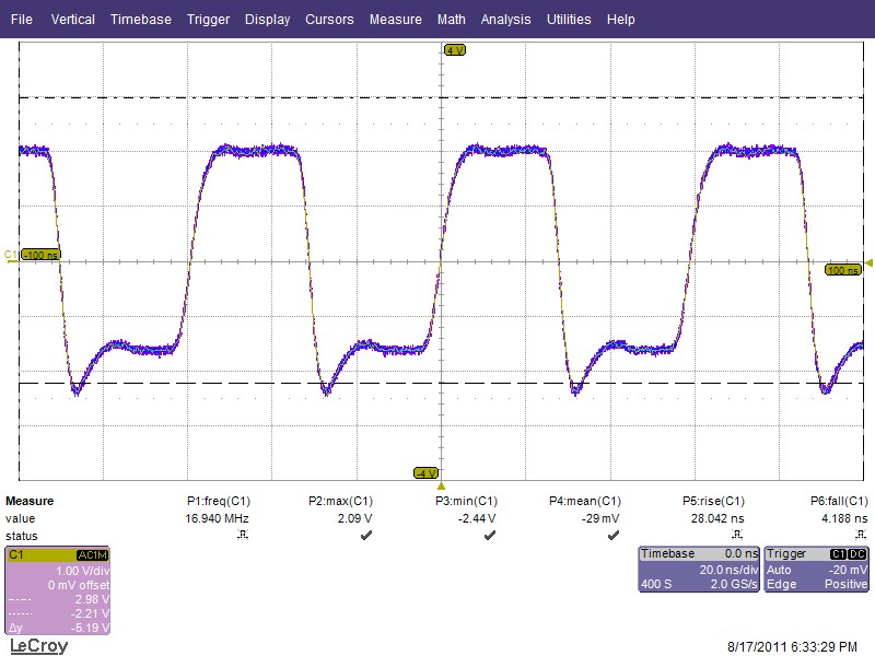

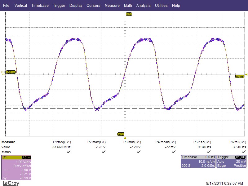

Hi Anton, I've build your clock, tested voltage on pin 1 of IC, but still figuring out how to connect the signal to the CD-72. I've tried signal on Xin and ground via R on Xout, or on full ground, but in both cases motor keeps spinning ....... , I guess because signal is not properly received. Any tips how I should connect properly?

This is quite a robust design, and as long as it's been assembled reasonably well it should work. The first thing you should do when troubleshooting is to check the clock's output with an oscilloscope. Without one you're really flying blind. Without a 'scope, it'll be difficult to tell whether there's a problem with the clock itself, or a problem with the way it is installed.
Some of you don't have a 'scope, and while I think it is something that is a necessity for this type of work, I can help you out. You can send completed clocks back for me to test, and possibly fix. At least this way you'll know wgat the issue is.
Anton

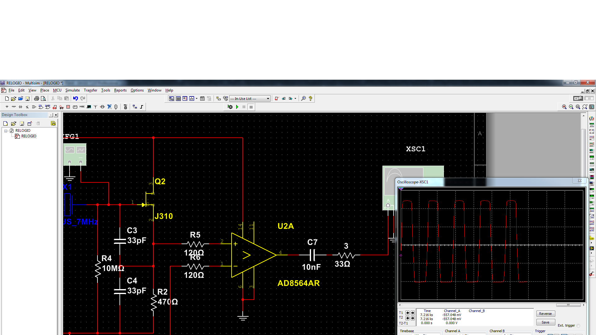

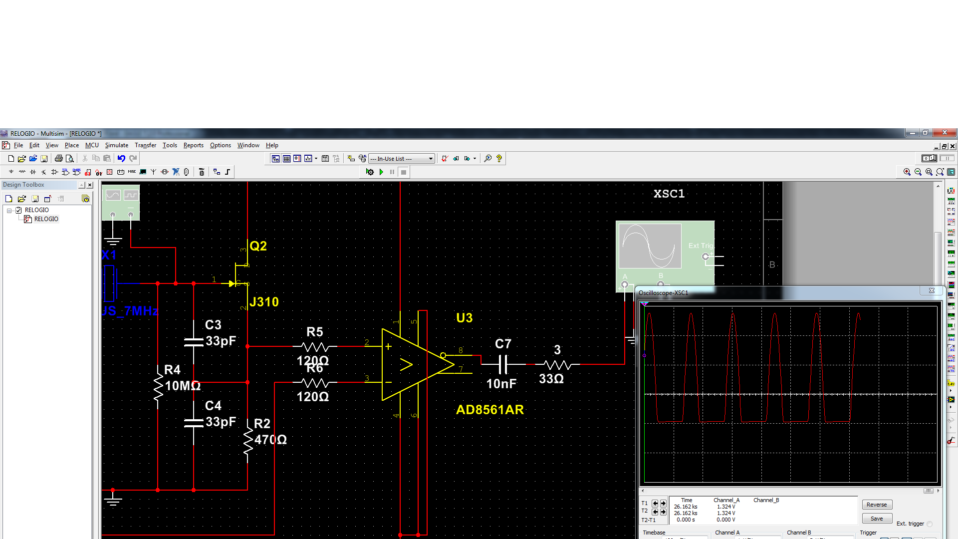

don't trust simulations of oscillators, unless you did them a lot of times and know how to do them.
Let it oscillate for a while, check the output after t=1s, 5s etc, see whether it gets more symmetrical.

On that note: looking at the measurement graphs of the clock output (post #3), I am afraid there is an evil at work here.
Something's not right.... send me an email.
