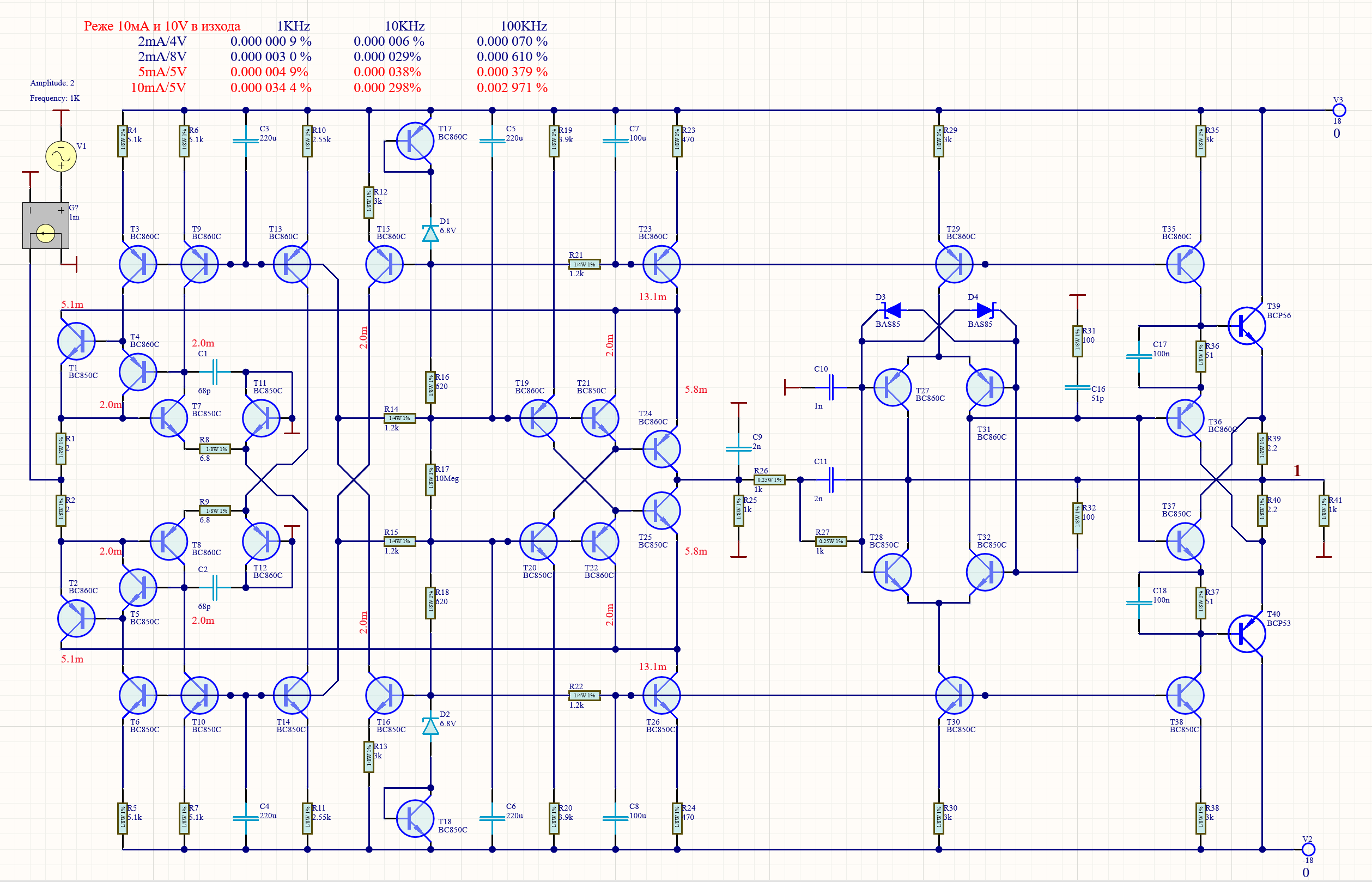

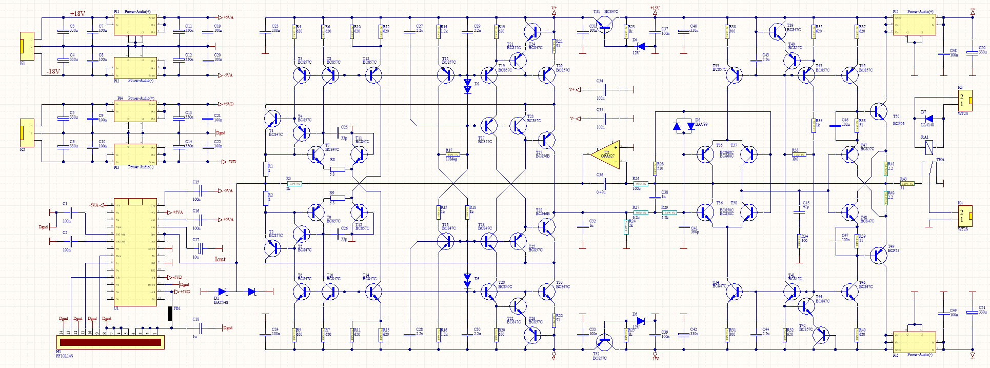

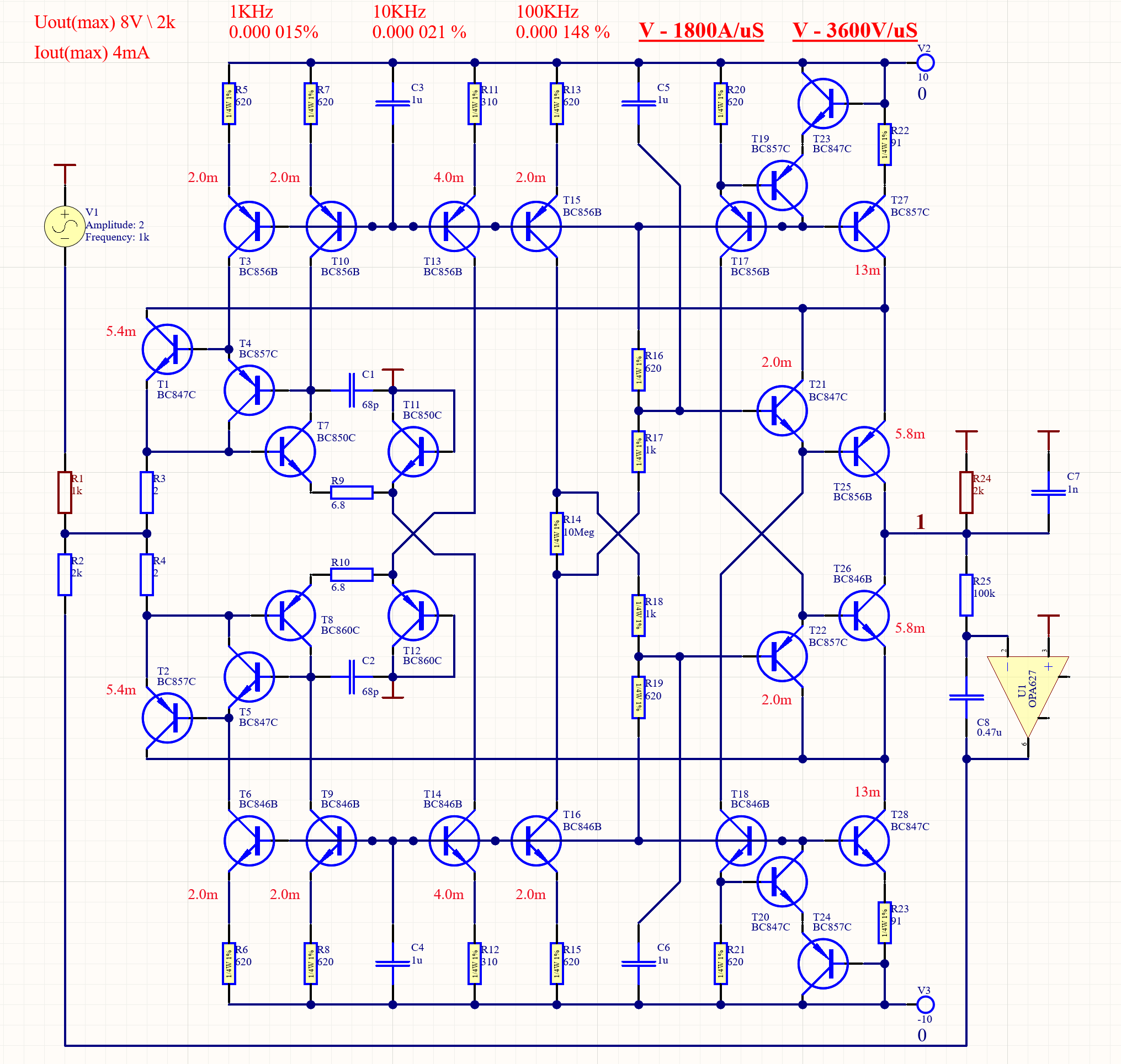

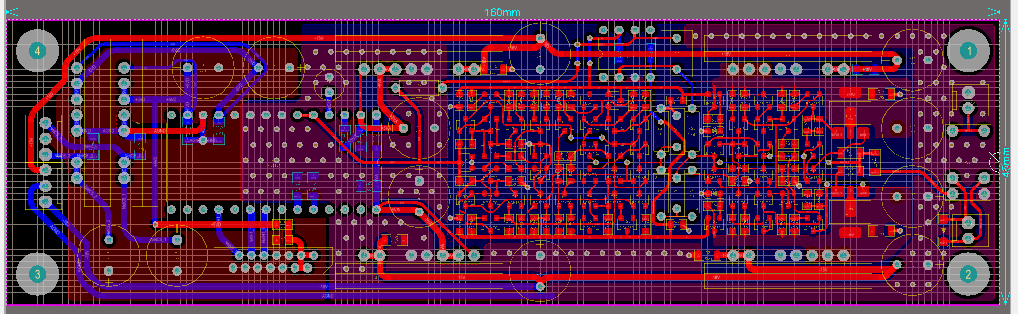

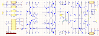

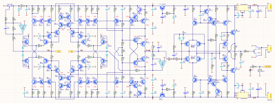

Discrete I-V converter
The first is an old project.
Simulation is on improved designs with reduced noises.

those values of distortion are only reached in a simulation with identical values of each transistor pair. Maybe a monte-carlo analysis should be done even when it takes a long time to simulate.
You also have to have a proper model of your DAC working into your input impedance, that is where most problems will arise.
I think 2 good opamps and a modern differential output DAC will give you much better results.
