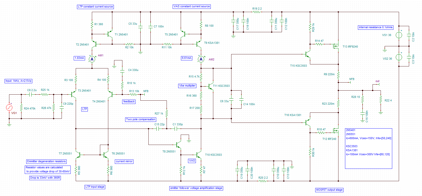

Should be close to 21 volt RMS
So pretty much 100 /110 watts.
for the most part, it is simple VAS
no beta enhancement, so little more load on the FET.
then yes VAS is also driving more load without power transistor drivers.
But Mosfet very easy to drive. So can be done with mosfet.
BJT it would be impossible to drive directly from Vas.
If you removed bootstrap current source
2nd harmonic would still be high. just slightly less.
But yes VAS is class A so you get 2nd harmonic.
and simple bootstrap current source will get little more.
lower THD would use the usual approach.
Beta enhancement and even cascode for VAS
That is common approach to remove 2nd harmonic distortion.
which is most of the % rating.
And then to reduce the load on the Vas then you use driver
transistors for outputs and THD drop further.

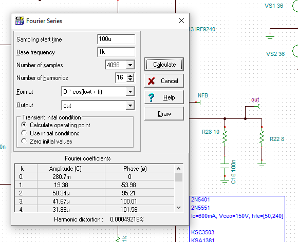

you would loose all the second
harmonic and have typical 3rd harmonic and odd ordered
harmonics phase would change.
this amp
upper harmonics are about same level as .001% amplifier
but the strong 2nd makes the amp measure around .05%
and phase of uppers is different than typical solid state.
even if input Fet changed to BJT THD be about same.
Maybe .01 %
Fet might contribute a little because they cant drive loads as well.
So the higher load T6 1381 gives the Fets a little workout.
But 1381 has pretty good gain and easier to drive.
If it was a BD139 or MJE243 likely would get little more 2nd
harmonic

I want to build this and give it a listen 🙌
After I build that voltage follower
And many others things in the queue lol

Circuit design easy for me.
Board design I can do but very slow, lol.
So if you good at board design, projects move pretty quick.
BJT Quasi output also good way to get 2nd harmonic.
And also same trick. Use Simple Vas has high 2nd.
Can also do simple darlington transistor output.
Or big T03 metal can outputs, that nobody likes...oh well.
No need to overbias class A/B and call it something else.
it does nothing. well actually it does.
It makes the 3rd rise. 2nd all Vas
