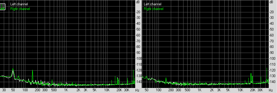

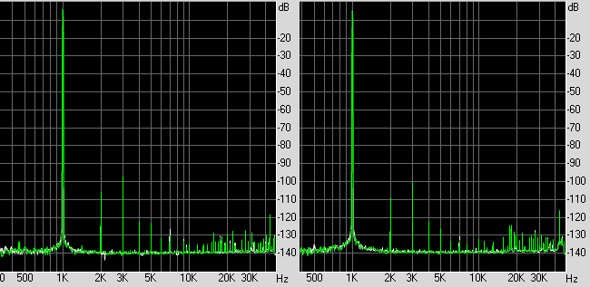

Funny amp, it behaves real bad at lower supply. There's a sharp cutoff somewhere just below 9V where the distortion starts to rise dramatically. This only happens in real life, not in LTSpice.
The real AD797 is spec'd for > 10V supply, and I've just run it in RMAA and it behaves exactly the same. The distortion goes wild below 9V. No wonder it doesn't sound good from the supply of a single 8.4V battery.

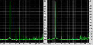

The schematic is basically the same as in post 1 except for the bias to the output transistors. It's now 15 mA instead of 30. The current through J3 is 2 mA, not 4 as stated in the schematic.
At 18V supply it drives 10R load quite all right. 1 kHz 1 V output.
