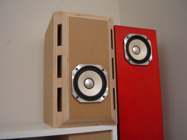

Thankyou for all of the constructive input so far! The consensus seems to be that, as I feared, the design is fundamentally flawed, particularly concerning the port (its size, shape, placement, etc.).
The easiest thing I can do is simply block the port at the internal opening (with polyfill, wood, concrete, whatever) which will give me a ~2.8l sealed box which will be very similar to Vikash's as linked earlier. But can anybody comment on the WinISD graph I posted of such a cabinet? From my limited knowledge it looks dreadful?

26cm is the entire distance along the centre of the port including the fold.Bjohannesen said:Hi Lost Eden, the 26 lenth of the port, is that including the fold
Internal dimensions are 108mm tall & 170mm wide. Depth is 148mm at the bottom, 175mm at the top. Total volume is 2.95l minus the volume of the driver/wires/connectors so I estimate 2.8l useful volume.Bjohannesen said:What is the hight and depth of the box the port not includet?

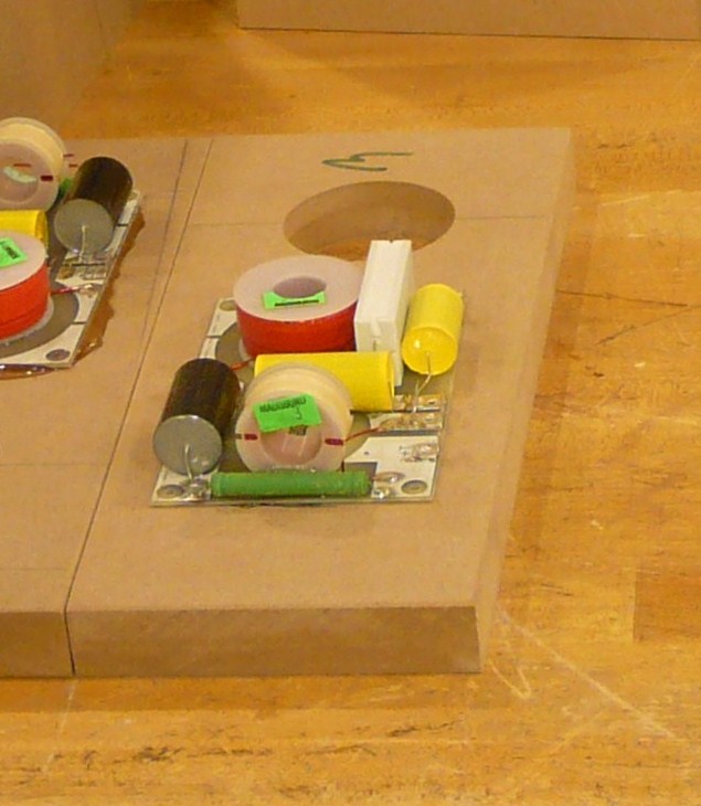

that hds, I'm having trouble with seeing the x-over.
Is it a single cap on the tweet ?
or is it simple 6db crossover ? If so, i'd imagine the vocals are good.
Norman
Norman
I bet somebody could read this better than me, but I think that coil is across the tweeter. It's a sweet deal: ring tweeter, 2 woofers and crossover, $132.

Even though it is not much, but Im a bit usure about your dimensions.... Cabinets are 2.7l, 2x slot ports 78x15mm & 26cm long. ...
Have you measured the port lenght in the middle of the port channel?
In the pictures it looks shorter!?
As said the port resonance is quite heavy. A smaller shorter port would be better.
Also the resonace in the enclosure is a problem with the big port.
Can you change the crossover frequency for the sub easy (activ)?
For an easy testing without modifying the enclosure I would stuff the enclosure AND port with polyfill (sonofil ...) to get a (almost) closed box (The W3-926Sd should be quite ok in a ~3l box).
So you can hear the speaker without the resonaces of/through the port.

Hi Lost Eden, I have run some simulations of your cabinet.
The tuning is about 85 Hz, but with an unwanted peak and drop at about 600 Hz. However, it should play all right.
You need stuffing in the "chamber" not in the port. Use 0.094 lb, which is a rather hard damping. The bass is good, for this driver and the small cabinet. However, you will have to live wih the peak / drop. I am not sure you would hear it playing music.
Please find more details in the document attached.
