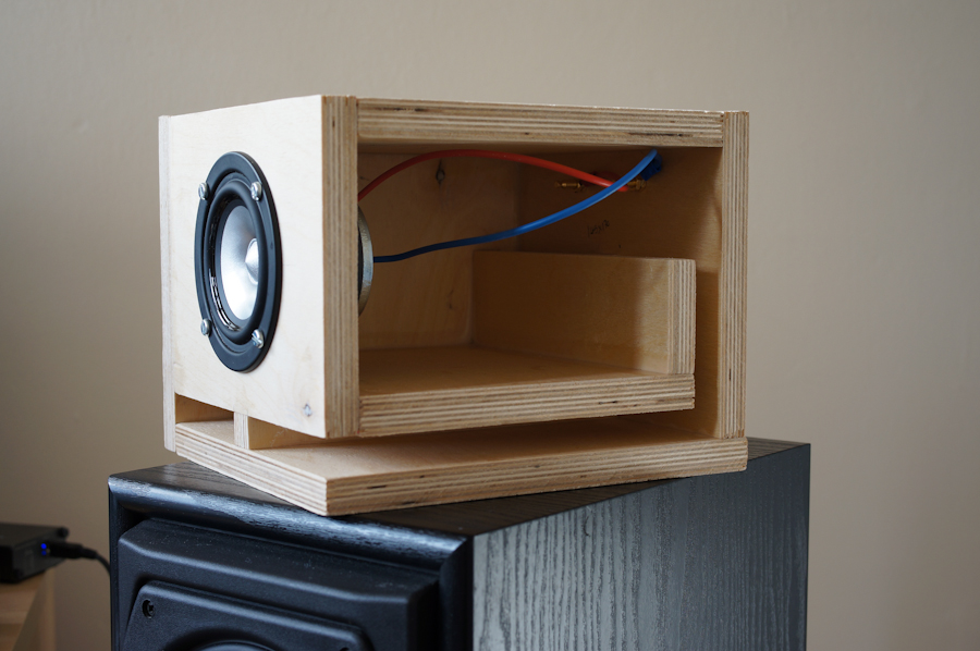

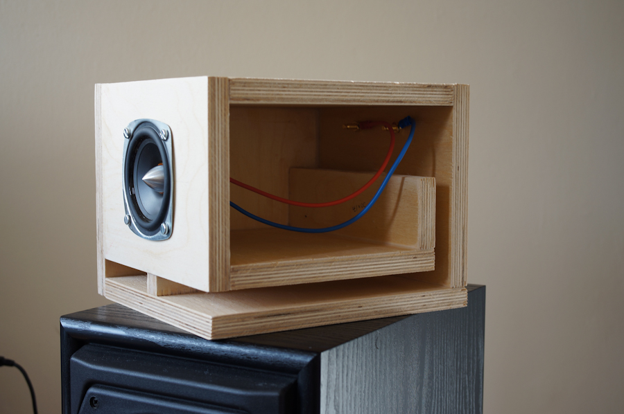

Disappointing first build w/ W3-871C W3-926SD
Thankyou for all of the constructive input so far! The consensus seems to be that, as I feared, the design is fundamentally flawed, particularly concerning the port (its size, shape, placement, etc.).

i think the driver with the phase plug not sited properly...
It isn't mounted flush yet because I wanted to test with both different drivers I have & the others don't mount the same. I will flush mount them at some point (if it's worth pursuing these boxes!).
Bjohannesen said:
Hi Lost Eden, the 26 lenth of the port, is that including the fold
26cm is the entire distance along the centre of the port including the fold.
Bjohannesen said:
What is the hight and depth of the box the port not includet?
Internal dimensions are 108mm tall & 170mm wide. Depth is 148mm at the bottom, 175mm at the top. Total volume is 2.95l minus the volume of the driver/wires/connectors so I estimate 2.8l useful volume.

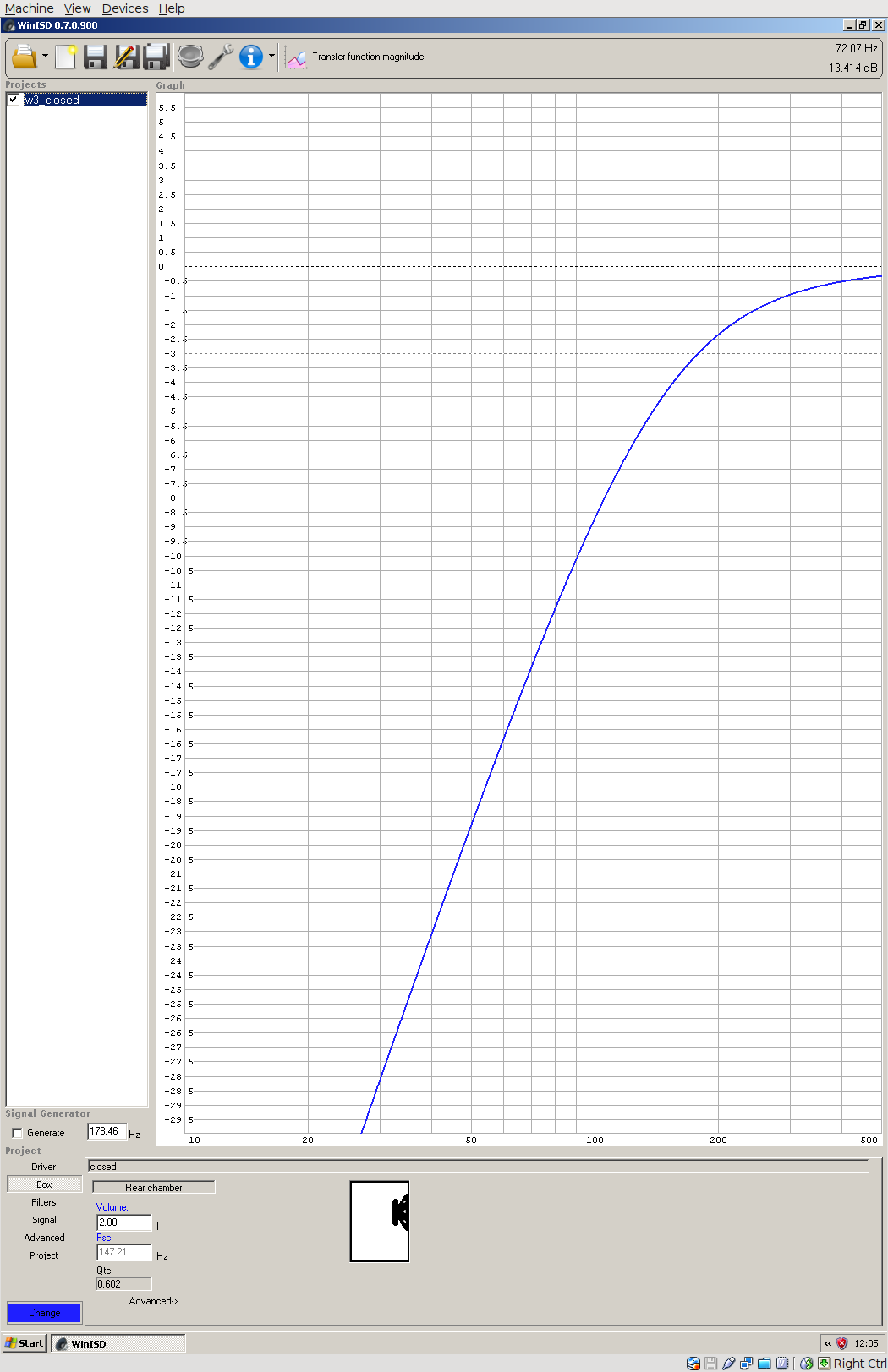

The easiest thing I can do is simply block the port at the internal opening (with polyfill, wood, concrete, whatever) which will give me a ~2.8l sealed box which will be very similar to Vikash's as linked earlier. But can anybody comment on the WinISD graph I posted of such a cabinet? From my limited knowledge it looks dreadful?

They do sound a lot better with the ports closed & a decent amount of padding inside. Still not amazing, but certainly good enough that I'm not going to use them as firewood! They are a bit too forward/fatiguing which is the same as Vikash found (not surprising as my cabinets closely resemble his now) which he addressed with a filter, so I may look into that.
I'll probably wait until the weekend to properly modify the boxes - block the ports with mdf, chamfer the inside of the mount, flush mount the driver. Then I can do some more 'scientific' tests with a tone generator (I use ecasound) & whatnot.

... Cabinets are 2.7l, 2x slot ports 78x15mm & 26cm long. ...
Even though it is not much, but Im a bit usure about your dimensions.
Have you measured the port lenght in the middle of the port channel?
In the pictures it looks shorter!?
As said the port resonance is quite heavy. A smaller shorter port would be better.
Also the resonace in the enclosure is a problem with the big port.
Can you change the crossover frequency for the sub easy (activ)?
For an easy testing without modifying the enclosure I would stuff the enclosure AND port with polyfill (sonofil ...) to get a (almost) closed box (The W3-926Sd should be quite ok in a ~3l box).
So you can hear the speaker without the resonaces of/through the port.
If your box is not in a bookshelf you also need a BSC/notch.
(With one notch in "simulation" I got 1,5mH|2,2uF|5,6Ohm)
Andreas
Hi Lost Eden, I have run some simulations of your cabinet.
The tuning is about 85 Hz, but with an unwanted peak and drop at about 600 Hz. However, it should play all right.
You need stuffing in the "chamber" not in the port. Use 0.094 lb, which is a rather hard damping. The bass is good, for this driver and the small cabinet. However, you will have to live wih the peak / drop. I am not sure you would hear it playing music.
Please find more details in the document attached.
