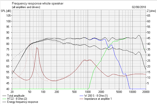

I set up an adequate 30L closed box 8" in the regular way. The dotted line. Then took it down to a mere 12L. That had a horrible 2dB bump at 100Hz.

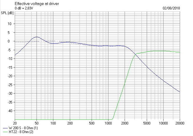

Then apply the magic 450uF capacitor, and it looks a lot better which is the diagram. In fact, above 50Hz, it works better on flatness. One for the repertoire. Because I have some old undersized speakers that have defeated me for years.
Second image is electrical response, if you want to see what it does. Nice. 😎

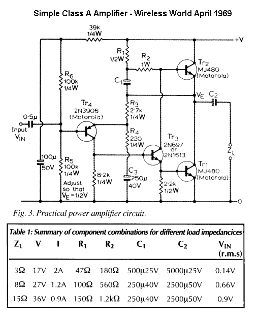

I was looking at alayn91's notion that single rail amplifiers might be deliberately exploiting this principle. It seems not. The output capacitors that I examined were much larger.
Below the 1969 John Linsley-Hood Class A amplifier. A design that is a bit of a classic. Polar electrolytics work very well when biased strongly, though people often recommend a parallel MKT bypass for the higher frequencies too. It inspired Nelson Pass and friends into some very surprising designs like the light-bulb amplifier, which doubtless needs a decoupling capacitor too.
The Class-A Amplifier Site
PassDiy
It's useful to know a bit about amplifiers, at least why they prefer flat and defined impedance, even if the feedback theory misleads you into thinking it shouldn't matter.
