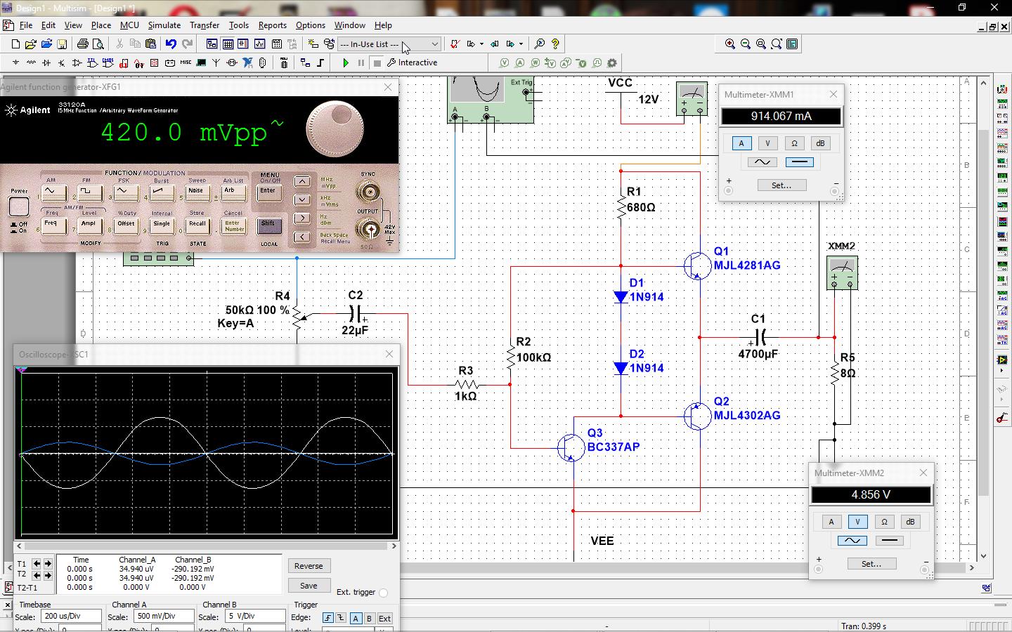

I changed the circuit somewhat so we get with and input voltage of 430mv P-P and output swing of almost 5 Volts RMS into 8 Ohms.. Blue Line input White Line Output
Please note I took some other transistor in my Simulation Program, because 2SC5200 is not found in Multisim 14. So I took MJL4281 and MJL4302 which are very close to 2SC5200 and 2SA1943
I also give it a Negative RAIL VOLTAGE /12 Volts *VEE* then we can operate it without output Cap or with Output cap as well..
Yes the second one looks better to me too..
check out the pictures.. Wave isn't fascinating a beauty, but with some time on the hands and the will to change there could done many things..

But not the first schematics, second one in first post, the one showing feedback. That looks better and should eliminate some nasty crossover distortion.

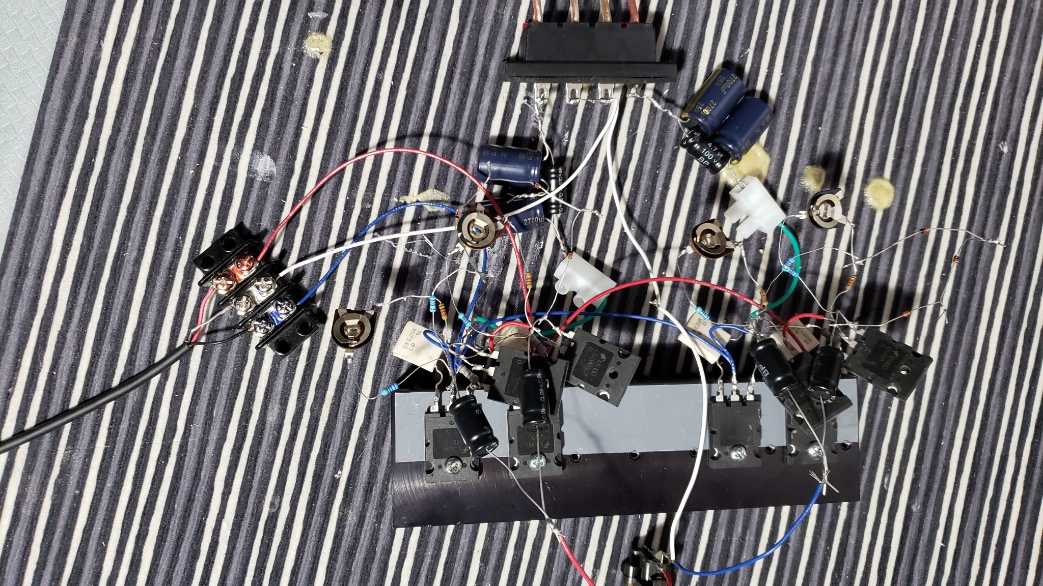

I built the second schematics. I used bc550 for input bjt. I flipped polarity of output cap, because there is ~2 volts negative where the 10 ohm resistors join. Input cap is ok, because base of first bjt is negative due to those two 4k7 series resistors.
Now, the fun part, at low level it actually sounds rather good. It can fill the room easily with pleasant sound, what a surprise. If i push it, it distorts, off course.
My guess first bjt is overloaded. I do not understand why input base needs to be tied to negative rail.
I may measure it later. Maybe even mod it.

Just lowered the 10 ohm resistors to 2 ohm, much better. I can play it louder with less distortion.

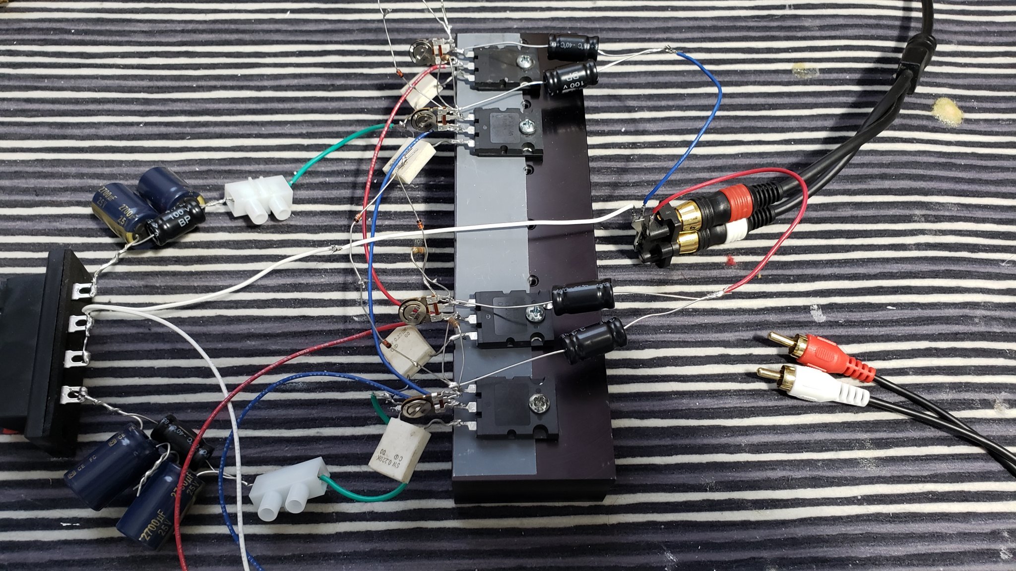

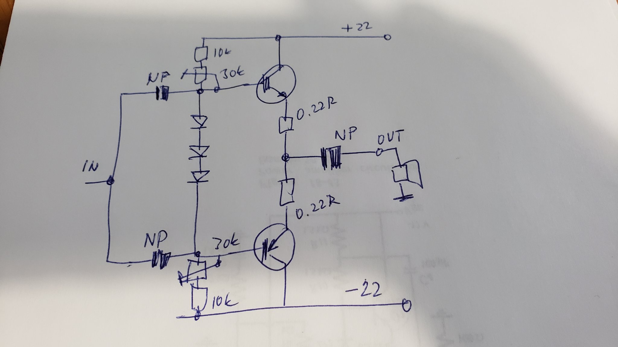

Here is what i did. I abandoned the input transistor, as i believe its a messed up design, and used only the output stage.
Then i modified bias adjustment, separate for negative and positive rail. I used 10k as satety, and 30k trimmer for adjustment.
Then i used 0.22 ohm emitter resistors to easily monitor the current.
I used bipolar cap on input and output as i did not want to bother with polarity.
Here is test circuit.
I used standard fw power supply, +/_22 volts. I used variac, and tested all with lower volts first. I could use bigger supply, these transistors can handle up to +/_80 volts, but why.
This is just for fun.

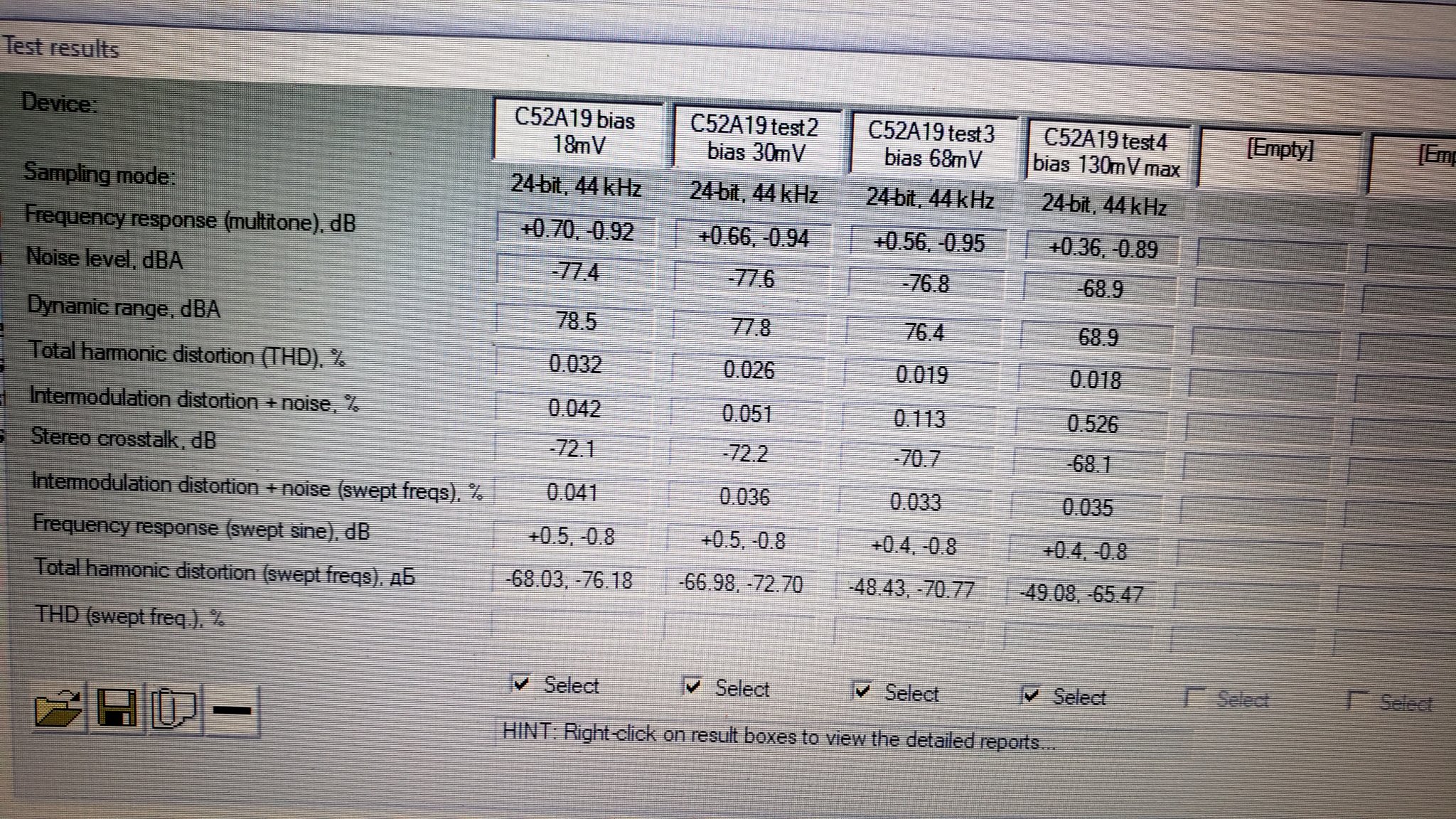

With 30k trimmers i adjusted bias, started with lowest, trimmer at max resistance, and to highest current with trimmer at 0 ohm. 10k ohm is still limiting as high as it could go. Plus i have small heatsink.
Four measurements were done, at moderate sound level, with speakers plugged in. About 0.5 watt as i do not like it too loud.
Measuring voltage dropped on 0.22 ohm resistors, i ended up with theses currents in the stage: 0.086A, 0.136A, 0.309A and 0.591A.
Here are the distortions measured.
Obviously distortion is going down as current through output stage increases. But intermodulation distortion is creeping up.

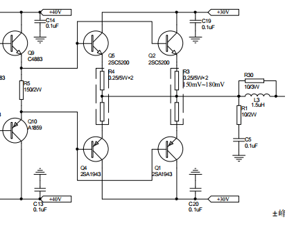

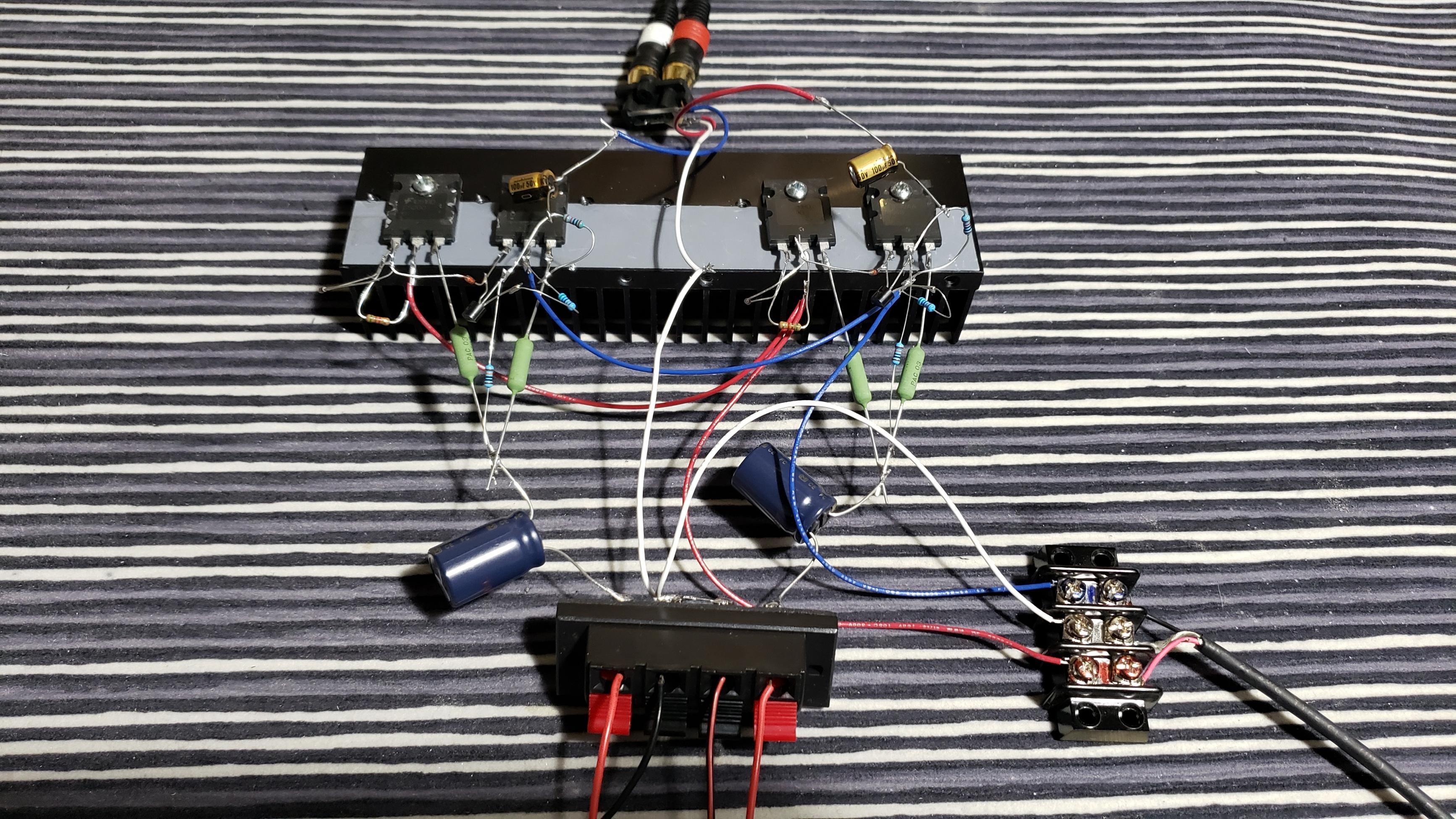

Some update. As ZM had in another thread poignant remark that my focusrite can not provide enough current to drive outputs, i made some mods.
I coppied unabashedly output from fm acoustics power amp, where they use c5200 to drive c5200...long story short, it works.
Here is the pic. More later.
Now this is going to be serious classA buffer with no negative feedback. I need bigger heatsink.

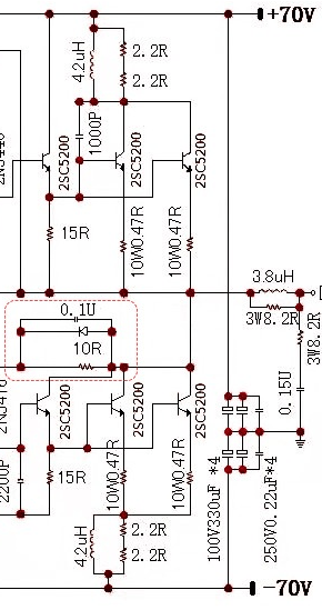

Well, if you connect diodes the proper way, add a-12V rail, or even better a +/-22V supply, tweak the driver, then results wi9ll be better .... but what relation does it have with the original circuit?
The one which had 1.5 Million views and > 20000 likes 2 Months ago?
THAT is the famous one, followed by Millions, and works as bad (horrible) as the first day.
This reminds me or the famous George Washington axe which is being carefully preserved in a Museum.
"Kids (said the Guide), this is the ORIGINAL George Washington axe. ...... SO important that we regularly do preventive maintenance ... the head has been replaced 5 times, and the handle 9 times ,,,, but it´s the original because we never fully replaced it by another"
Same here ...all that was kept was the power transistor pair ... which was grossly overspec´d from the beginning 😉 .
By the way, It DOES work (sort of) in the original diode configuration. 😱

No relation to original circuit. That is bs.
No need for original diodes. Just like most real amp do not need them.
Well, to tell the truth, I think the original transistors can deliver few hundred watts. But not the crap you linked to.
